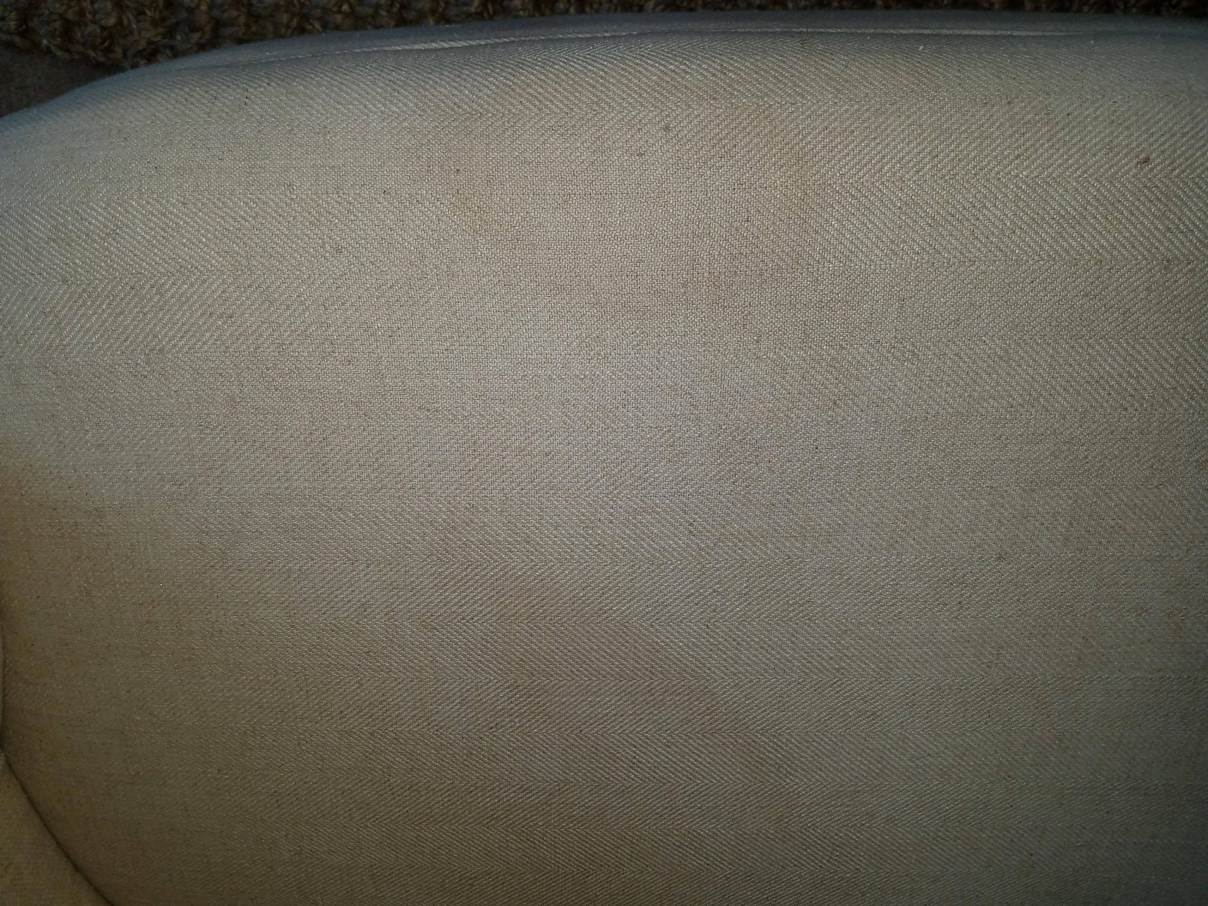

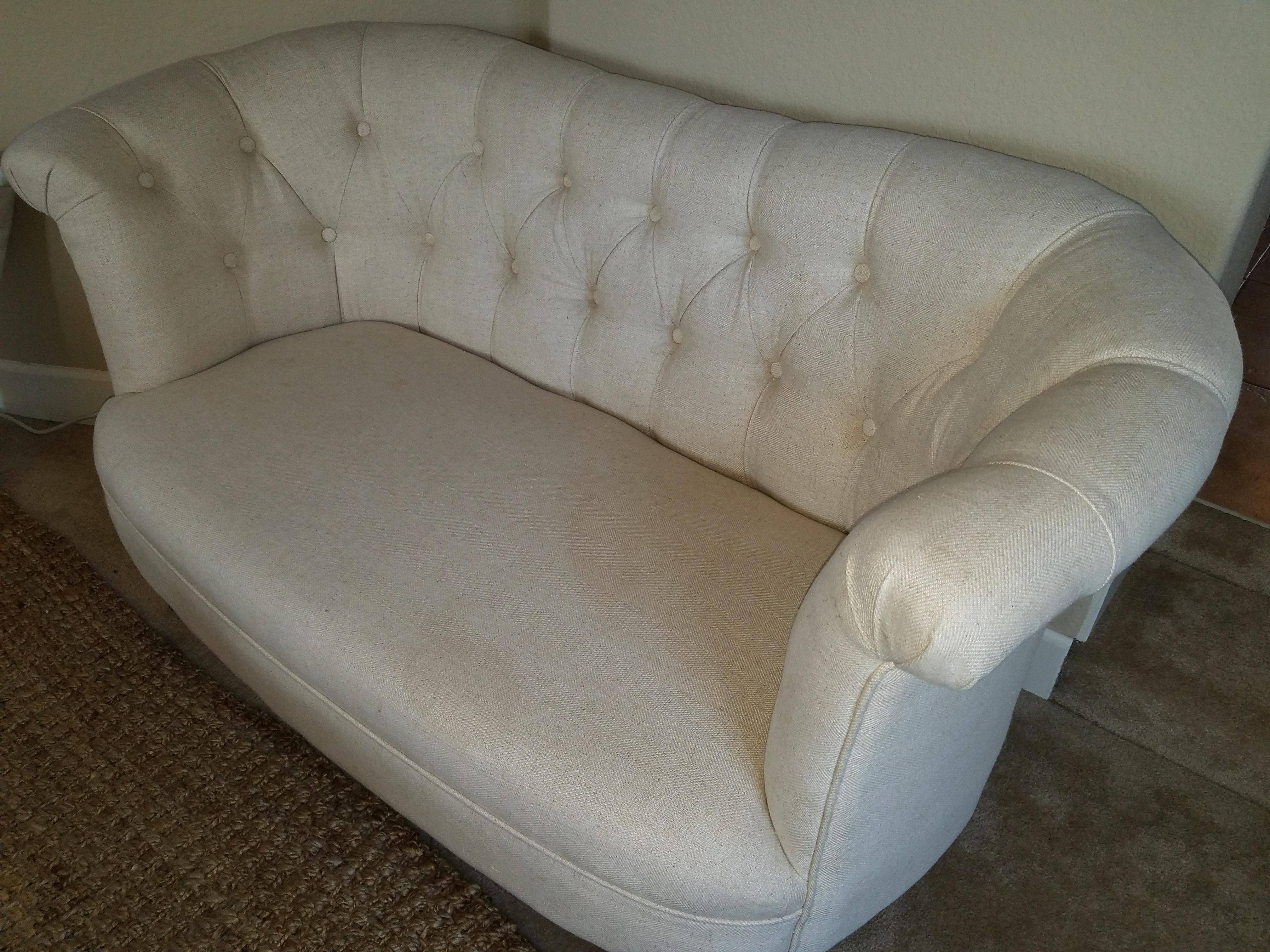

Worked on this today. About 2 years ago, customer had a party and guest spilled on it. They attempted to clean this with either windex or resolved.. I told custy that it might not come out at all, considering the fiber may have been damaged, and permanent change of appearance.
I vacuumed it, then proceeded mist distilled water and extracted with distilled water to remove any possible residue.. still there.
Used bone dry, agitated it with op cotton pad, and extracted with all fiber rinse hoping citric acid would help...no go. I even forced dry it.
Used %3 peroxide allowed to dry while i work on rug and a large sectional. Still there.
Tested a small part of it with cotton swab to see if worth the effort. Nope.
Only thing I havnt tried is a reducer, wool red relief. Should I do that when I go back tomorrow? Or should I stop?

Rayon/linen!
Be quite risky to try a reducer on that. Most likely will make a halo (lighter area).
I'd only do it if the client is planning on discarding of item unless stain is removed and they signed a release. Test first. And then it will need to be applied to the entire piece, as it will lighten color compared to non treated pieces. And the reducer should not be mixed very strongly and applied evenly.

Did test on it, it remained unchanged.
Im done. They are okay with it considering that i got all the other crap out.
It funny how it disspears if you look at it from the right, but from the left it is slightly obvious.
