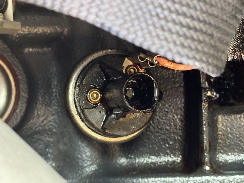

Hi guys I have a problem this thing is leaking pretty heavy and I just noticed it
It looks like it’s missing the cap in the center
I need to complete my day tomorrow but not sure how I’m gonna
The part number shows it’s a prochem part but is there anything I can grab at autozone to fix this and not wait

You can temporarily bypass the switch by removing it and plunging the hole with a 1/8 pipe plug if the machine won't start/stay running that means the switch is normally open and youll have to connect to two wires together. Keep in mind that you are bypassing a safty switch and it should be replaced asap but that should get ya back to work

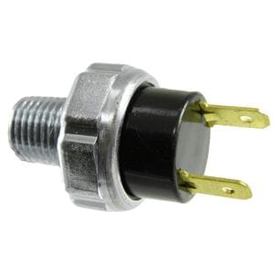

Yes, you can pick one up at the auto parts store. I bought a couple of them to keep on hand for a spare. Give me about an hour and I'll have a part number available for you to pick up
14,474
This is the updated version I have on my everest
Amazon product
View: https://www.amazon.com/Standard-Motor-Products-PS-135-Pressure/dp/B0011TY9VK/ref=asc_df_B0011TY9VK?mcid=184eb40bc4f53ffba68befef81a89e72&hvocijid=16017042778012889439-B0011TY9VK-&hvexpln=73&tag=hyprod-20&linkCode=df0&hvadid=730434204848&hvpos=&hvnetw=g&hvrand=16017042778012889439&hvpone=&hvptwo=&hvqmt=&hvdev=c&hvdvcmdl=&hvlocint=&hvlocphy=9057435&hvtargid=pla-2281435178338&psc=1
And the version you have pictured is the old version. the part number on it is 78826 7psi 2030 mex1

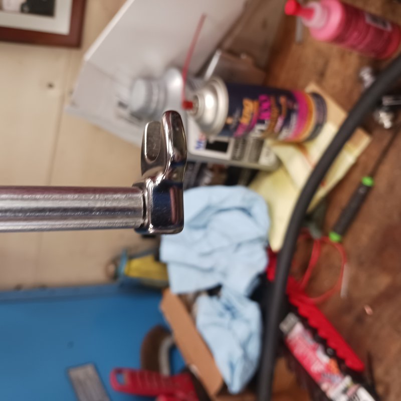

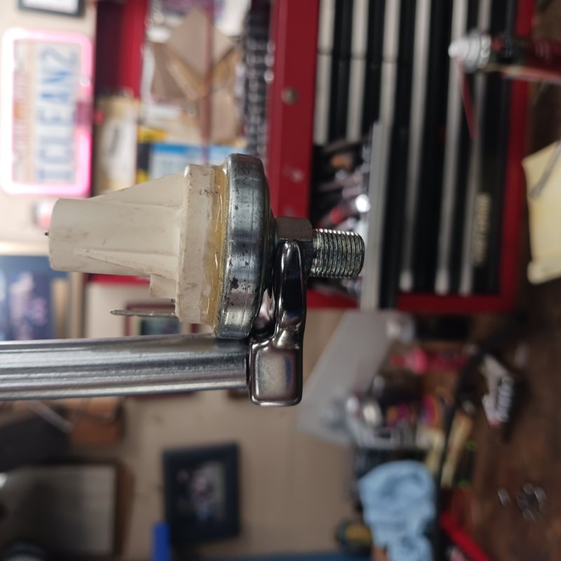

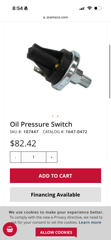

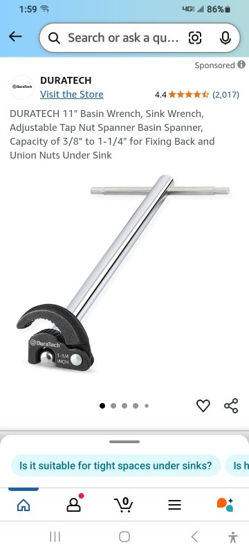

If you can't get a wrench in a 1/2" crowsfoot or a plumber's wrench should work

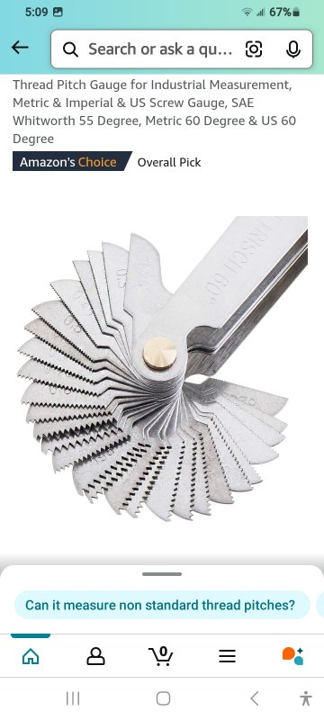

I have no idea what you have or what you're doing at this point all oil pressure switch I've seen are national pipe thread (npt) 1/8 or 1/4 most all being 1/8
Dwain Ray
Jul 22, 2020
851
1/8 pitch is 27 tpi 1/4 is 18 do you have a pitch guage? If you do measure the pitch of the old then the new if i have that information i can you what to do to properly install
