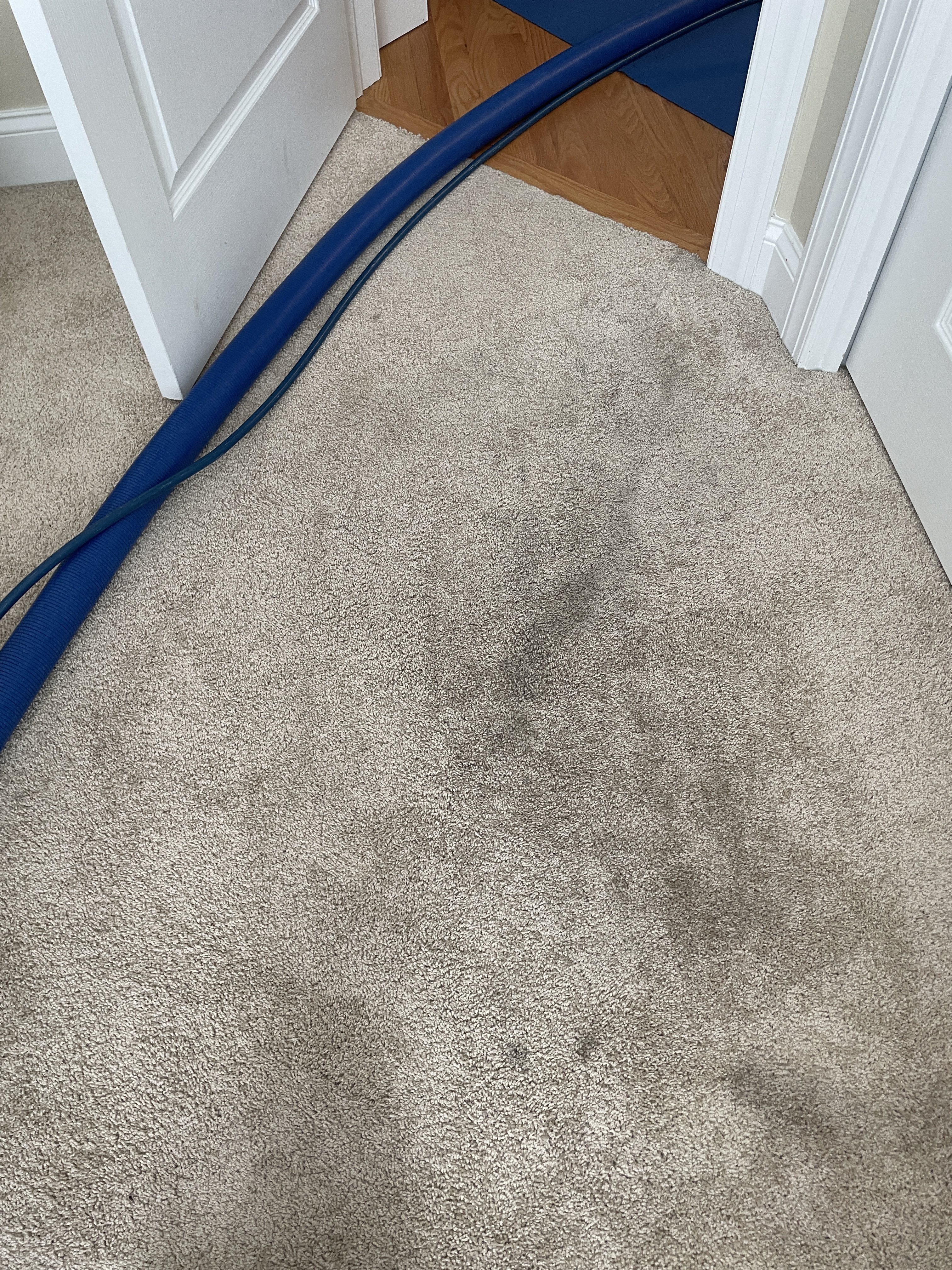

I easily avoided all of these issues yesterday morning on an older, white, dog urine saturated, residential carpet by using plenty of peroxide and a microfiber under the Phoenix.
I knew from experience that there was a strong chance of this stuff reappearing if I tried to HWE it. Because it was bone dry in 30 minutes, I reduced that to zero chance.
Why do I still own a truckmount again?

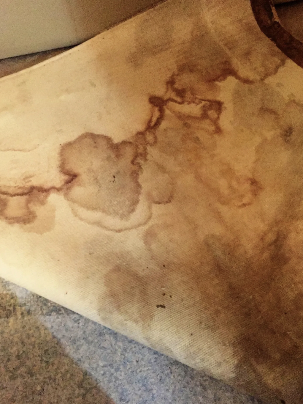

You mention oxidizing urine. Keep in mind when the oxidizer turns back into water (about an hour after you left), the smell will come back with a vengeance if the pee is still there
Was just over there a few hours ago, the clients are people I have known for years. Still smells like baby powder Awesome Encap. They're definitely happy with the result and the carpet was bone dry before I left. I run air movers in each room at every job, I have had dry carpet in less than 10 minutes using VLM.

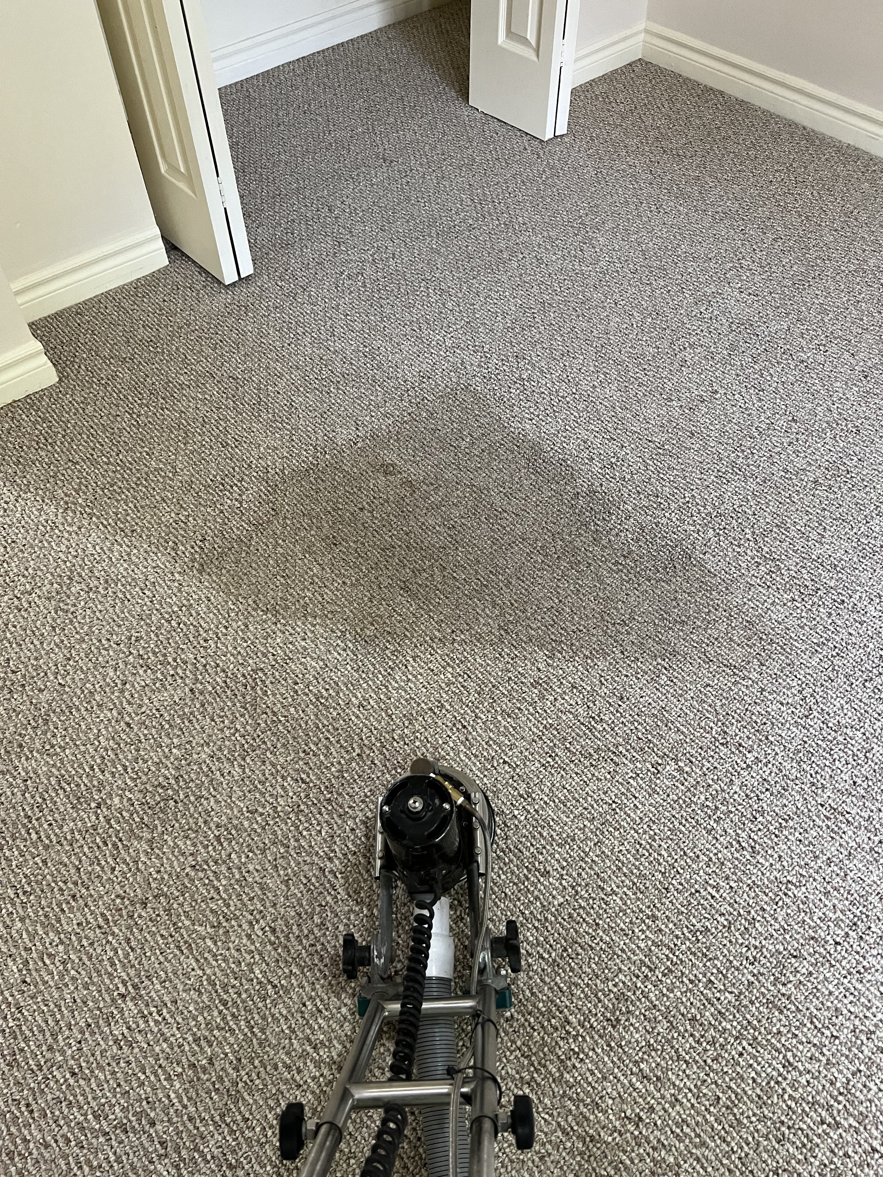

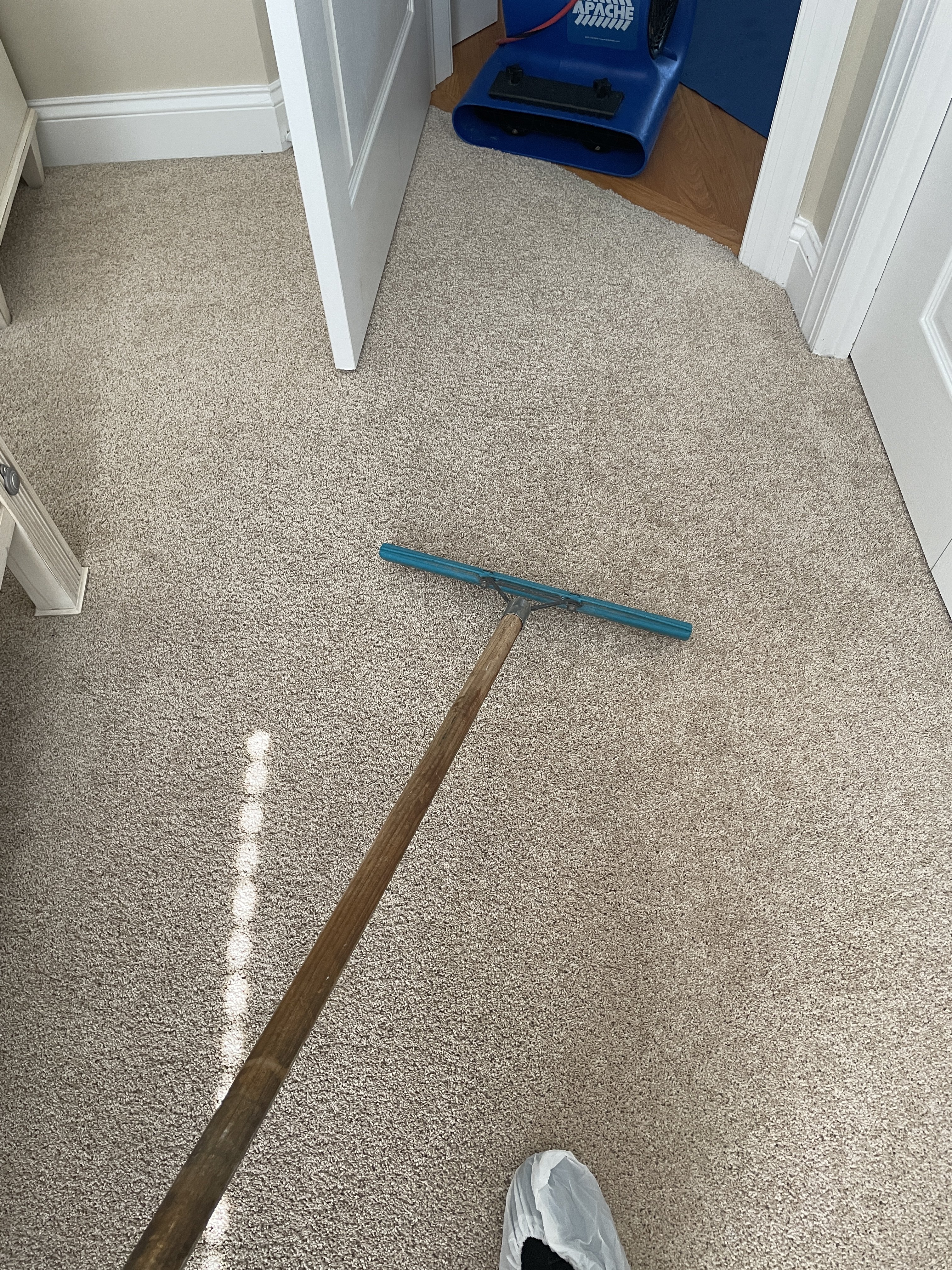

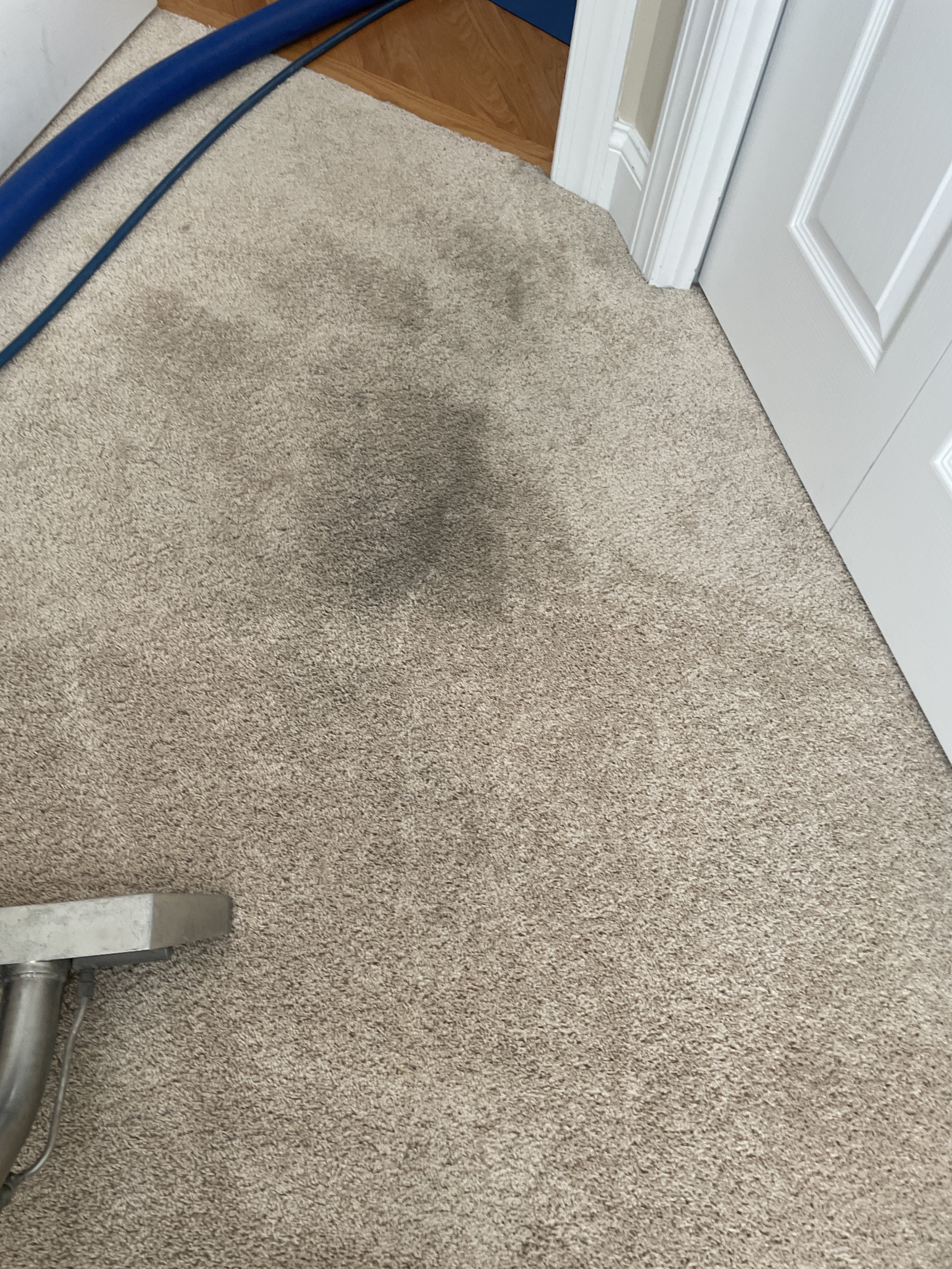

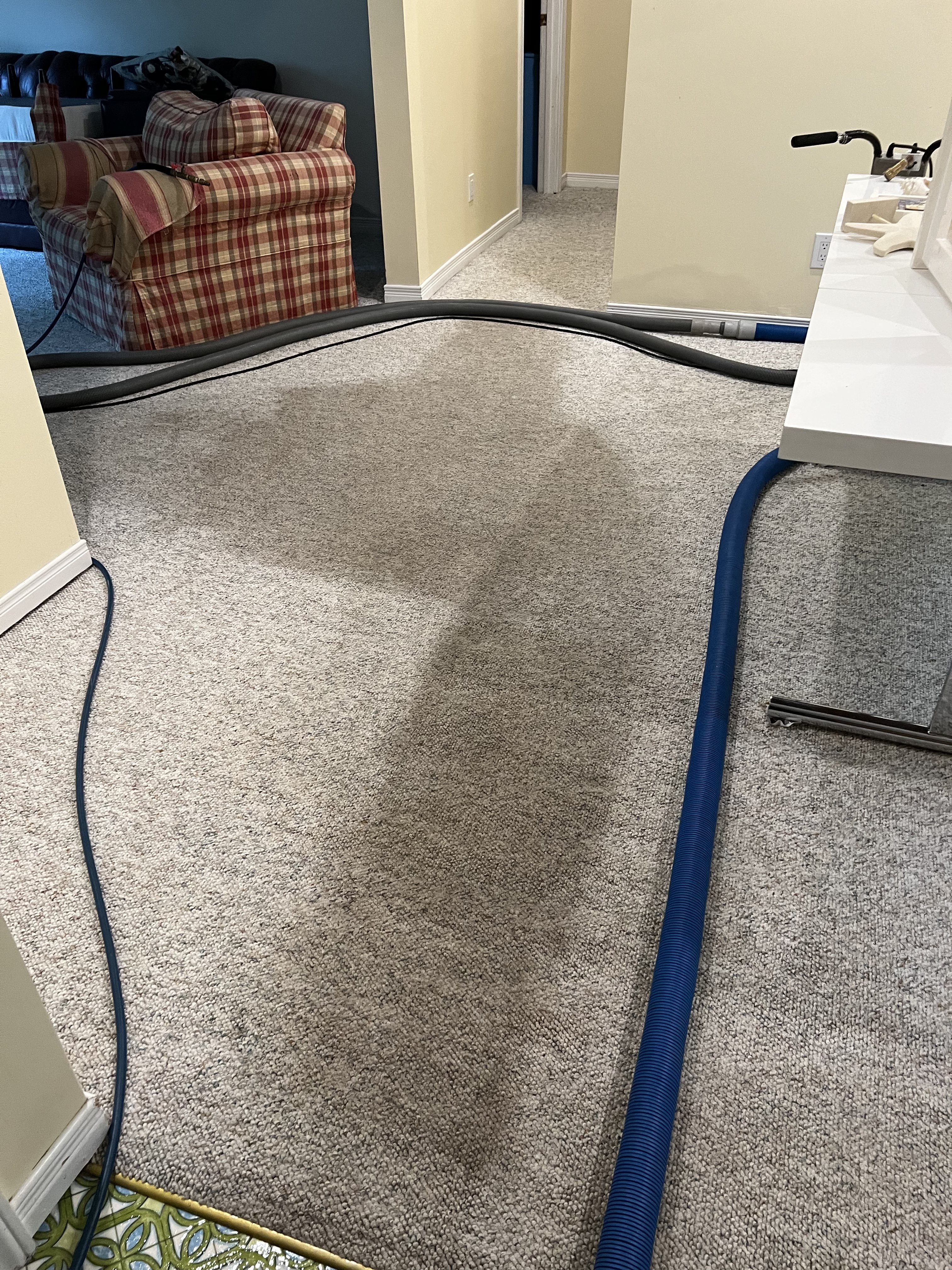

Went over this more times than I can count wet, and even more dry passes. Very stubborn, maybe somebody fumbled a big bong? Air mover key, even for 10 minutes.
No wicking, tip in payment.
