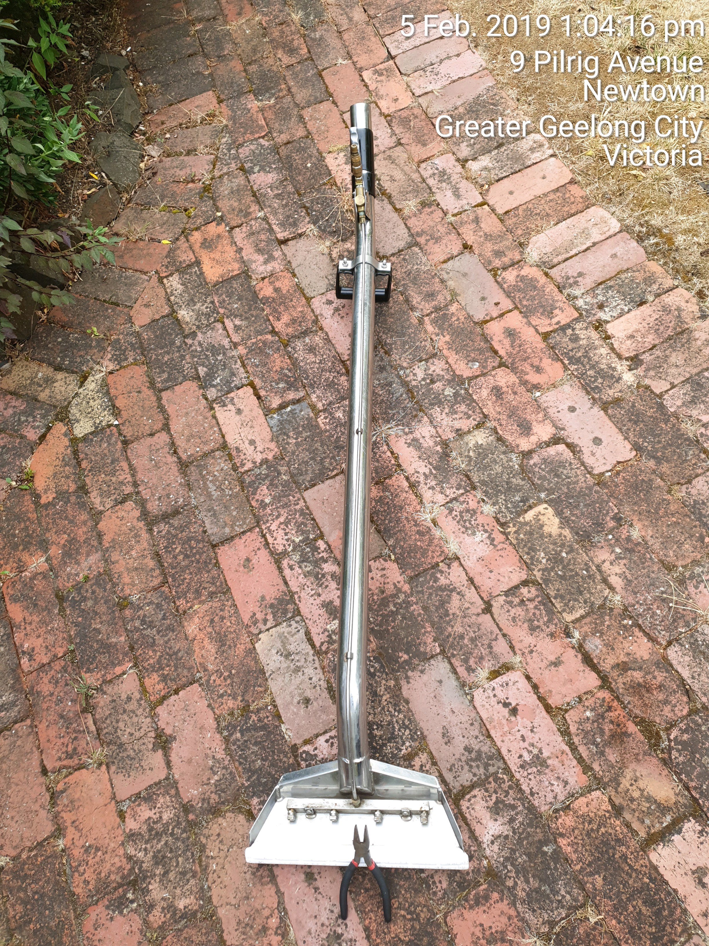

Please identify this wand.
J
JohnHawkP

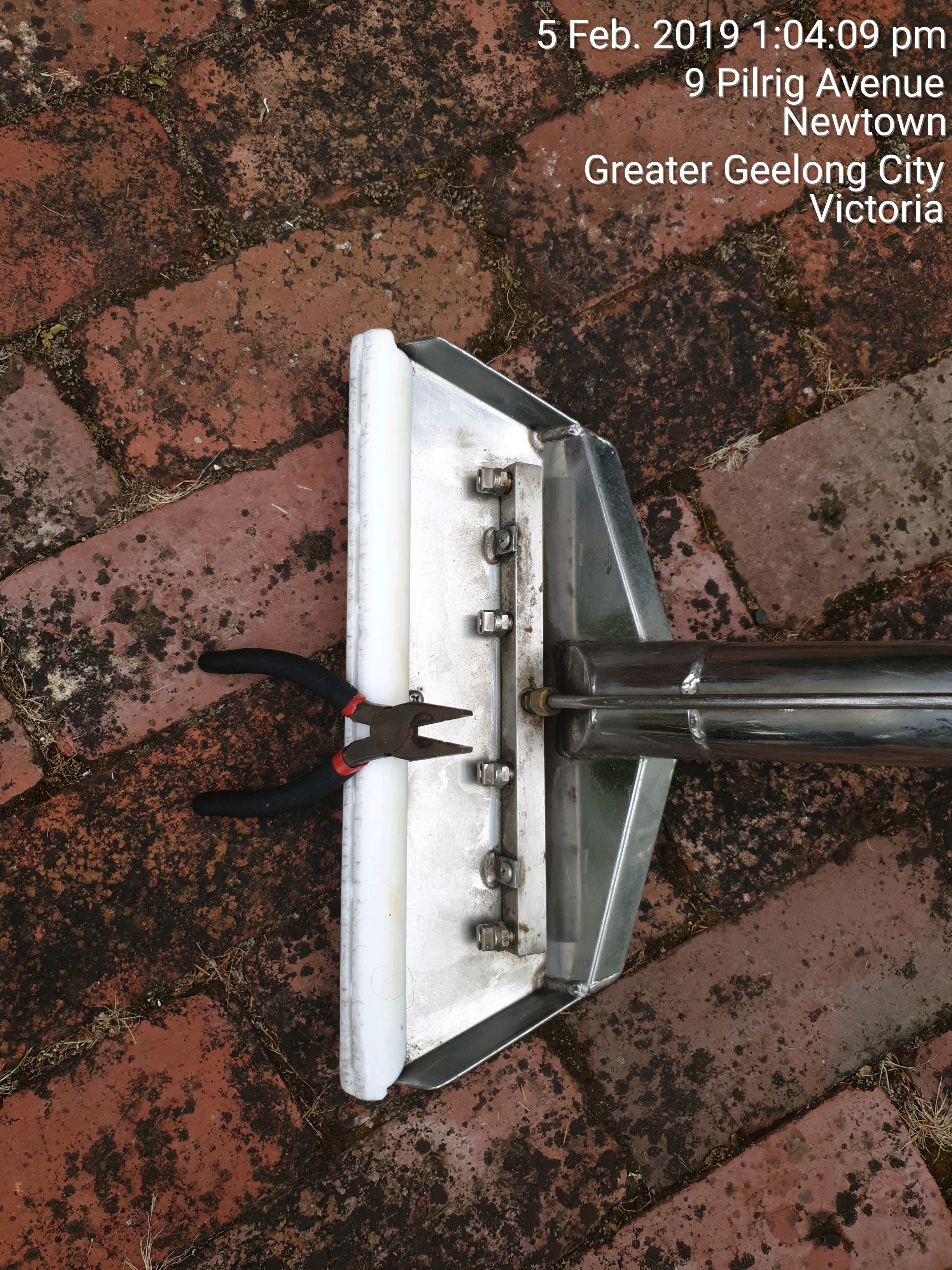

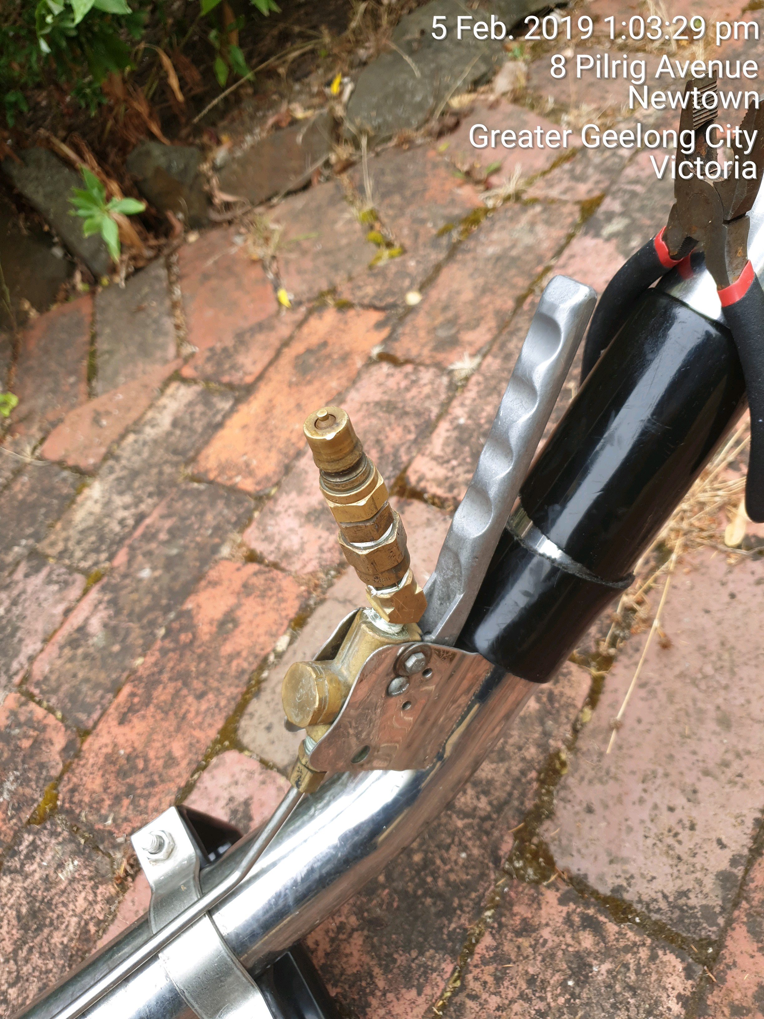

I need help identifying this wand.
I need a spray repair kit.
There is also a pin hole in the small stainless steel pipe leading to the spray jets. Can I solder this?
Thanks guys 885448854588546
117,375
California Metal Products all but disappeared from the scene until the Interlink swivel wand came out.
The wand in your picture is what Greenie based his Greenhorn wand on.
He use a Westpak trigger and a spray bar that had more sheer action
