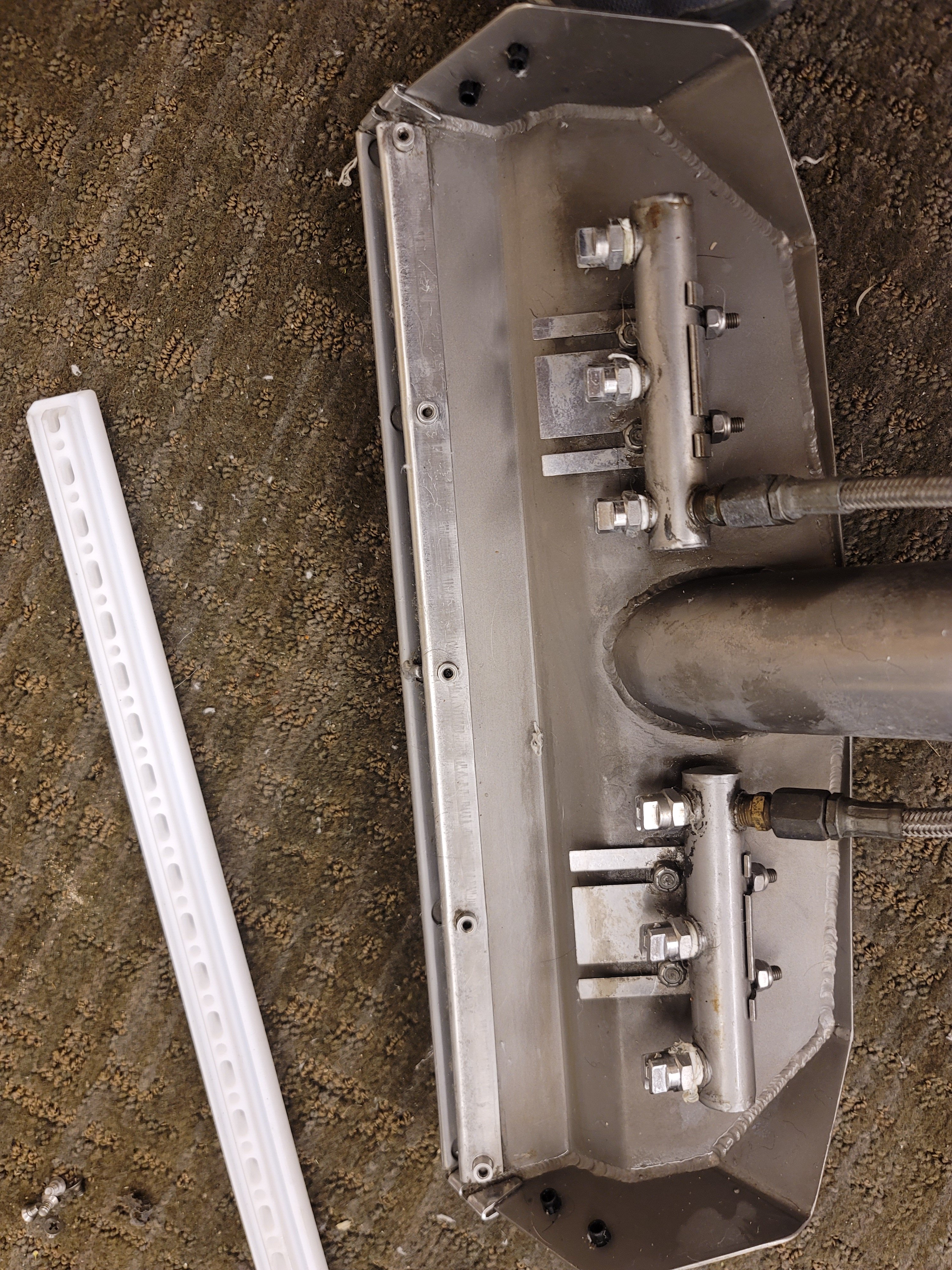

@Mikey P I'm looking at installing my glide and was wondering if these threaded rivets tap out of my Mach 15? 20220617_220749.jpg20220617_220733.jpg

put the wand in a vise and take a flathead screwdriver In a hammer or mallet and pop both front and back metal lips off and then the green glide simply plugs into the open vacuum slot

Based on those threaded inserts on the wing that one must have had the roller assembly attached to it at some point which you or someone else figured out was a pretty stupid idea so you can remove all that junk off the sides

That wand came that way when I bought it. Thanks for the help. Hopefully will have the new glide on this week.
