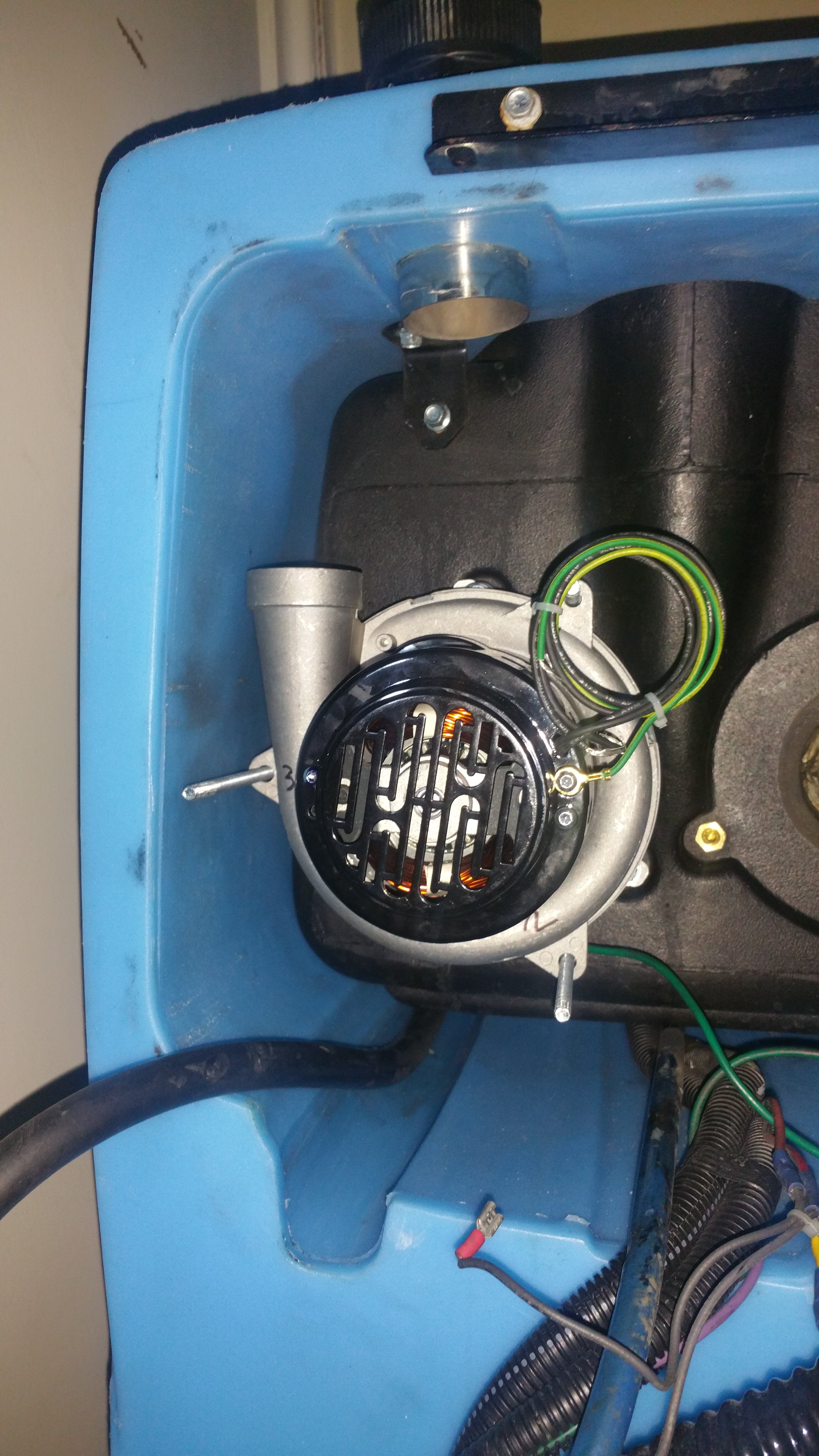

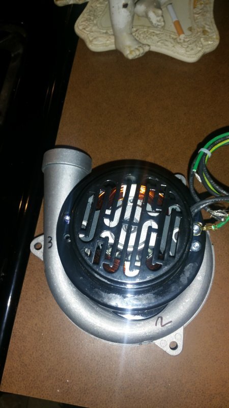

I'm wondering about amp draw and durability, Especially in a series setup. The rear motor runs a lot hotter than the front, so having ample room and ventilation should be the focus when choosing a platform.
I have considered that issue and here are my thoughts.
In LX series config with my kit, the rear motor (left) will be 180 degrees from the forward (right) motor as pictured.
I am going to go direct to the nearest exhaust port route initially, leaving the right exhaust port open as an additional cooling vent.
There is always the additional option of routing the exhaust to the further exhaust port, and leaving the closer exhaust port open instead for more direct ventilation of the rear motor if anyone chooses to do so.
The open port could not be better placed to cool the rear motor if there is the need.

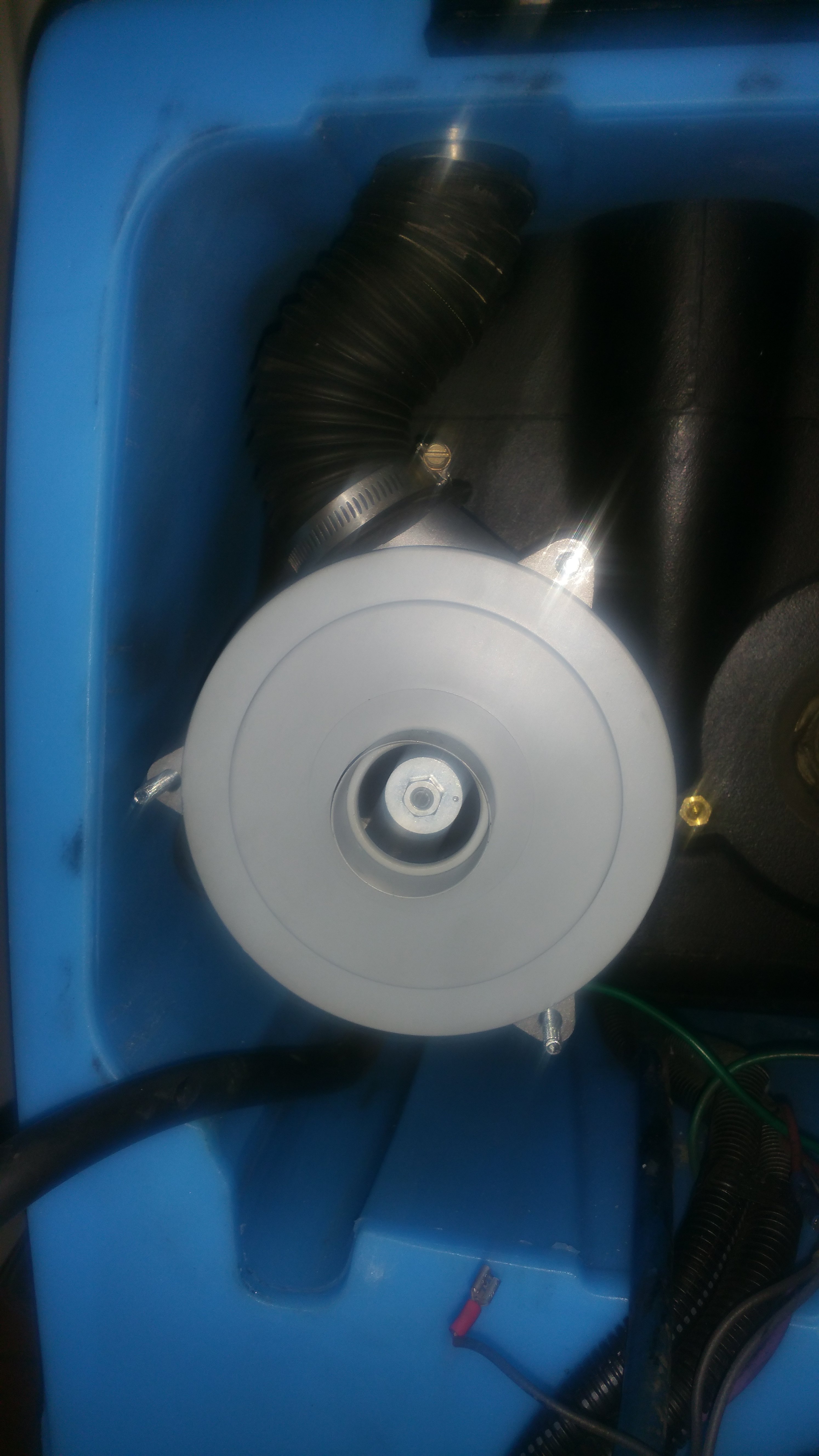

my mytee is an older version with the 2 5.7's in parallel on the base. Will those adapters fit side by side with both vac motors facing down into the manifold? I am in the process of replacing my vac motors. They are the 9.8 am 3 stage 5.7, I was looking at using the 13.5 amp 5.7 but if I can fit the 6.6's it might be worthwhile.
I have looked at my old M5 with base mounted 5.7's
Once the 5.7 motors are pulled, the rubber return manifolds and mounting hardware would have to be removed.
I am pretty sure I can mount the adapters on and attempt to mount the motors facing UP, so the existing stack hoses can be plugged right on.
The question is whether the wider fan housings will hit each other in parallel config.
If they do hit, I may need to mount one motor an inch higher than the other so the wider parts of the fan housing can clear each other.
Since series config with my kit mounts the motors 180 degrees to each other, there is more space to play with...................Just like shoes can only fit in a shoe box when 180 degrees to each other.
I think it will work, or I can make it work once I get around to it.
