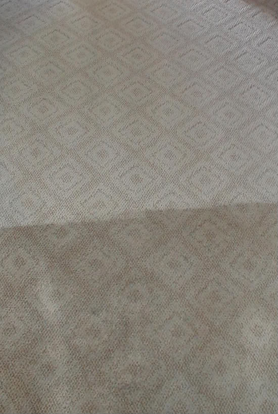

Do you think post padding would have made a difference?
Carpet was dry in 30 minutes. Airpaths. No post padding.No wicking.
And those are shadows.....
C
Curtis Pennington
Nice...
R
Raedan
Just trying to help.
I personally don't see a benefit to post padding after HWE.
Everyone has their own way of doing things and that's fine.
The only thing that matters is the end results and your customers happiness.

S
steve frasier
yes, cotton post padding that would have got rid of the dirty streaks/lines that are still in the carpet
R
Raedan
Do you actually read a whole post before you reply?
Read the post again. Shadows........Duh....

H
harryhides
admiralclean said:
This argument was regarding the drying benefits of post padding, Mellon. Not if it removed more soil.
Having said that, let me ask you this, can you SEE a benefit from the extra soil that is removed (on the carpet, not the pad) by post padding?
If not, then it's just more method masturbation ... and the 13th step in your "process."
Hey, Mr Doofus, Bama Logic, do you suppose that the soil removed by post padding was dry soil ? or possible WET soil?
So obviously if the process removes soil it also removes moisture and reduces dry times.
Maybe, just maybe Curtis has the brains to be using absorbent cotton pads while you've been using STOOPIE synthetic Pads and wonder why nothin happened.

S
steve frasier
Joe
:oops:
what you call shadow I call streaks, looks like there are 3 different wand streaks, I can see a shadow in the upper right hand corner of the picture
I read it but really don't believe you but you know pictures are a funny thing. You could show that same picture with maybe a chair mat still on the floor. Carpet looks clean in the photo but if you pulled the chair mat you would see that is wasn't.
So maybe it is just a light reflection thing going on but it you had put a cotton pad to it you might have changed the appearance of the carpet enough that your shadow wouldn't be there
that is the thing about op & encap cleaning, you could OP a carpet and wipe it with a white towel and the towel will pull dirt but the carpet will look great but if you had HWE cleaned it and wiped the carpet with the towel and the towel pulled no soil, it still might not look as good but would be clean
so sorry Joe but if you didn't do any of those things, you didn't say you did, then I call it dirty :shock:
carpet looks good in this photo along the edges of the mat where it was cleaned but if you pull the mats then you would see a different story
ran a cotton pad over it when done with a glided OP machine and it pulled more soil
