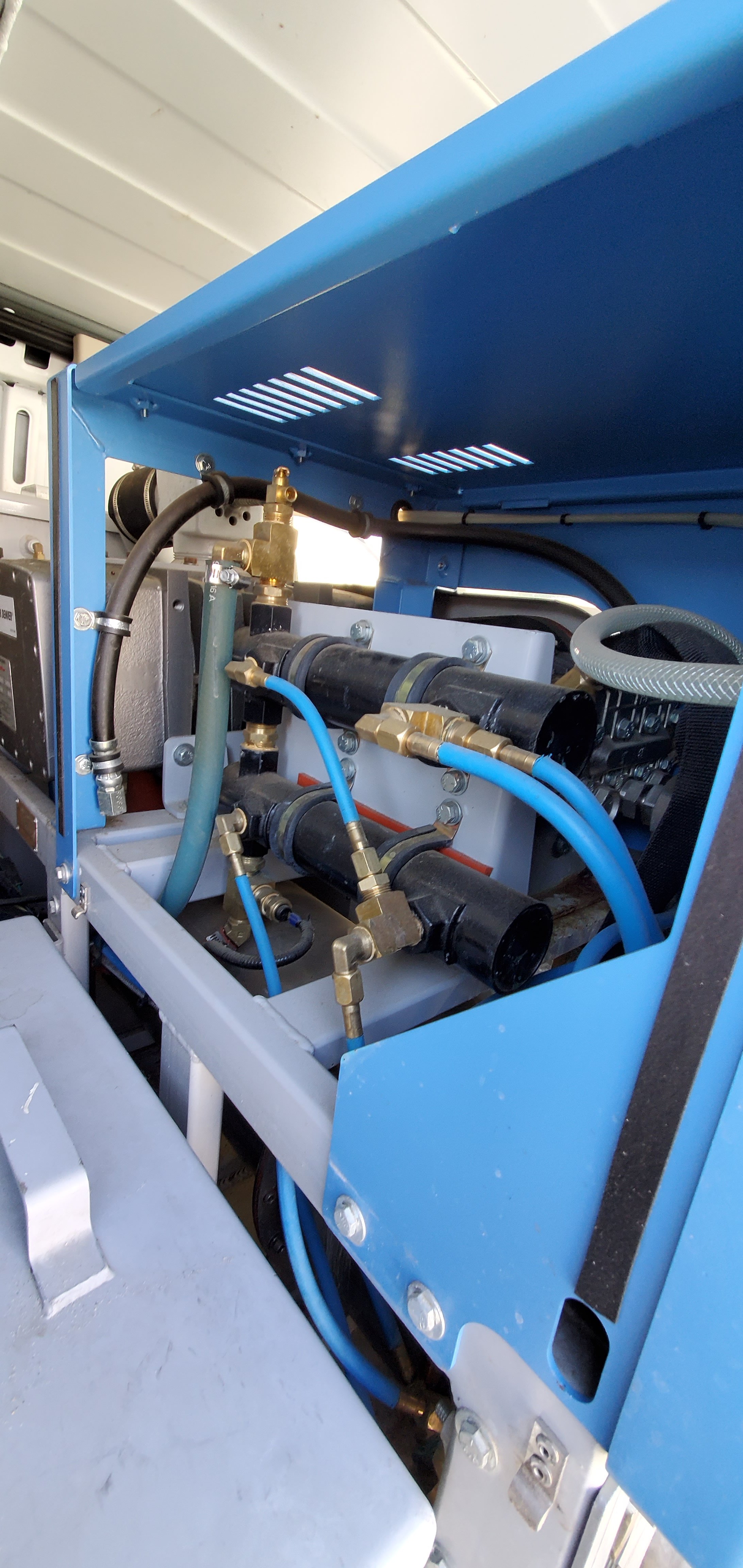

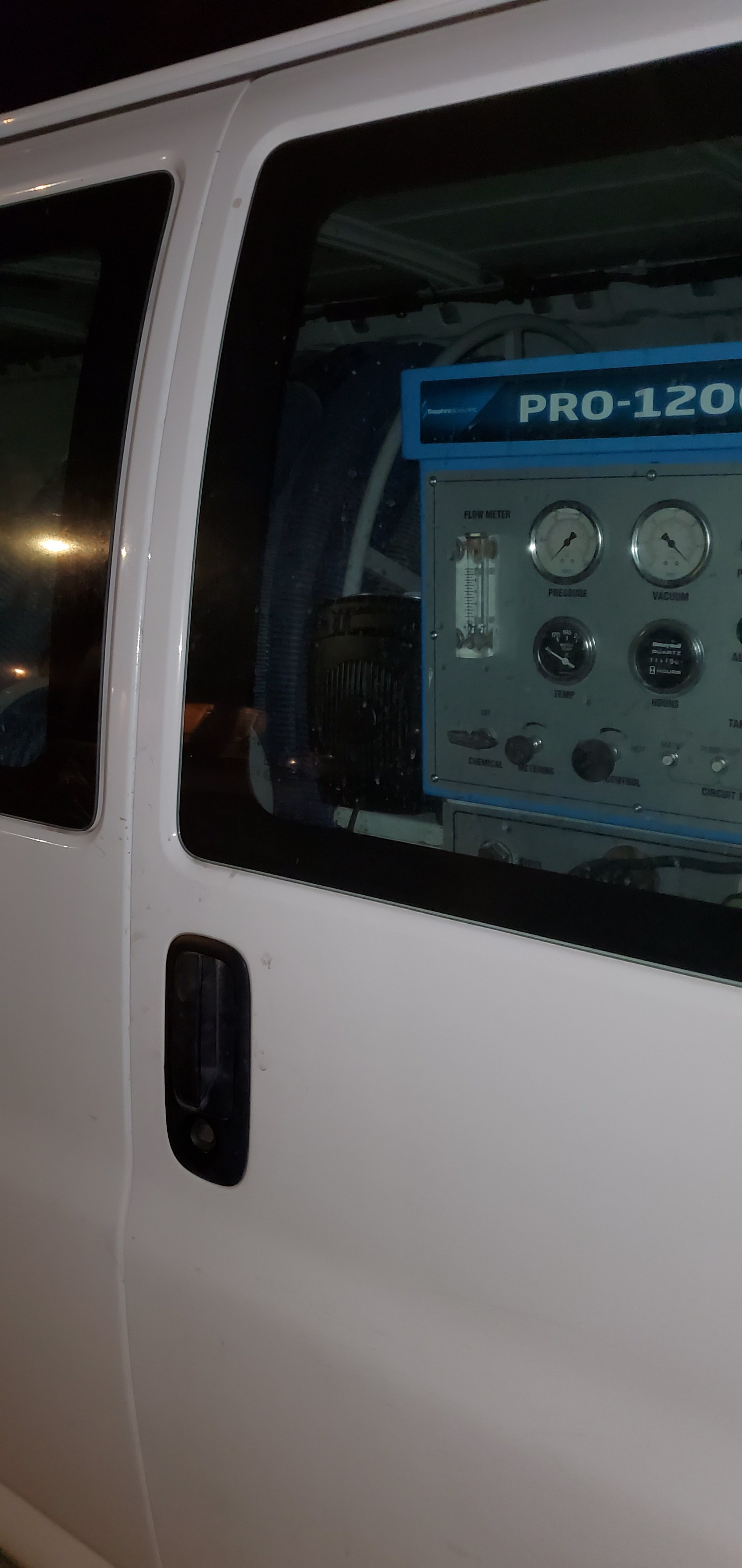

Also got the Doghouse and all the other pieces back into the van.
I'll clean it up when it gets warm.

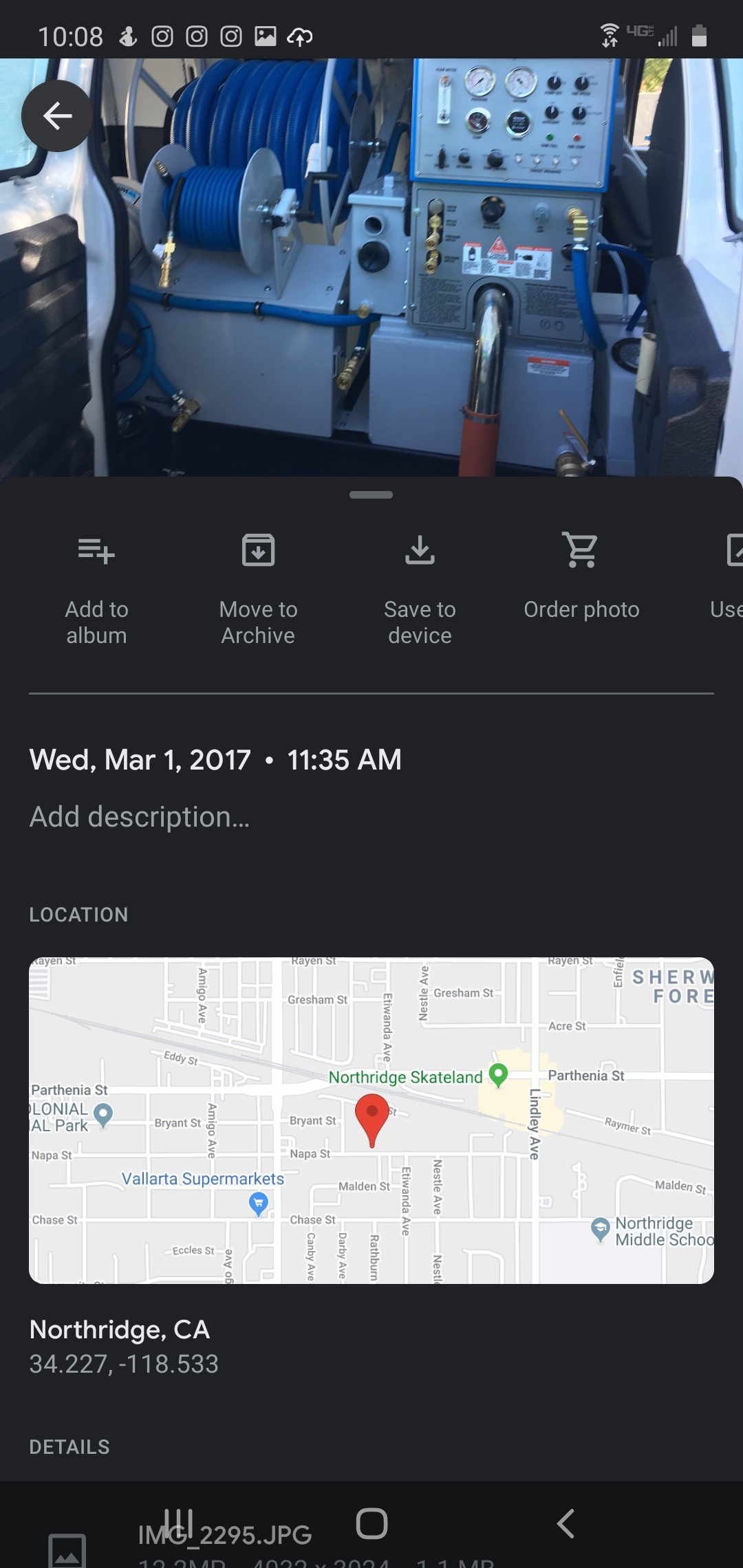

20200203_134846.jpg 20200203_183734.jpg 20200203_183812.jpg Screenshot_20200203-220844_Photos.jpg

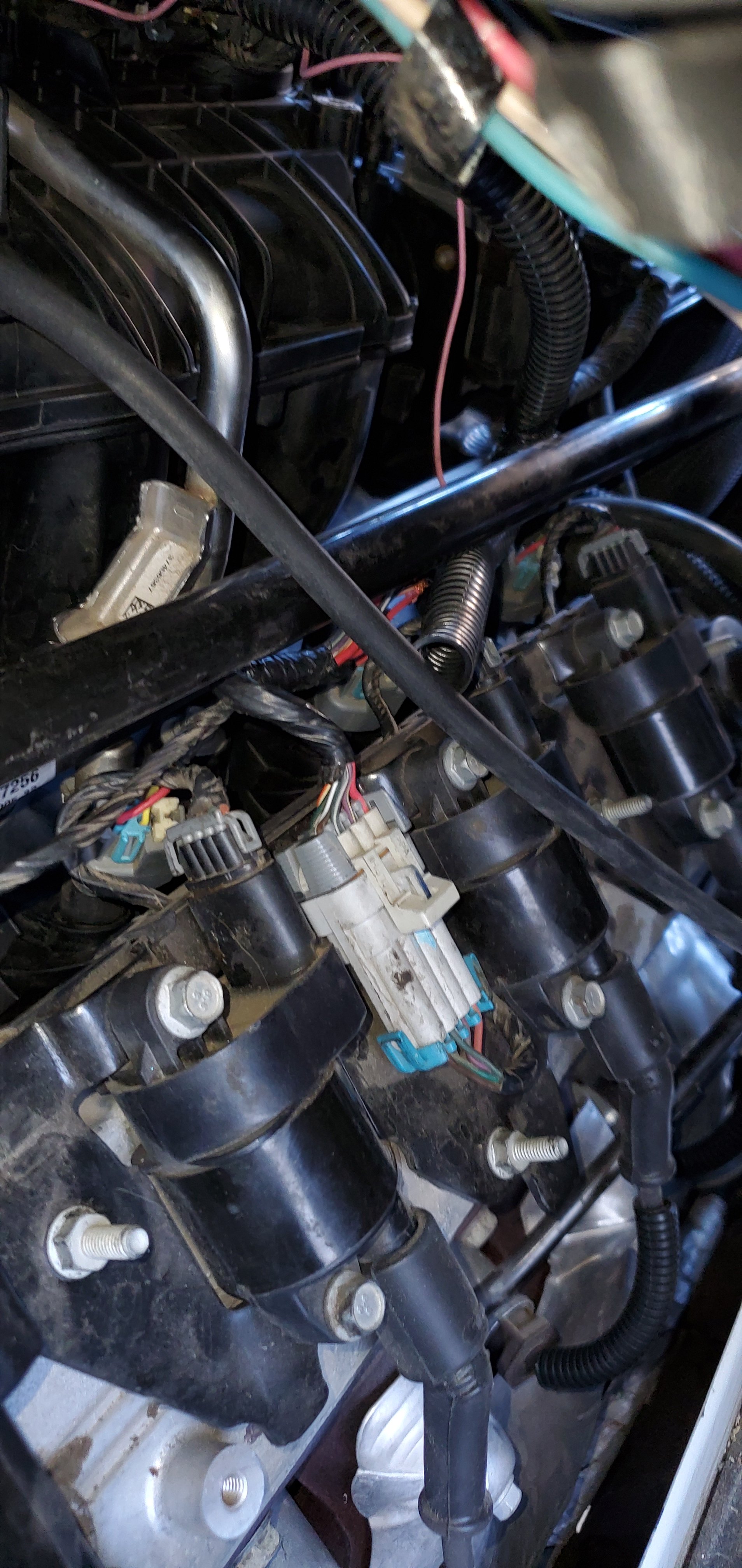

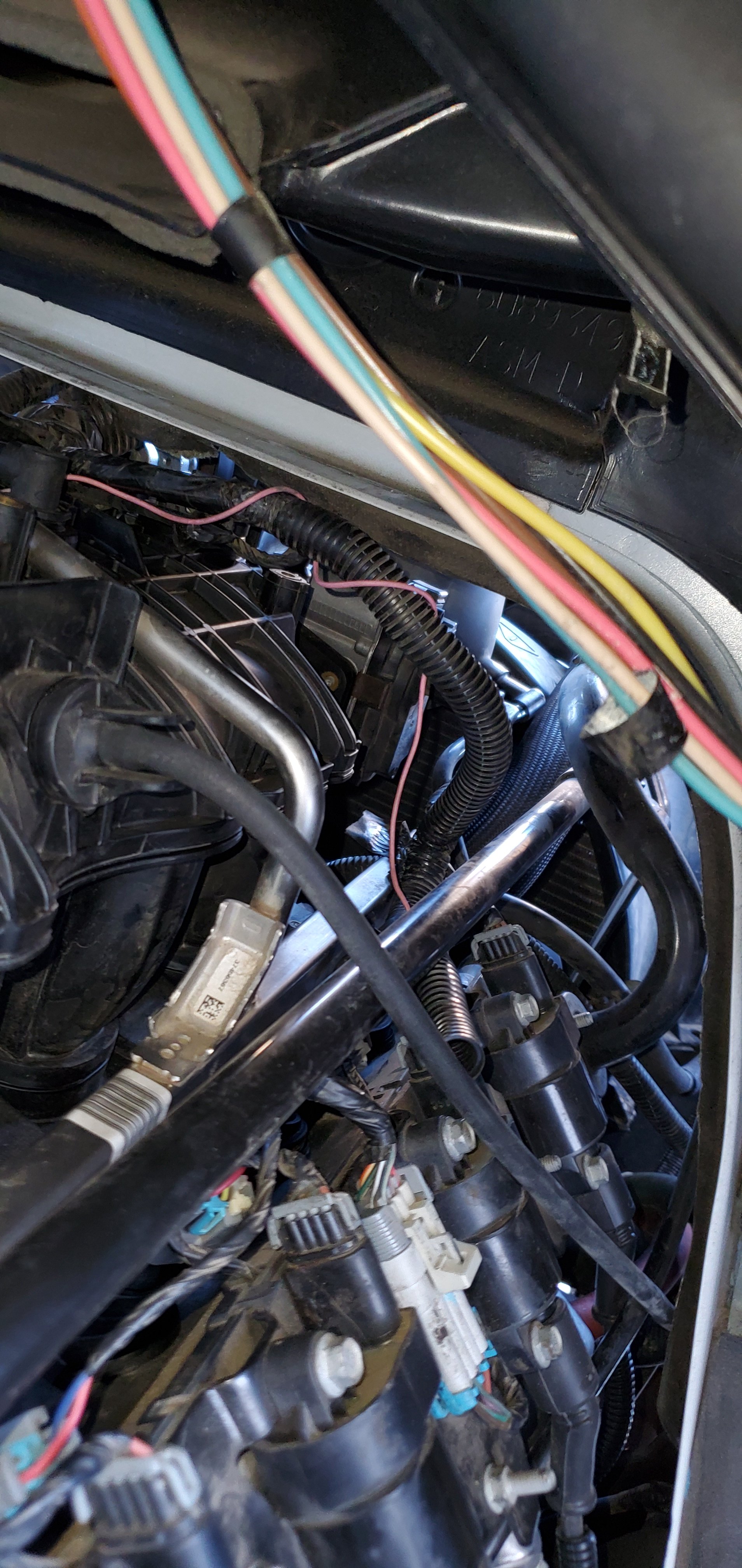

I had a evap code PO442 this was coming up before all the problems,
So I tool it back to Hugo figuring this would be an easier fix.
He found the leaks and was repairing it when he noticed Chevy pro wiring hack to fix my other limp mode bank 1,3,5,7 issue.
They ran a wire from bank 2 to bank 3 with correct voltage.
He said other then that they would've probably needed to replace the whole electrical harness.
It works for now hahaha.
Hes gonna check pricing on a new harness and will see about putting that in later with better than stock heat shielding.
11,531
The little red wire coiled around the bigger wire was the fix.
