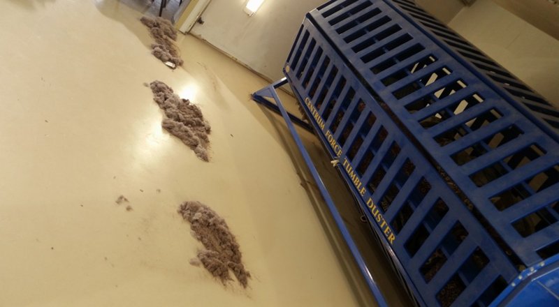

Not quite like you expect Gene.
Yet most of the facilities make an enclosure. Almost all put in an exhaust fan or what you describe as a woodworking vacuum system. 12144936_1196778597002882_3027826229285188525_n.jpg 12072732_1196778620336213_2094625342414549793_n.jpg
Heavy stuff accumulates on the floor and is swept up periodically. 3 piles shown here from ARCS day, just before Rug Summit 9, was what came out of the rugs shown without the aid of a human. Except of course, the initial loading them in the tumbler.

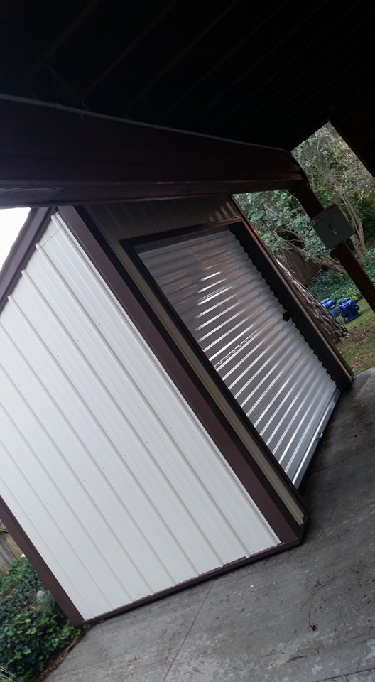

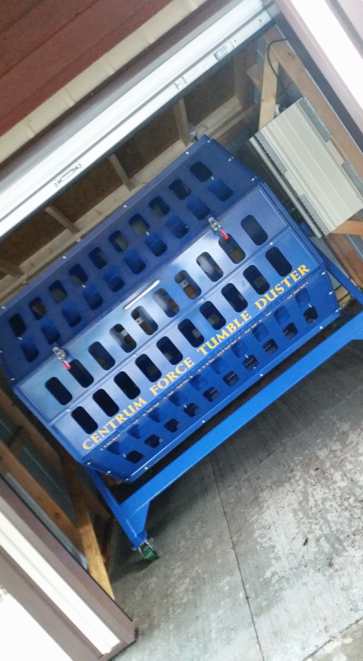

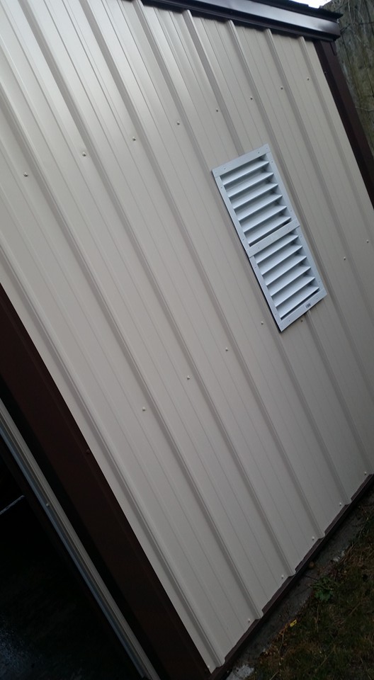

This is my personal Tumble Duster at Area Rug Cleaning Company. I have it outside. There is an exhaust fan located in the back of the shed not discernible in these pictures.
