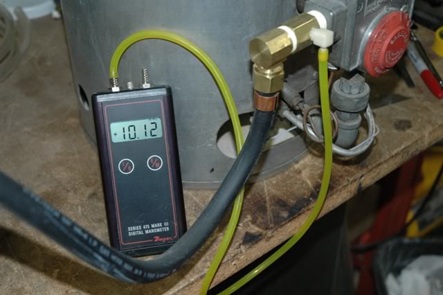

Hmm... I didn't think of that, not a real problem here in Phoenix. As a quick test, you can pour some warm water on the regulator and check for a sudden increase in heat output. Icing is rarely a problem (I've heard) unless your propane supply is crappy, with a lot of entrained moisture, but it can happen. The only way I know of to properly check for gas delivery problems is with a manometer, like this:
Standard propane appliances use a gas pressure of 10.5 inches water column (between 10-12 IWC is considered OK), but big industrial burners sometimes use higher pressure, on the order of several psi. My setup shown is checking regulator and supply hose, you would insert a tap fitting between the gas valve and burner to check the gas valve. Obviously, check the pressure with the burner firing.
The Dwyer electronic manometer I use is about $150, mechanical Dwyers (Magnehelic) are around $70.
