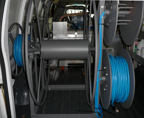

Just finished an install with a new type of hose reel for us. Quad Hose Reel :
It has capacity for: 350' of 2" Vac Hose
500' of of 3/8" and 1/4" Solution Hose (live).
250' of Water Inlet Hose (live).
It was part of a 38HP TM install for a customer who does long hose runs on commercial jobs.

Is the hose reel on the far left for fresh water or solution? Is it a back up hose? Seems pretty tight for daily use.

The left hand reel may look akward but suprisingly fast and easy to use.

Larry what the cost of that setup?
It's $678 for the Quad Reel or
$838 for the quad Reel w/live solution hose and water inlet options.
The reel over the wheel well is the additional 200' of solution hose for long runs.

Is the reel to the left electric?
If not, how do you reel that in?
It looks like it would be very difficult to get in there and spin that reel to reel the hose up???

Left handed bro!
There's no need to use your right hand as a guide either cuz your body and the van wall does that for you.
High speed low drag! Its a great use of otherwise wasted space.
