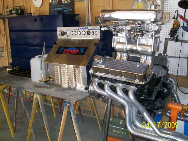

I'll see you that an' raise ya this:
and this:
an' finally this:

Hey, Bawb...
All I kin see is a covering over the real story inside in your pic... 8)

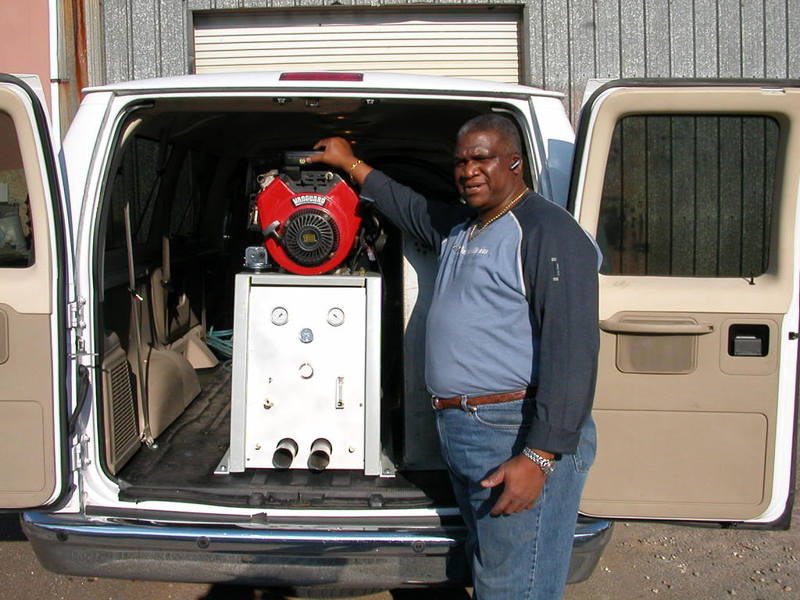

And here's the proud original owner of that 1998 Hammer then...
And now, with the new version of it...
What a difference 11 years makes... 8)

frankiechocolate
nice job dude, but is it my imagination or has that slide in put on a little weight?

D
Duane Oxley
Frankie chocolate
You mean the system... or the owner...?
Actually Billy has gotten a lil' bigger over the years. But I think he's about to lose some. He just retired from his "day job" and is going full- time as a cleaner now. (Full time for him means doing jobs he wants to, for fun. He doesn't need to work for the income.)
The system is a bit more spread out, or rather, "up". That makes it super- easy to work on. I revised that frame design on the next ones to be 2" shorter in height, though. It was a bit taller than it needed to be.
The original Hammer systems were 16.5" wide. These new frames are 21", which allows two mufflers to be in parallel and sit inside the frame nicely, as well as allow the Cat to be located where it is and have room to move back and forth to adjust the belt tension AND be easy to work on.
These frames can handle 33, 36, 45 and 47 blowers. The 47 version has 2 "B" belts as the drive system between blower and engine.

Ron sez:
"Bob, your blower elbow looks a little restrictive. Nice weld, but too sharp."
you'll havta blame Steam Genie R & D....that's EXACTLY how they built them....and no it poses NO restriction at all......it's Stainless and required a TIG weld!
may we see some of YOUR projects.......
