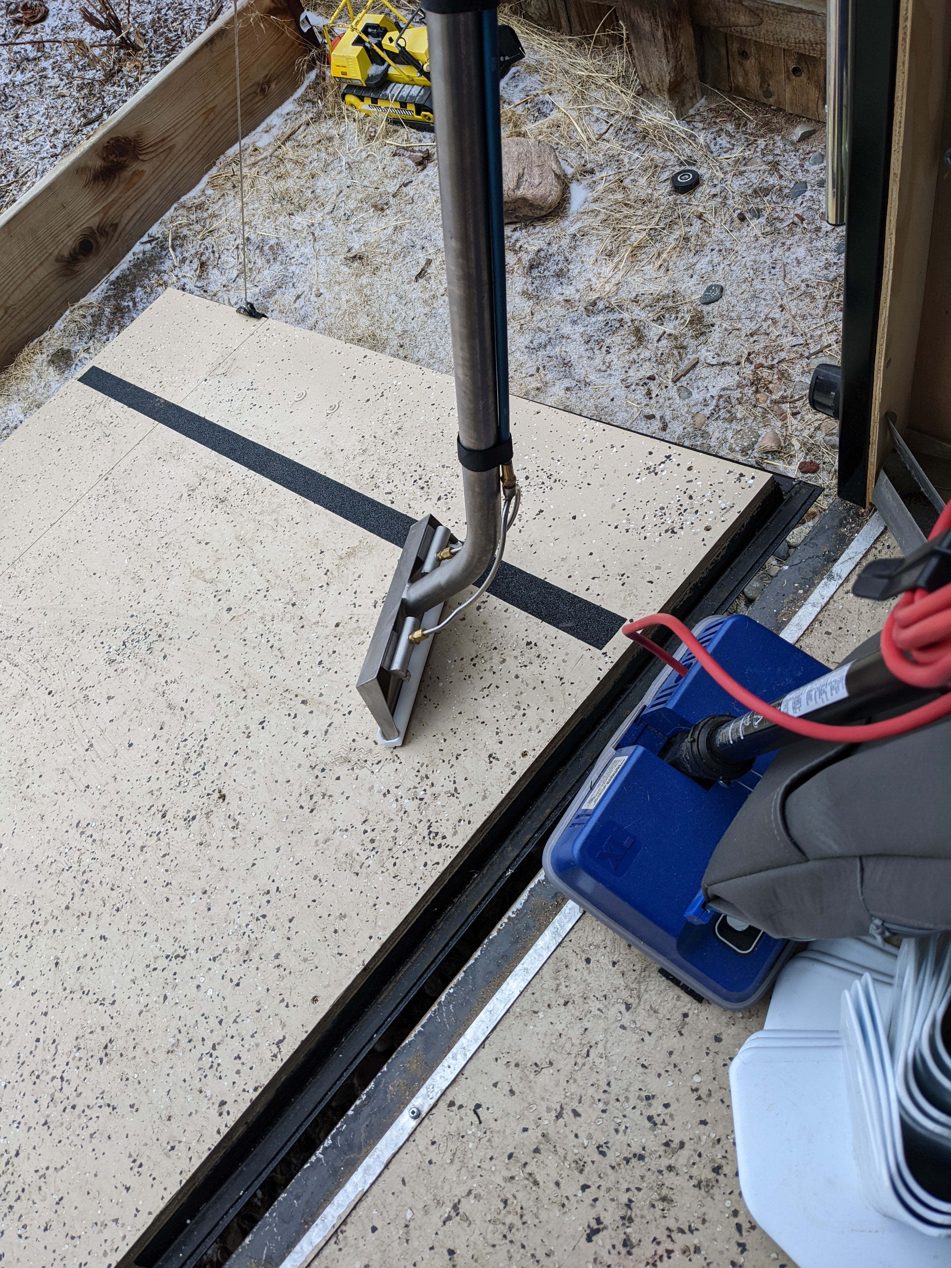

Post a picture

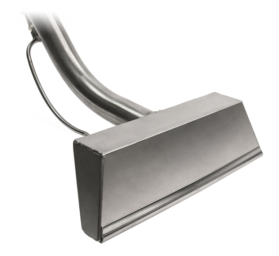

In reference to the two jet glide that Fred posted, a picture of that is no longer made , you'll need to get new metal lips (ac33-802) and the GG carpet glide

And yes, if you want to clean garage floors, bring your leaf blower. Blow out all the junk into the driveway. Spray down a shit ton of some oxygenated high pH grout cleaner. Scrub it in with a 175 and a black pad, preferably or CRB with the stiffest brush and then rinse with your sapphire/ brush glide wand and you can guarantee them it'll be white sock clean until they drive the car in...
