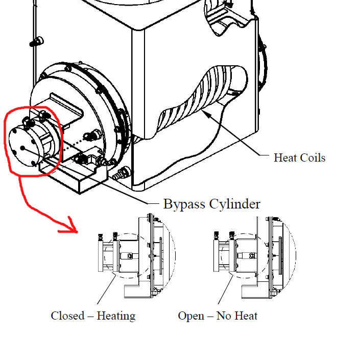

Fellow owners, you are aware that the Bimba valve will not engage if the system is not under load and running at 70% or more?
In other words let it RIP when you're prespraying oif you want mega heat for the first room...
If not a smaller 370 may never catch up if you're heavy on the trigger from the get go..
