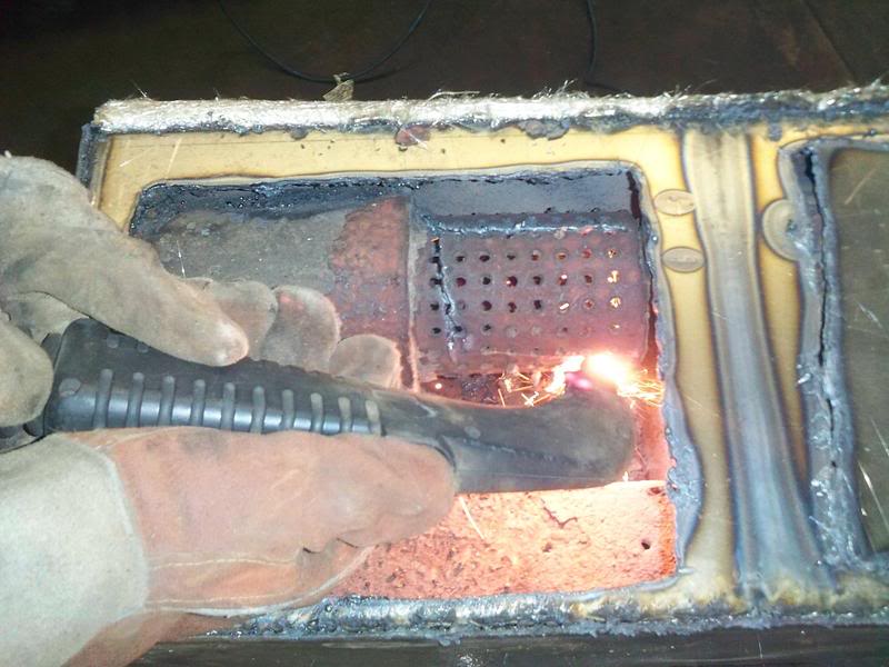

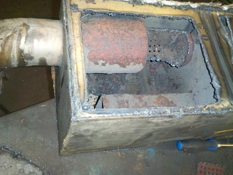

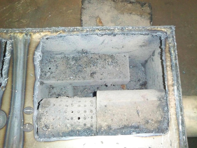

If you own a Butler truckmount system, there is a modification that we suggest for the blower silencer. We have had quite a few Butler systems come in for excess blower heat and low airflow issues. The heat issue was so severe that the heat would transfer into the pulley of the blower. This would cause premature belt failure. During our analysis of this problem we discovered a blower air restriction in the silencing system. In the pictures you will see that we cut the silencer open and discovered that all the air coming from the blower is being forced through a 4 inch long by 3 inch perforated pipe. This pipe has 1/4 inch holes. The end of the pipe is capped, so all of the air is forced through these ¼ inch holes. On this muffler, the holes began to stop up with corrosion, causing excess backpressure on the blower. This excess backpressure will cause the blower temperature to increase considerably. The backpressure also diminishes the airflow.

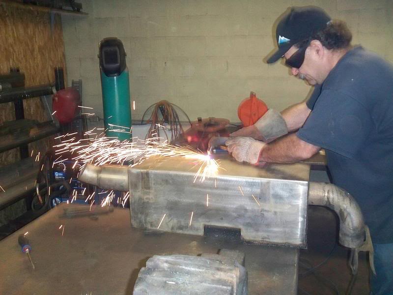

We corrected this problem by cutting the pipe open to allow free flow air. We were concerned that if we did this it might make the unit too loud, but since we reinstalled the silencing system, we have not noticed any increase in sound level. It is our opinion that even if the holes were not stopped up with corrosion that a 4 inch pipe with ¼ inch holes is too restrictive.
If you own a Butler and would like to check to see if you have an issue like this, go to the auto parts store and get a pocket thermometer. Drill a very tiny hole in the pipe leaving your blower. Insert the thermometer in the hole, start the unit, allow it to run for about 10 minutes to come up to operating temperature. Your blower exhaust temperature should not be over 275 degrees. If you are experiencing excess temperature, you now have a remedy for that problem.

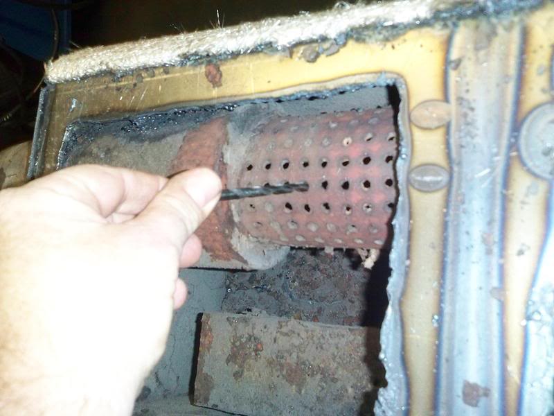

On the other hand, I wondered about Les' thought that the 1/4" holes were too restrictive. The tube is 3" dia. according to his post, which corresponds to an area of 7.07 square inches. If I'm looking at the pics right, I count 20 rows of 8 - 1/4" holes each. The total area of the holes would then be 7.85 sq. inches, so new, clean holes would not be any more restrictive than the tube itself, I think.

was the pic Les posted of a poorly maintained unit???

We have repaired 3 Butler's with this same problem. All the units had their filters in the recovery tank.
The inside of these silencer's are not Stainless Steel. From what I can tell the Carbon Steel is rusting from hot moist air.
As you can see in the pictures the holes are completely stopped up.
The silencer's that we repaired were between five and six years old. As far as did these Butler's have proper maintenance done to them, I was told that they did, but you never know.

The problem is the use of a steel that is not stainless.
We have also seen many blower silencers on slide-in TM's,
clogged by corrosion of the internal steel parts.
It causes the blower to overheat.
All blower silencers should be made of stainless steel ...
if you expect them to last more than a year and a half or so ...
with wet detergent run thru them every day.
Stainless steel forever.

we cut one of ours open today based on your advice... Guess what we found? A totally different inside.... It has been totally redesigned and this is in a 2006 model.
