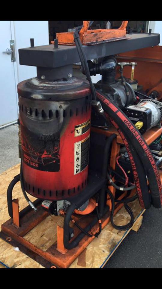

After going though my experiences with a Northstar, I would never let an employee run it alone. They put out the crazy heat, but you pay dearly for it in the long run.
Goomer
Feb 9, 2009
3,398
Frank Mendo
Looks like that square exhaust did a very poor job of efficiently venting the hot exhaust away from the unit.
Knowing all too well myself the ridiculous amount of exhaust heat/force those things put out, I'm not surprised by the looks of it.
Surprised it did not melt a hole right through the top of it.
Very poor exhaust design for 350,00 fuel fired BTU's.
