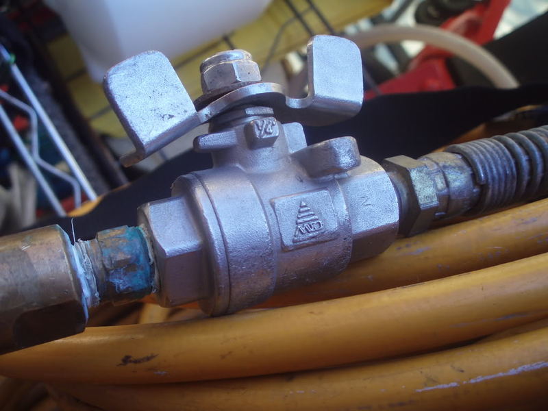

Somebody asked me what type of pressure hose shut off valves I like...
This all Stainless beauty will last more then a year. You'll destroy the handle way before the guts give way.
I got this one from Sal Muscatelly, John @ Mytee's evOl brother in law or cousin..I cant keep track.
If any of you MB certified suppliers sell this one please speak up.

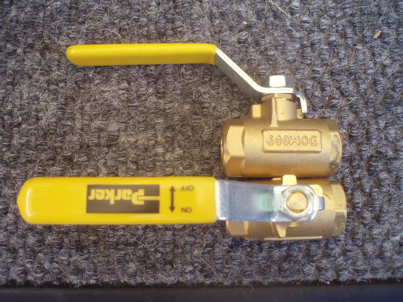

I also like theses Parkers. They last 6 moths or more even when cleaning Tile at 1000 pounds or more.
Dont even bother with those Circle Seal Prochem POS.

The parkers are very good IMO except they always leak around the nut that holds the shut-off handle on.

The damn handle fell off, the first week I had it on, I can't keep the nut from falling off. I switched from the plastic handle valve cause the little screw would fall out of the handle. I let the solution hose drag on the ground when I roll up the hoses.

I have success with the Parker valves, unless I crank it about 1500 psi. I will then leave the valve open with a chimp standing near it....just incase.....whenn I apply pressure.

This is what I use. They are very solid and long lasting. Highly recommed. A+

the handles on no matter which ones we use always break.....just like MIKEY said...the guts last along time....ive never had the guts go bad, b/c i replace when the handle breaks
50,041
Did it ever get cleared up as to where Mikey actually got that valve?

Thanks Mikey,
It was me who contacted you a while back. I have been going through shut off valves like crazy. I am going to get me some of those valves.
Anyone selling them, contact me. I will buy....

we buy the parkers at least i think they are
at lowes 6 bucks i think last afew months
try one
18,851
Lee Stockwell
I've got eight years on some of the italian valves that Cobb sells.
We get a year or so on the Lowes valves too.
at lowes 6 bucks
try one
same here, but I'm pretty sure they're not genuine "Parker"
Just a common 600psi WOG (water oil gas) ball valve
I don't know how well they last for regular hi-pressure applications,
(we only occasionally pressure wash w/TM and don't do any T&G)
but for carpet cleaning PSI, they last us 700 hours or better.
I generally change them not because they're leaking, but because they get so beat to he11 from us dragging them while reeling in the sol line
and they're cheap AND have served us better than the typically sold valve seen in the disty catalogs

Yep, these are great. I have used these after I blew threw 3 of the o-ring crappers.
Our parker hose will get a pin hole leak way before these fail. We use 2500 psi on pavers, and it doesn't affect them. Don't know what they cost -but don't care since they last.

I have also had good luck with the Italian made stainless valves, especially since they are less than $6 apiece.
The handle will disappear before the valve fails, and we are running a fire breathing LP heating system on both trucks.
The only thing I do myself to the valve is to remove the handle screw and put lock-tite on it, and then tighten back, to keep the handle from coming off.
Now that's a good tip!
