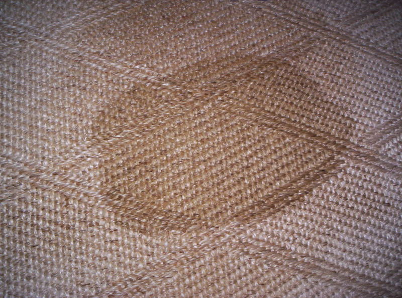

I have cleaned many, many , many sisal rugs and carpets. They are extremely popular in Southern California. The following pictures were from dog pee, but they would work about the same on vomit.
This is how it looked when I arrived.

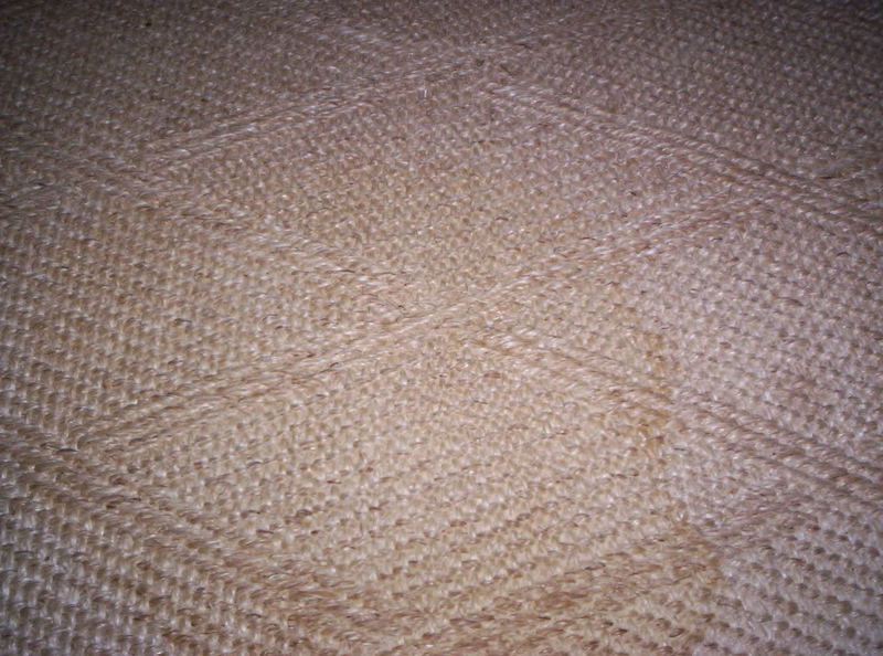

I worked on the spot for about an hour with HOST. The HOST got it to look like this.
I don't have a final picture. It must be on another computer. But I treated the remaining yellow with All Fiber Textile Rinse and it was gone.
A couple things. Sisal doesn't shrink as easy as the decorative border (usually cotton). Sisal can lose color when dealing with aggresive chemistry. If a strong reducer is used, be prepared to play with the color using a tea as mentioned above.
