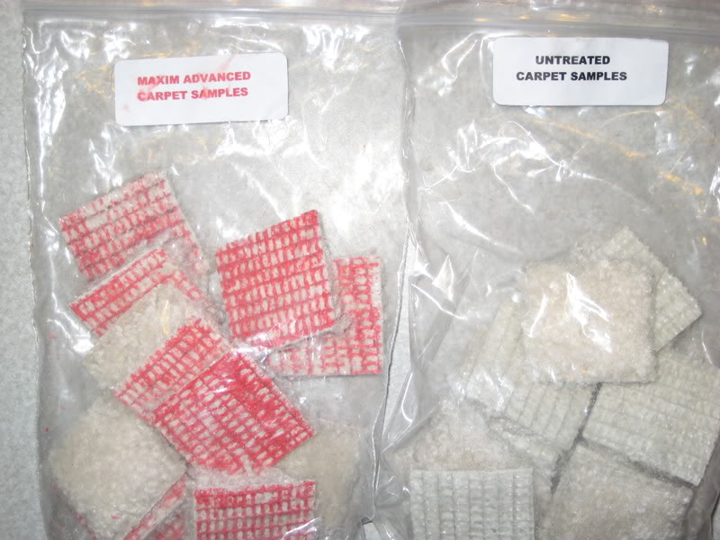

Normal I use the Maxim advance. I buy it by the case and they give you the free pieces of carpet protector and the Red dye. In the kit they have carpet that is protected and not protected. In my testing I used the factor applied maxim advance carpet pieces and on the one that is not protected I used the Stain Guardian from Pro choice. I mixed it as directed and let it cure.
For the test, I applied the red dye on both pieces and the maxim beaded up better. I let the dye sit on the carpet pieces and for two min, rinsed both pieces off and they both came clean. I applied the dye again and let it sit for 5 min. rinsed both of them again and I noticed the Maxim side has pink. I added the dye again and rinsed them again and more pink again on the Maxim side.

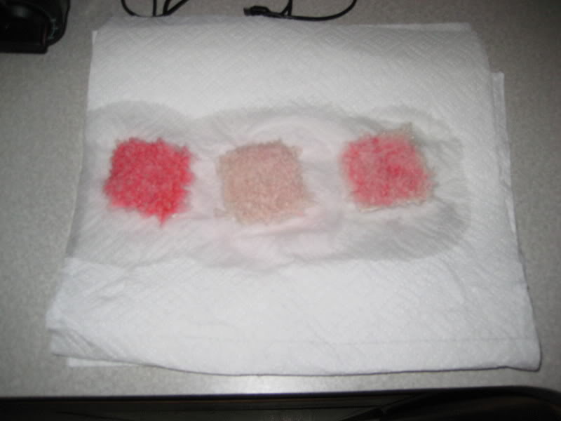

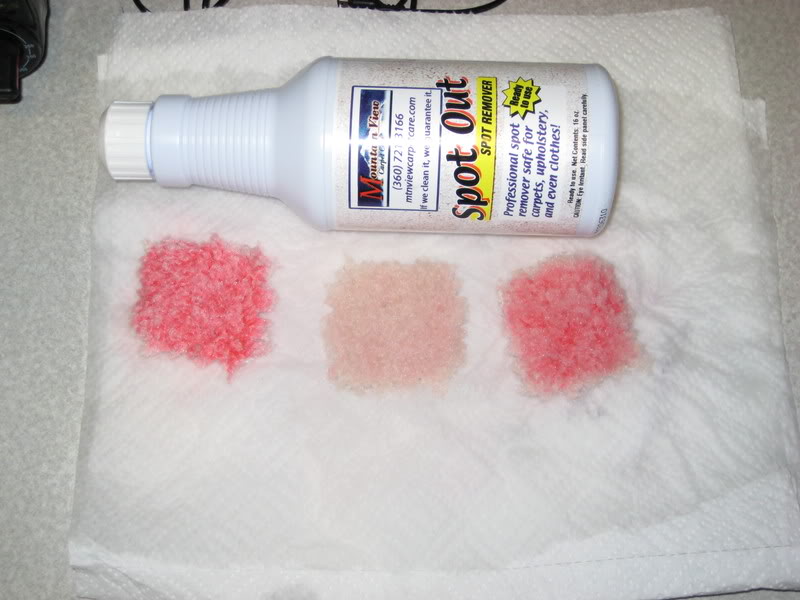

1.Maxim 10 application with the red dye
2.Middle Pro's 10 applications. Even hit the middle with really hot water to try and wash off the protector.
3.Maxim after two applications.

Curious did you rinse it with just water? Curious what a spotter would do. Thanks for doing the tests.
Just sink water with the sprayer. I'm treating a non treated one with Maxim advance to confirm I didn't have a bad batch of Carpet samples. Next someone will say that I did mix it right when it fails. :) By the book and 24hr full cure time.

The coated ones have the red backing and the uncoated ones have the white backings. I know next you guys are going to want me to show you that the ones that are turning pink have the red backings??
