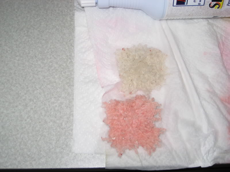

Apr 4, 2007
1,085
I rushed the curing time on the Maxim. Air mover all night. Test same red dye that comes in the kit and I have to say that my pieces of carpet was better then the one the put in the kit. This was after 4 dunkings.
Maxum on the bottom. Pros on the top.
I was going to film it but the kids are home from school today and you think I could get 15 min of quiet around here? :)

Chris Hagen
Some people, Greenie, say that people are getting defensive about this but I don't want people getting the wrong idea on a very good protector. I might not make it but I do sell it and back it's quality. These are test results I've had with Maxim Advanced.
and that is after about 12 rinses.
As I said it's good to see you testing these things but I didn't believe the results as mine were completely different.
