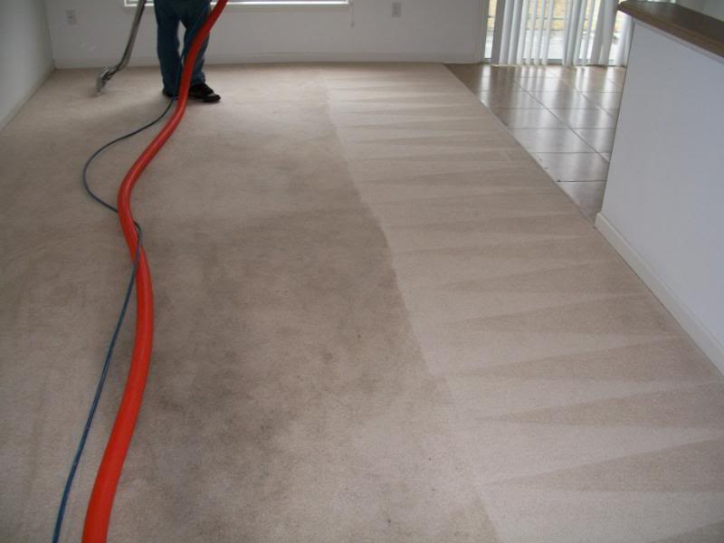

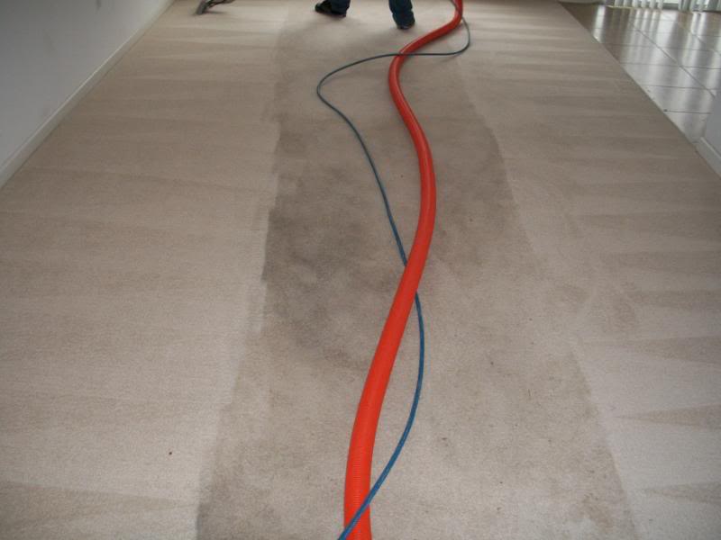

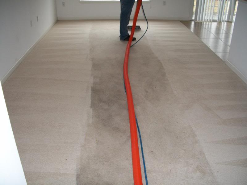

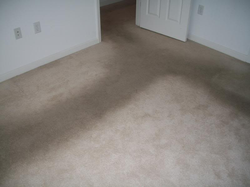

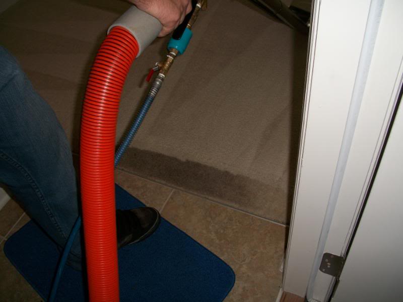

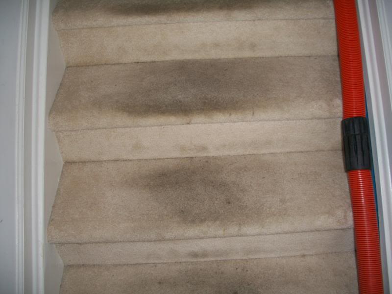

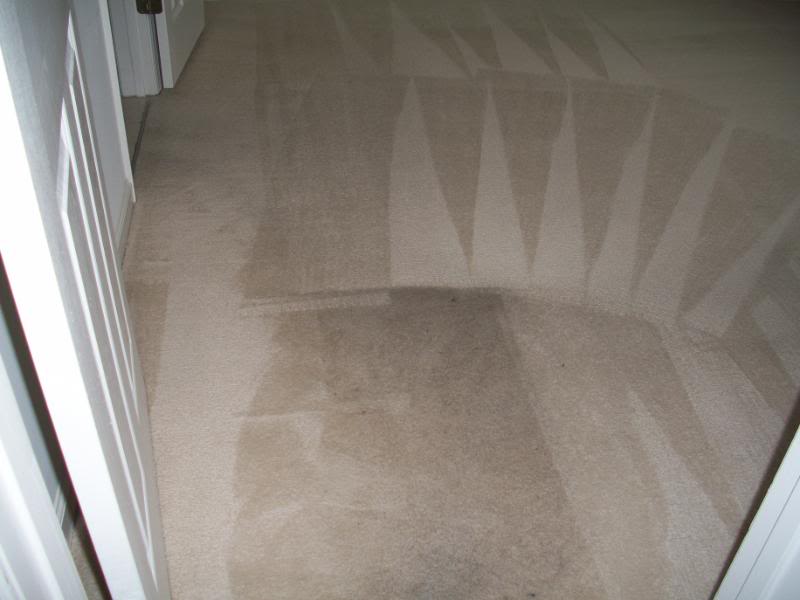

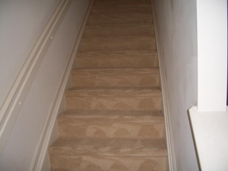

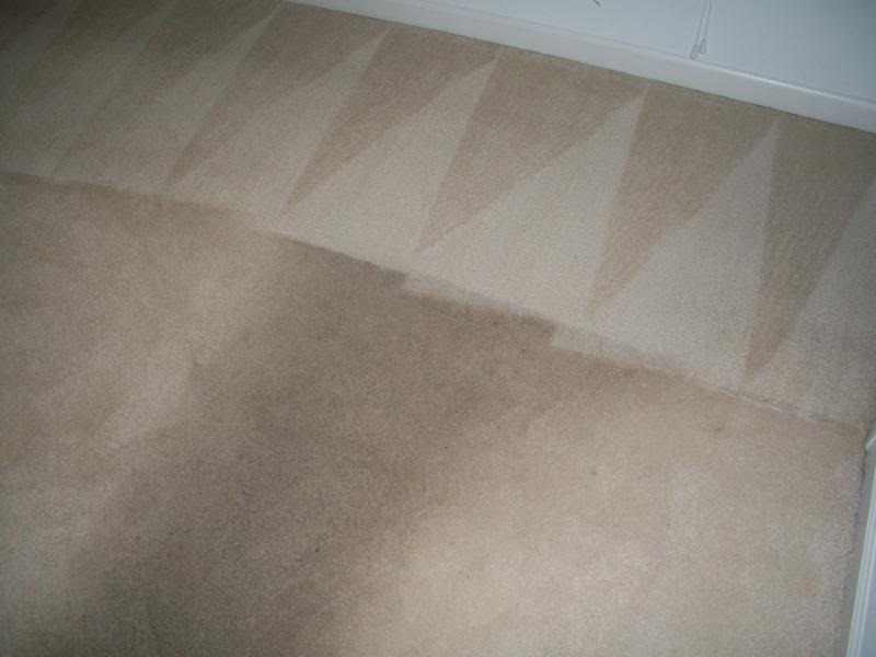

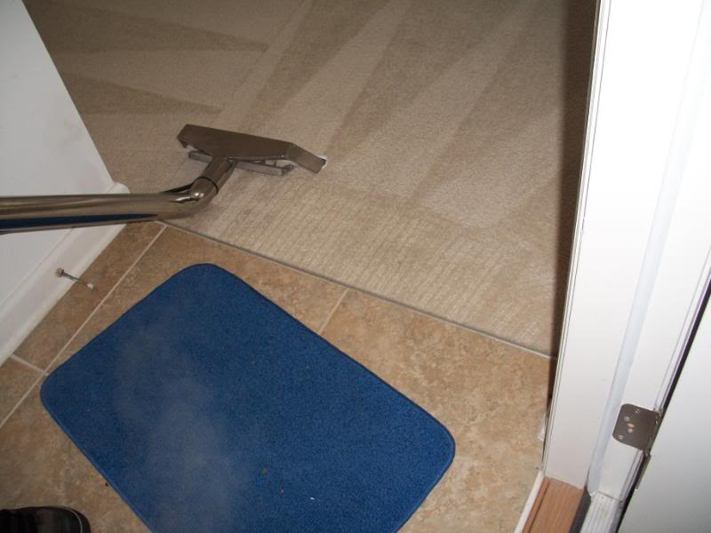

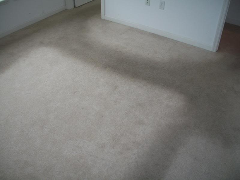

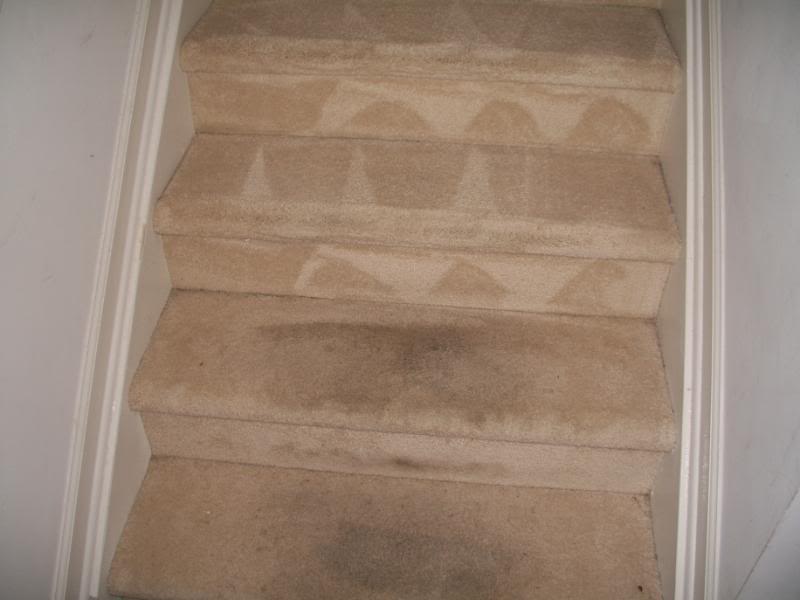

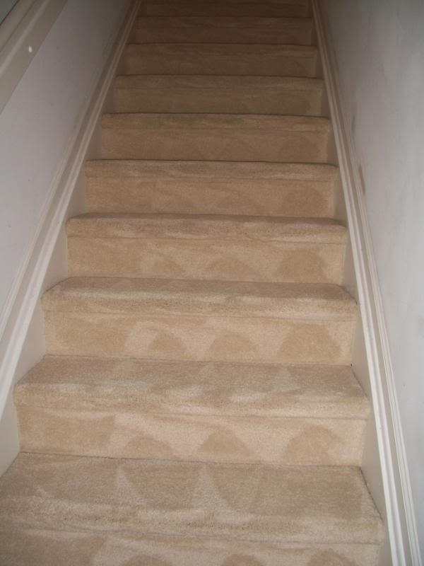

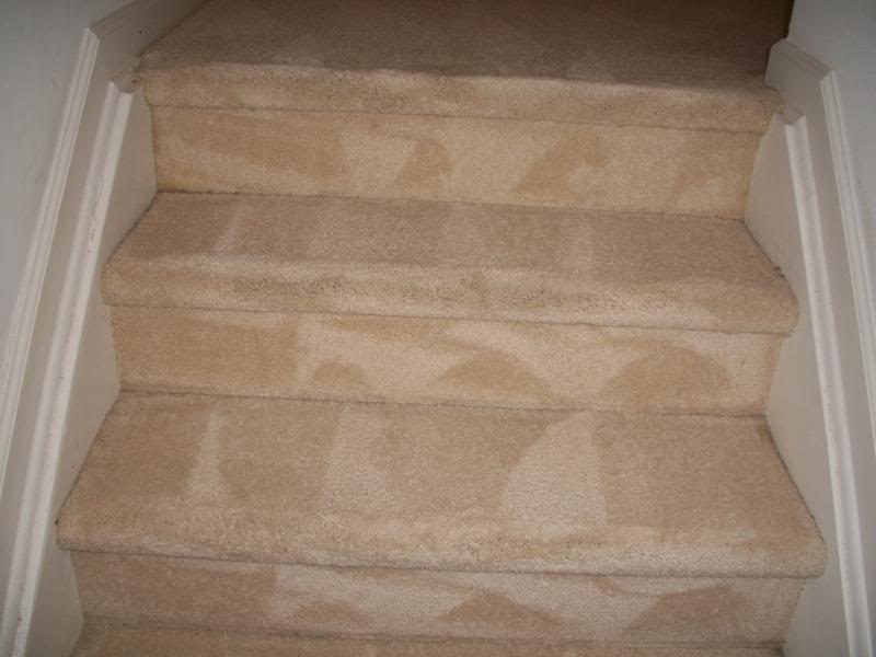

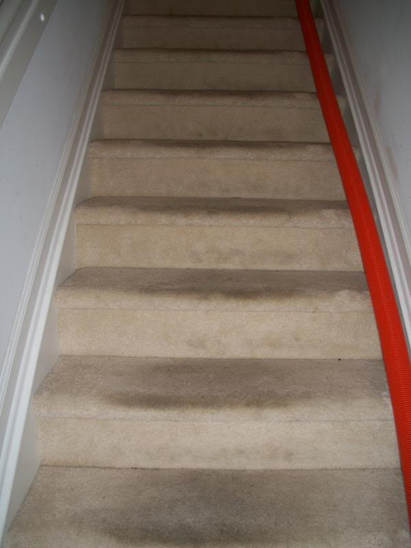

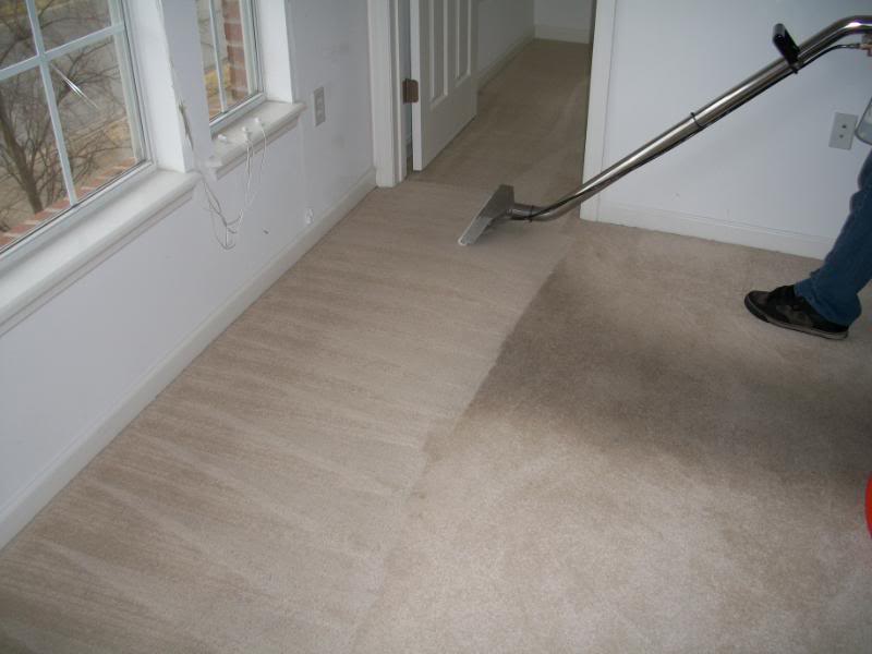

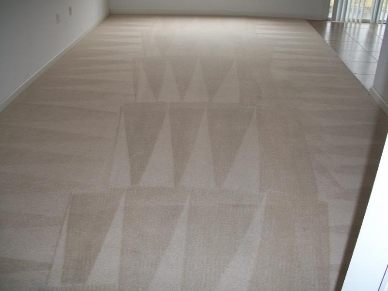

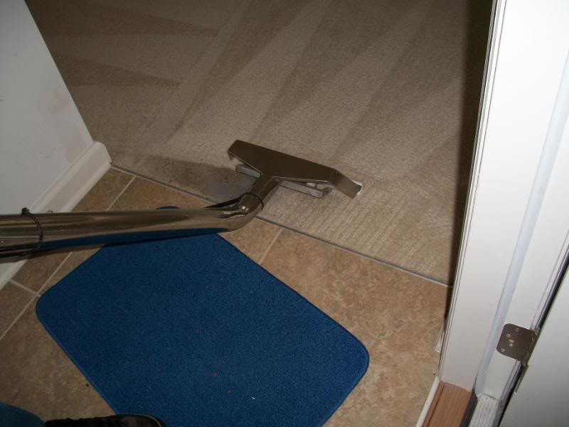

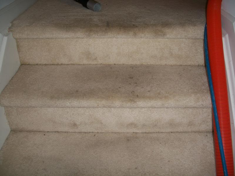

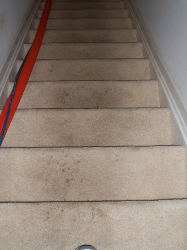

this was a short sale cleaning for one of our realtors..she asked
for it not to be raked so it would keep that just cleaned feel for the
caravans coming in the next few weeks..
we used cobbs powermax mixed a little strong and super hot..let it
dwell for about 15 mins and here ya go..
the job took about 50 mins and we charged 325.00

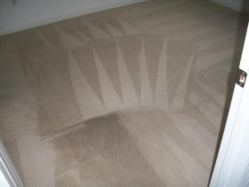

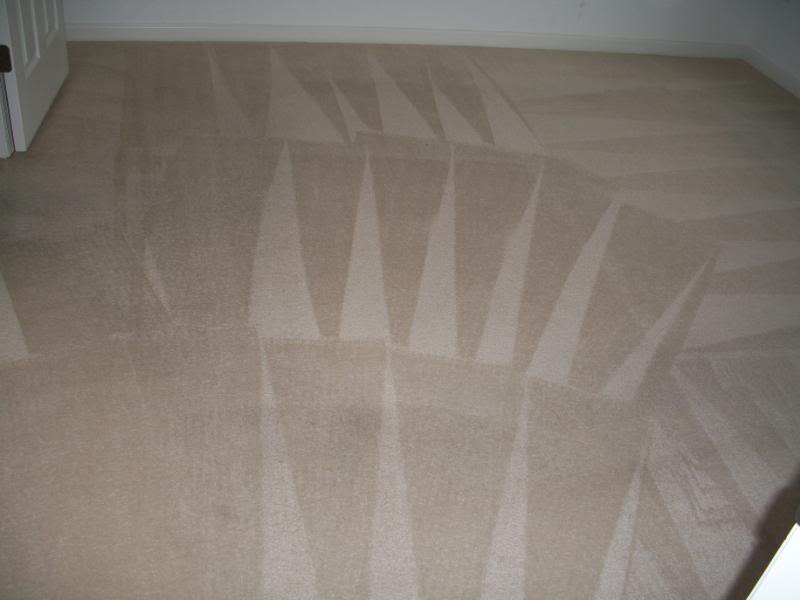

great job Dave! Pics look awesome. Why (on last room) did you not clean going out of room (all same direction) for a more uniform look? First time i seen someone clean both sides (in opposite direction) then go out thru middle.
A
Able 1
We call that dwell time..

Nice pics. what was the heat set at? Most of my apartment managers wont let su rake the carpet either. What did you rinse with?

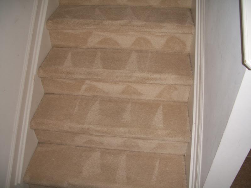

Great job, Dave.
Sometimes those stair noses can be a pain in the rear,
but you made them look like new.
50 minutes is also amazing.
Larry

thanks for the good words guys..
heat was at 250+ i run a butler with hi heat option and pimped out with all of the green ones toys
i rinse with nothing but ro water..it is the bomb to say the least!!! worth every penny
i charge.40 per sqft and 3.00 per step i usually give a good discount
for empties unless they are trashed then it is no discount but i NEVER
charge more for trashed or spotty carpet.
and yes you can buy a ro system from lowes or hd but as stated you will be
weeks making enough water to use..make the investment in cobbs unit and you
will be a happy man..less chems, no need for rinse chems, carpet actually
stays cleaner longer and feels softer and healthier and you can market yourself
with the ro water because so few people use it because they think it is too expensive.
if i missed any questions just ask them again there wer lots in the thread..

Nice job. Thats a neat carpet to clean....pretty common. I've gone into places like this, with filthy traffic lanes, and noticed that thay always seem to have a home carpet cleaner, using juice right off the shelf. Lots of residue left behind.
Did you have lots of soapy waste water from previous DIY cleaning??

not too much soapy crap just really ground in and dingy..
