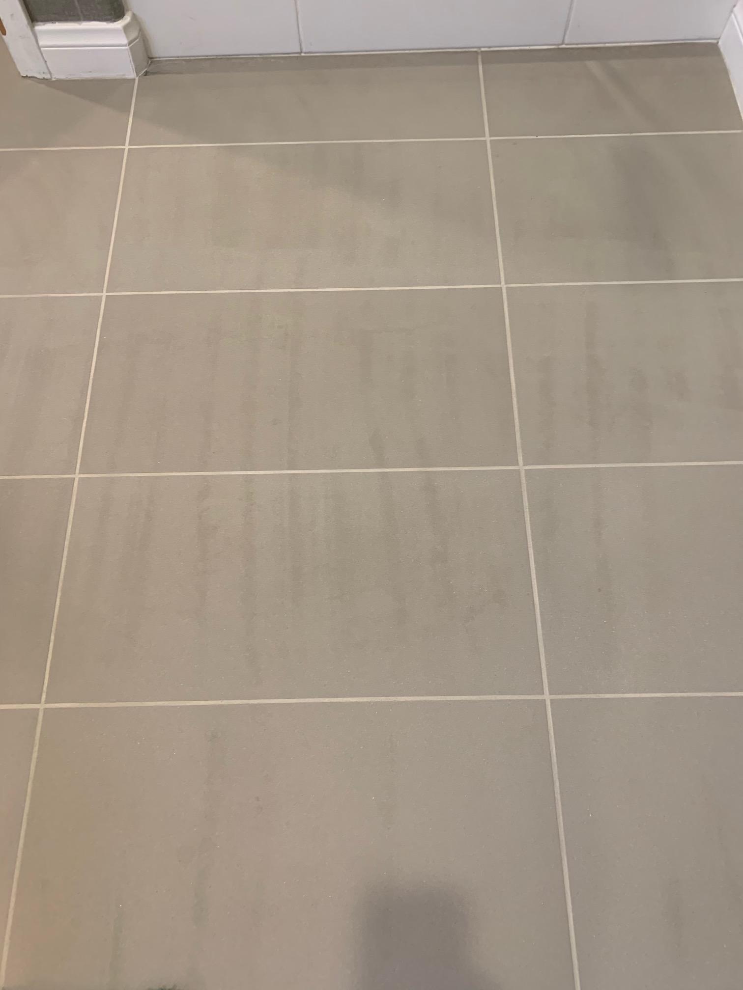

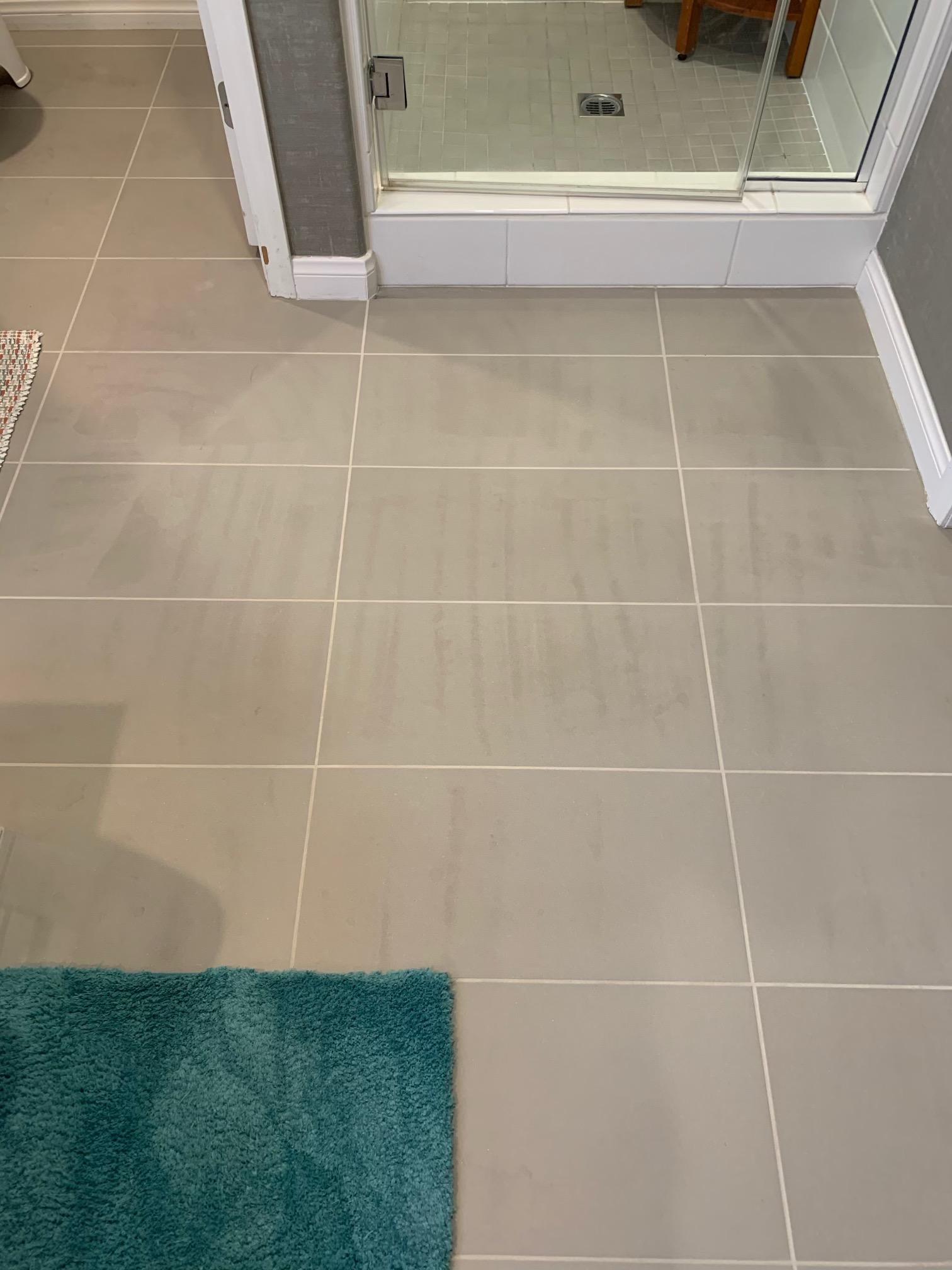

These photos were sent to me by an IICRC instructor who got them from a student who doesn't know what's going on
Porcelain.
Cleaned with a glided carpet wand.
Prochem professional alkaline tile cleaner.
Don't name names but really? Do they just let anyone be an instructor? 🙄

presume just needs to be rinsed properly?
or is there underfloor heating in that room?
Reactions: Willy P
14,646
Foot lotion not rinsed out fully?
And the fact that he used a carpet cleaning tool, and not a tile cleaning tool might be the cause also

Looks like he did a single flush stroke running an emulsifier and had incomplete cleaning where the jet patterns overlapped.

Soap scum residue from every time they get out of shower. Jets or glide holes removed in noticeable streaks. The dark area seen to match area by toilet. A rotary pressure extractor would not have left those lines.
