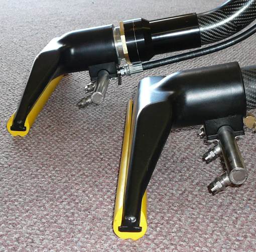

These two photos show the before and after "jet angles" :
The closest wand has the jets angled down about 10°, after the adjustable jet mod.
Mikey, you should appreciate this change.
Larry

Does the picture make the jets seem far away from the carpet and the wand meet? Looks like it is 3 inches in the pic.

I stared at the picture for about 5 minutes. Could not really see any difference except one wand has a fixed head and one is a swivel.

Greenie already fixed the jet angles on my Bentley when I bought it. It also had a Genuiine Green Glide on it. NO overspray, and the spray hits about 1/4" behind the glide.

No, it still has 4 jets and the original manifold. Greenie just "tweaked" it so the spray was hitting correctly. The way the manifold mounts won't allow for 5 jets, unless you do some modifications. (the mounting point is in the middle of the spray manifold)

Not sure how Larry sees that spray angle as "10degrees"?? Looks like about 30 degrees from horizontal. (Still much better than 90 degrees, straight down)

The original Mytee jet angle was adjusted for a ~10° change.
