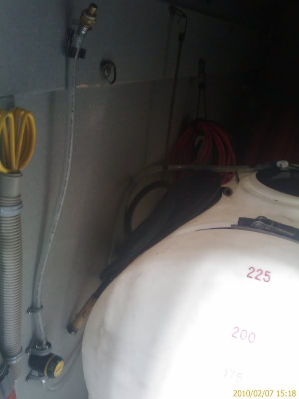

I can take a pic of my set up if need be. I have the CanAm which is the predecessor of the C4. The tank below mine was supposed to be the fresh water tank but I put in a 200gal tank. I ran the feed line directly from the pump into the tank with a filter on the end and a second line into the tank for the bypass. Been working great for over 18mths.

I'd like to see a picture of that. I'm considering putting this or an El Diablo into a box truck, but I want to be able to carry around at least 100 gallons of freshwater. Do you fill your freshwater from the front of the unit?

The inlet hose connected to the Cat pump
The bypass hose connected to the unloader (its the white plastic braided hose with 90elbow towards the bottom of the pic)
Both hoses run to the freshwater tank. A 1" drilled hole and the hose fits snug. The inlet hose has the screen on it, the bypass hose is simply open.
Just drop them in the tank and fill with water (yes, I know there's a bit of scum in the tank, was more till I cleaned it. Need to add some quat-a-lot more often)

Thanks! Do you fill the tank directly or did you run that hose from the front of the unit as well?

I used to have the hose with the quick connect go straight into the tank with an auto-shutoff. Unfortunately, our wonderful local gov't wants all tm's outfitted with a back flow prevention valve ($250 installed PLUS yearly testing) OR that the water outlet be above the level of water. So I rigged this up with a timer to prevent overflow.
The water hose connects with a quick connect (made for garden hoses), I set the timer for how much water I want, open the lid and let it fill. QED
