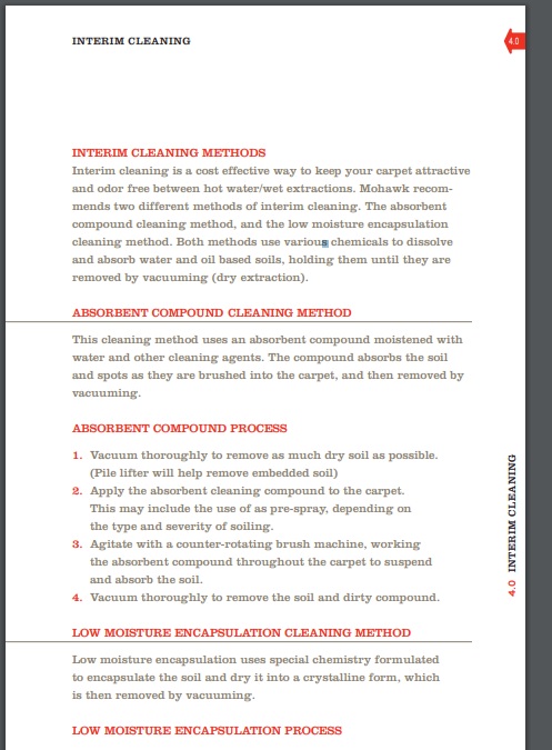

I will start encapping when carpet manufacturers recommend it. Which is.............................never.
18,851
Lee Stockwell
Empty most of the soil load with hwe.
Put the lid back on it with encap.
Cash the check. REPEAT
**commercial interim
