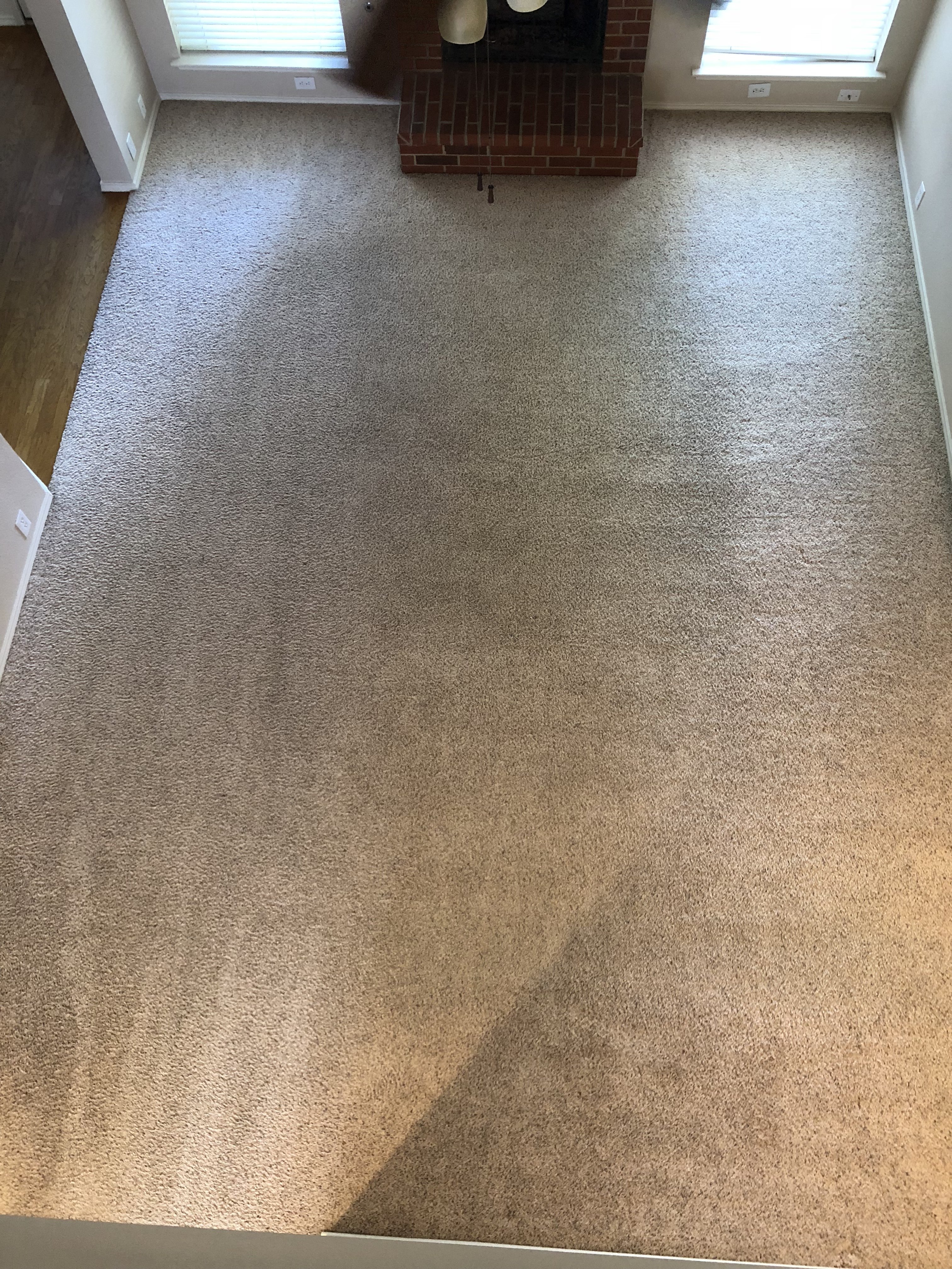

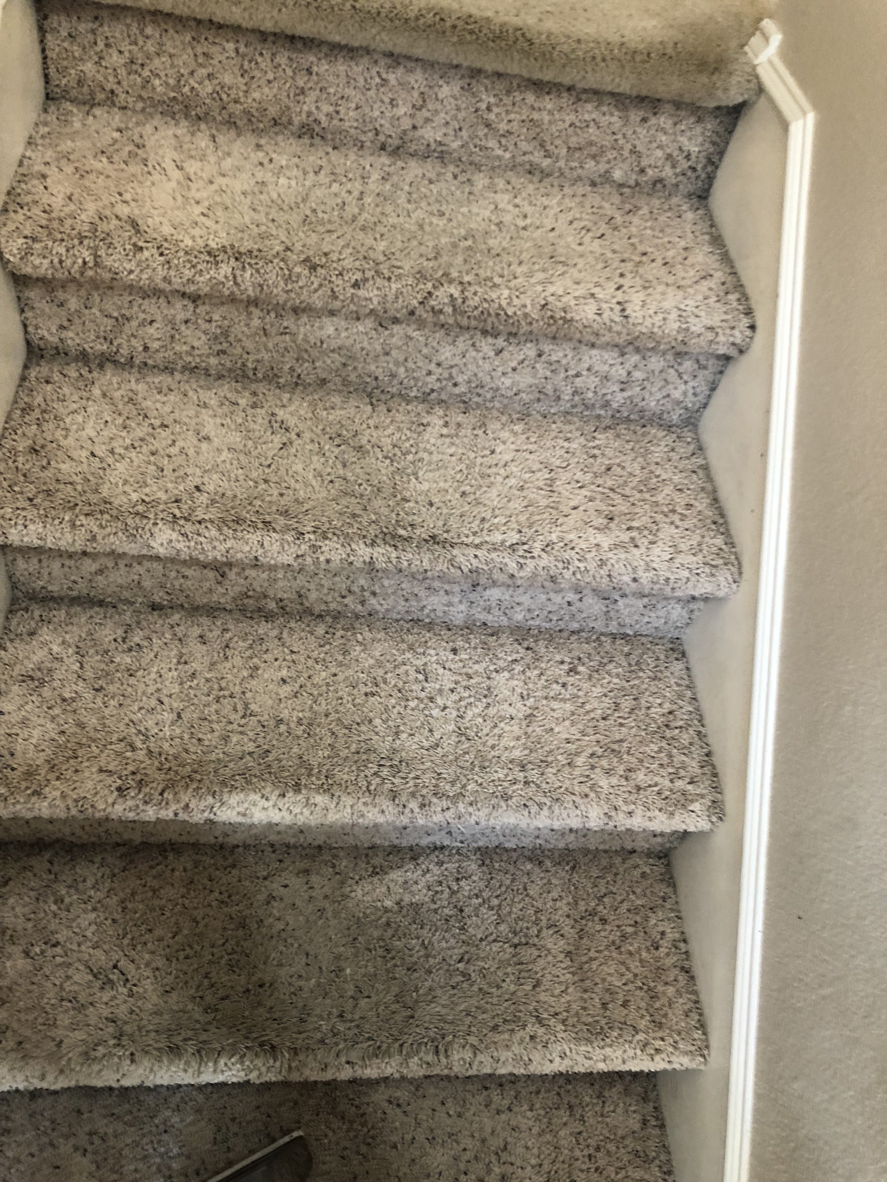

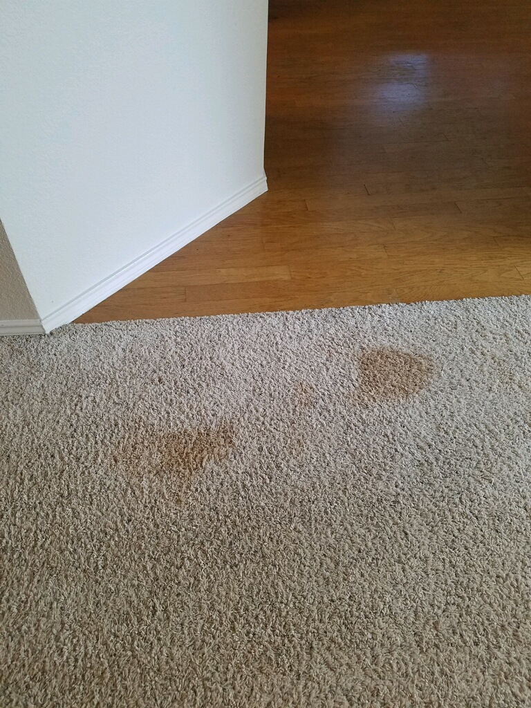

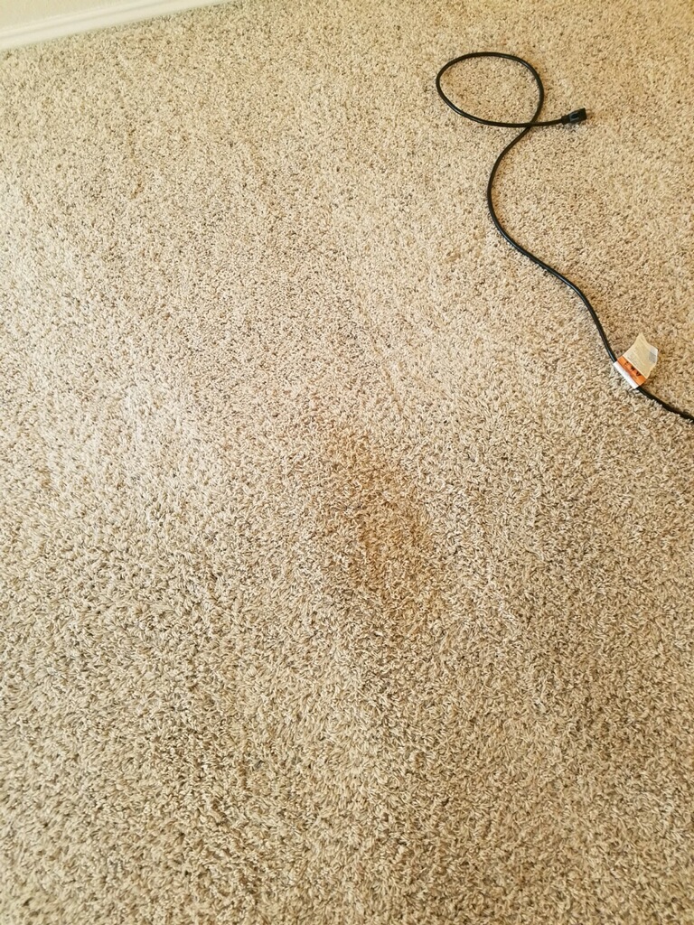

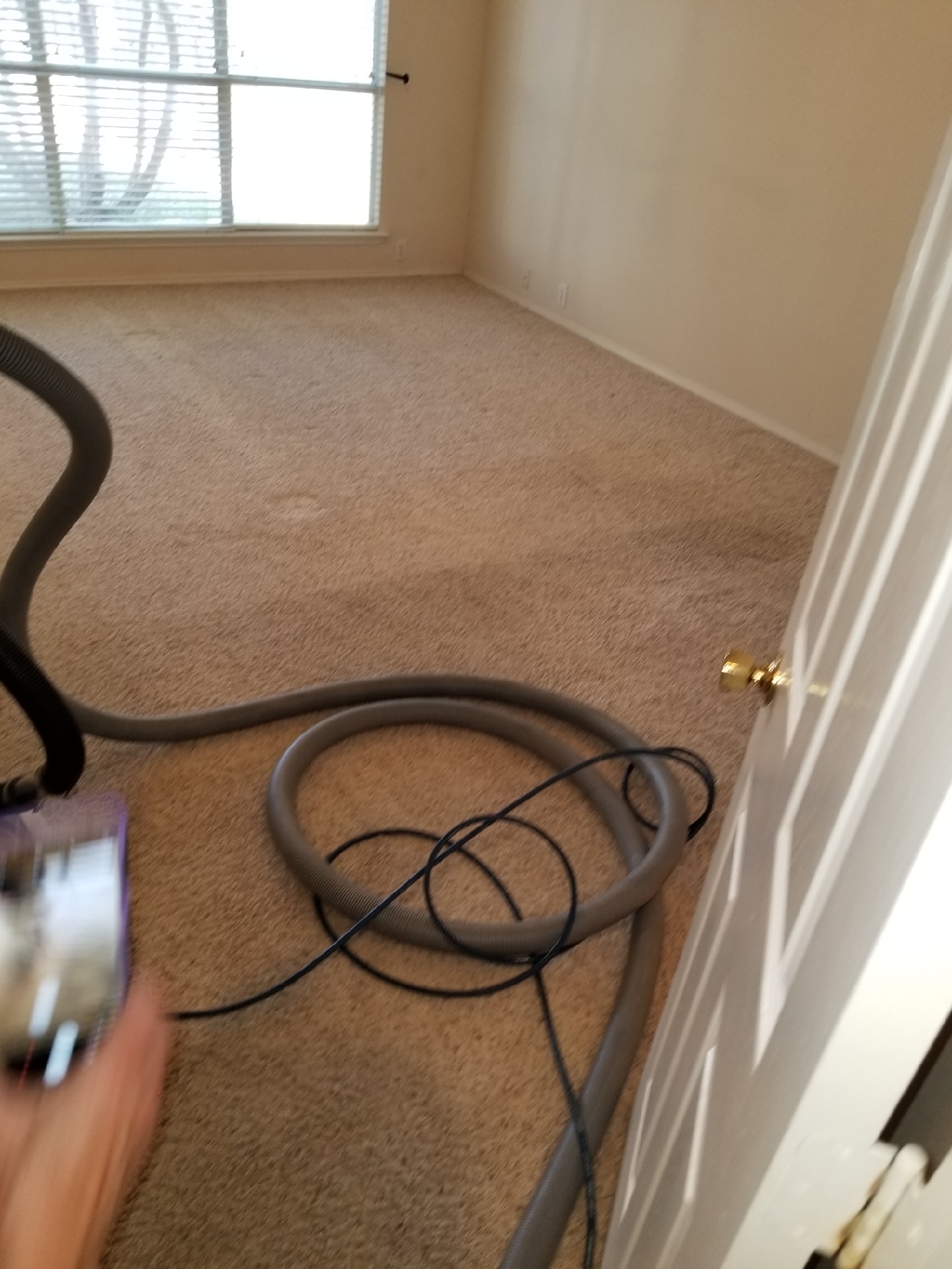

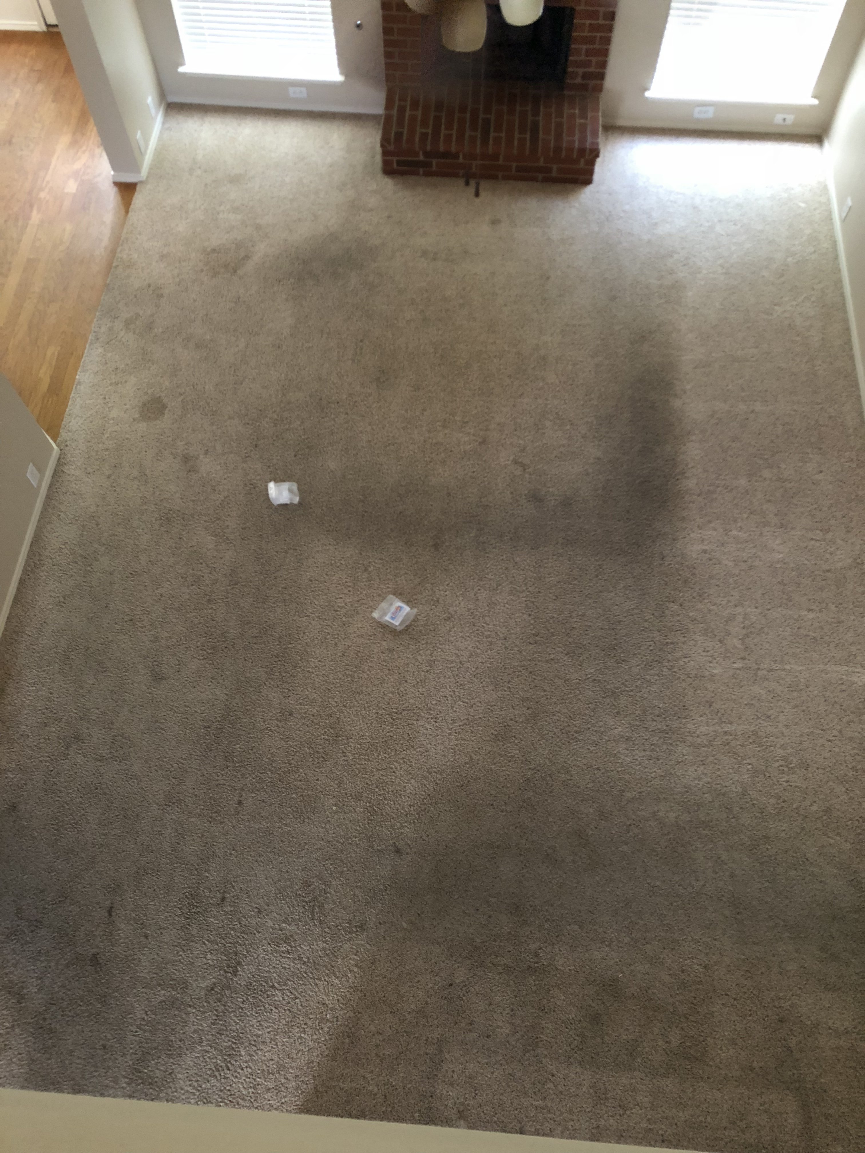

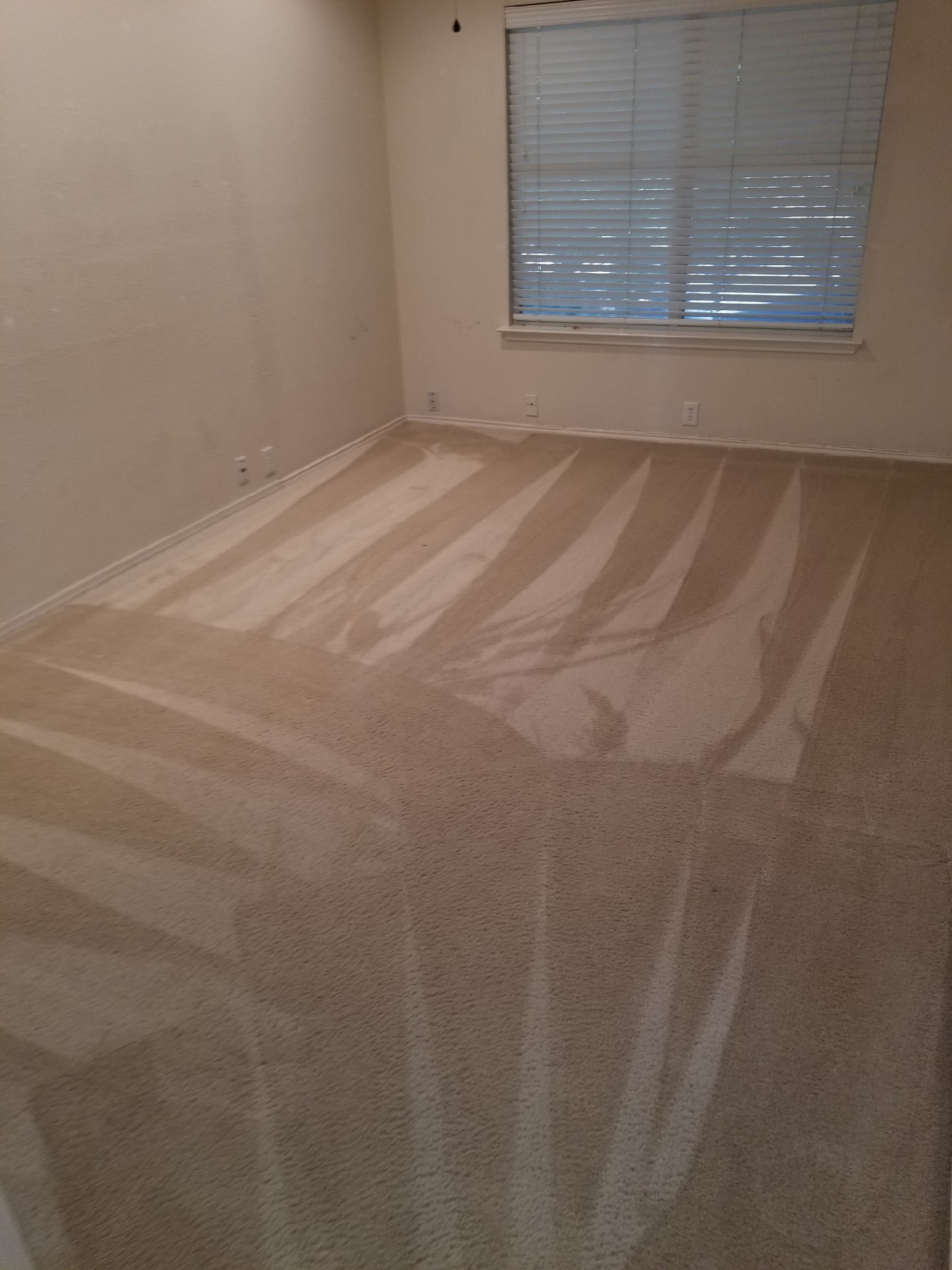

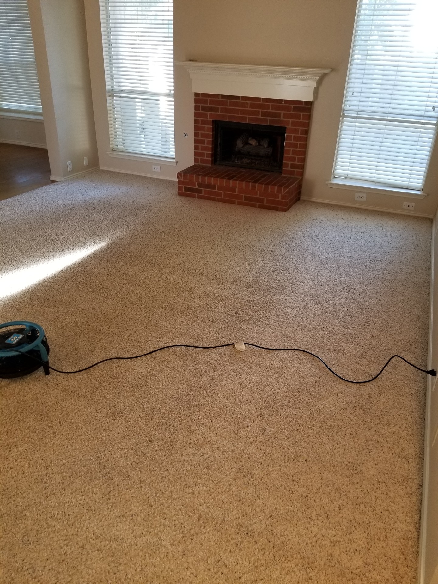

Haven’t Had a redo in years.
But this thread comes up and boom a damn redo!!!!! CBC88D09-DEA3-4736-AAF6-DAD3F7E0BDCB.jpegF3E3A193-8B69-4A21-BCF2-55F625D01127.jpeg9C25216F-DCF5-4C4E-9EA7-01777A8FFE9F.jpegF3E3A193-8B69-4A21-BCF2-55F625D01127.jpeg9C25216F-DCF5-4C4E-9EA7-01777A8FFE9F.jpegCBC88D09-DEA3-4736-AAF6-DAD3F7E0BDCB.jpeg

Looked great when I was done.
Then this happens next day.
What would have you have done to correct?

Think back I should I should’ve just mixed some all fiber rinse in a spray bottle 1 part all fiber to 3 parts water and just ragged it out.
Pretty sure that would have worked.

I’m thinking it was some of the gallons of either guini pig piss, cat piss, or dog piss as they had all and at the same time.
Surprisingly enough there was no foul odor before or after completion of job.
I just burned through the spots with some peroxide in a sprayer bottle. Spray let sit a few minutes and wipe excess away.
