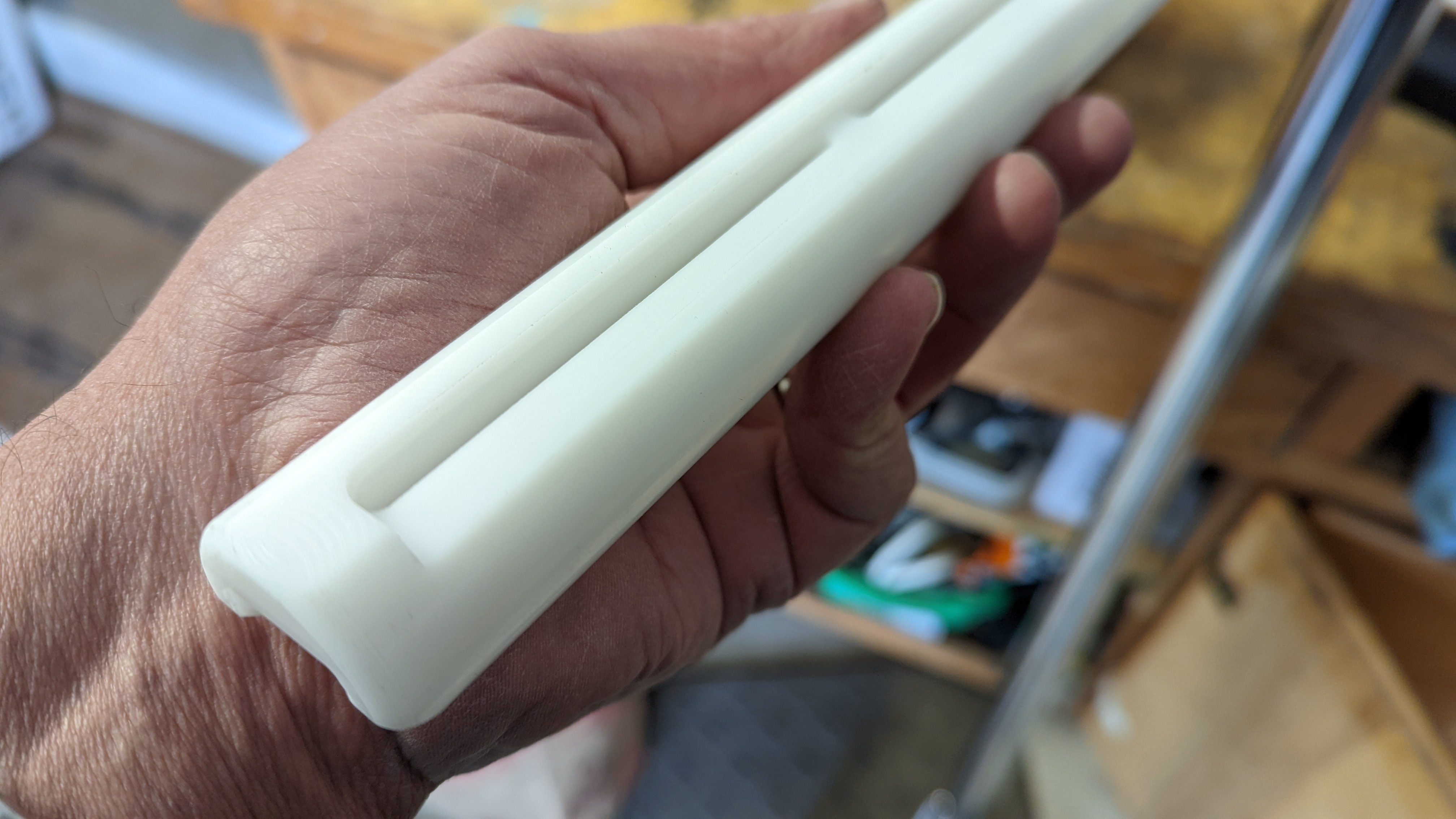

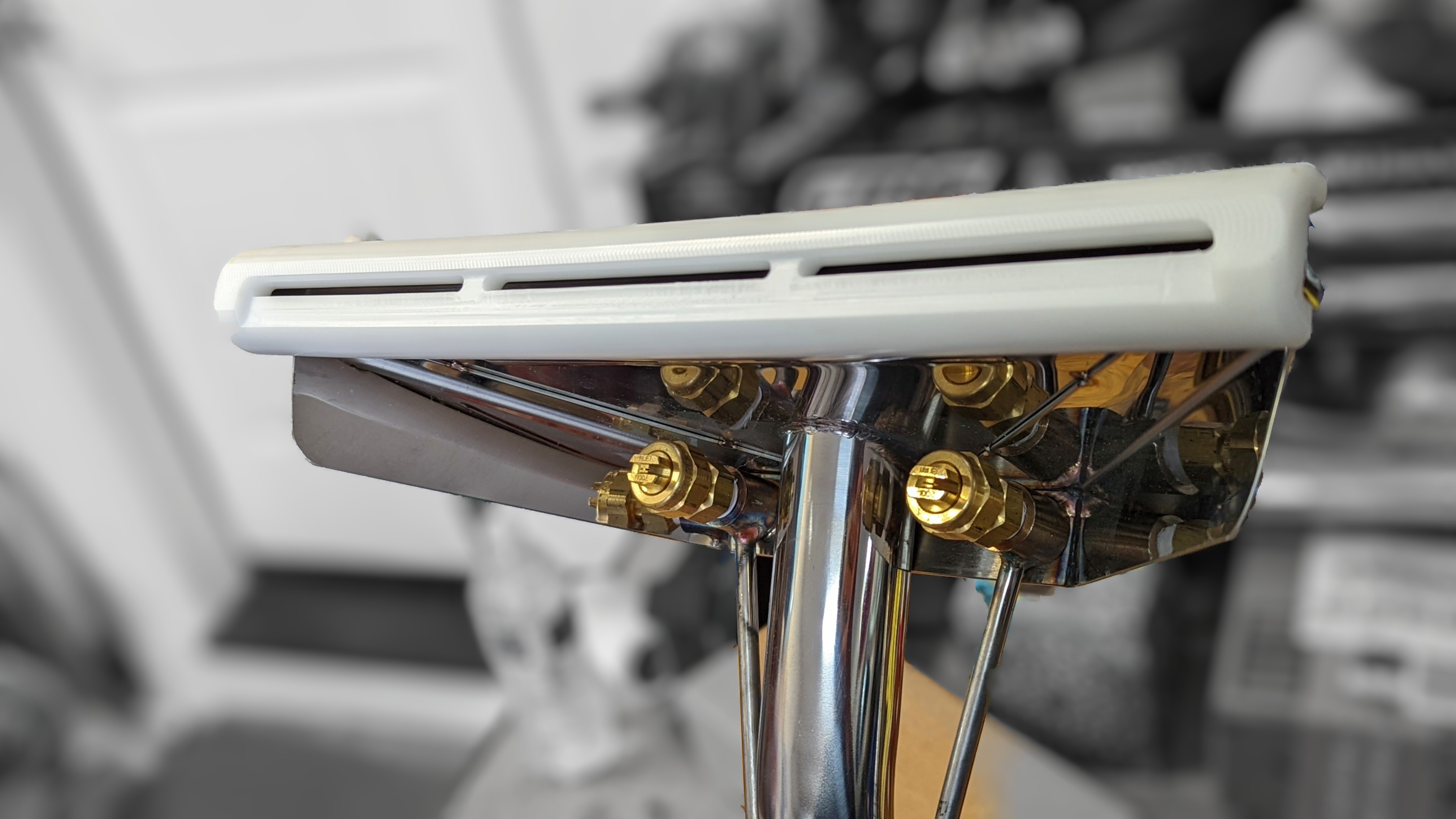

that glide looks weird. WHy'd you design it that way?2G way to save 1000s in tufting costs to see if the AW has what it takes to slurp water 18th off the floor..
Im brilliant.
good griefs, read what I typed with your fingerthat glide looks weird. WHy'd you design it that way?

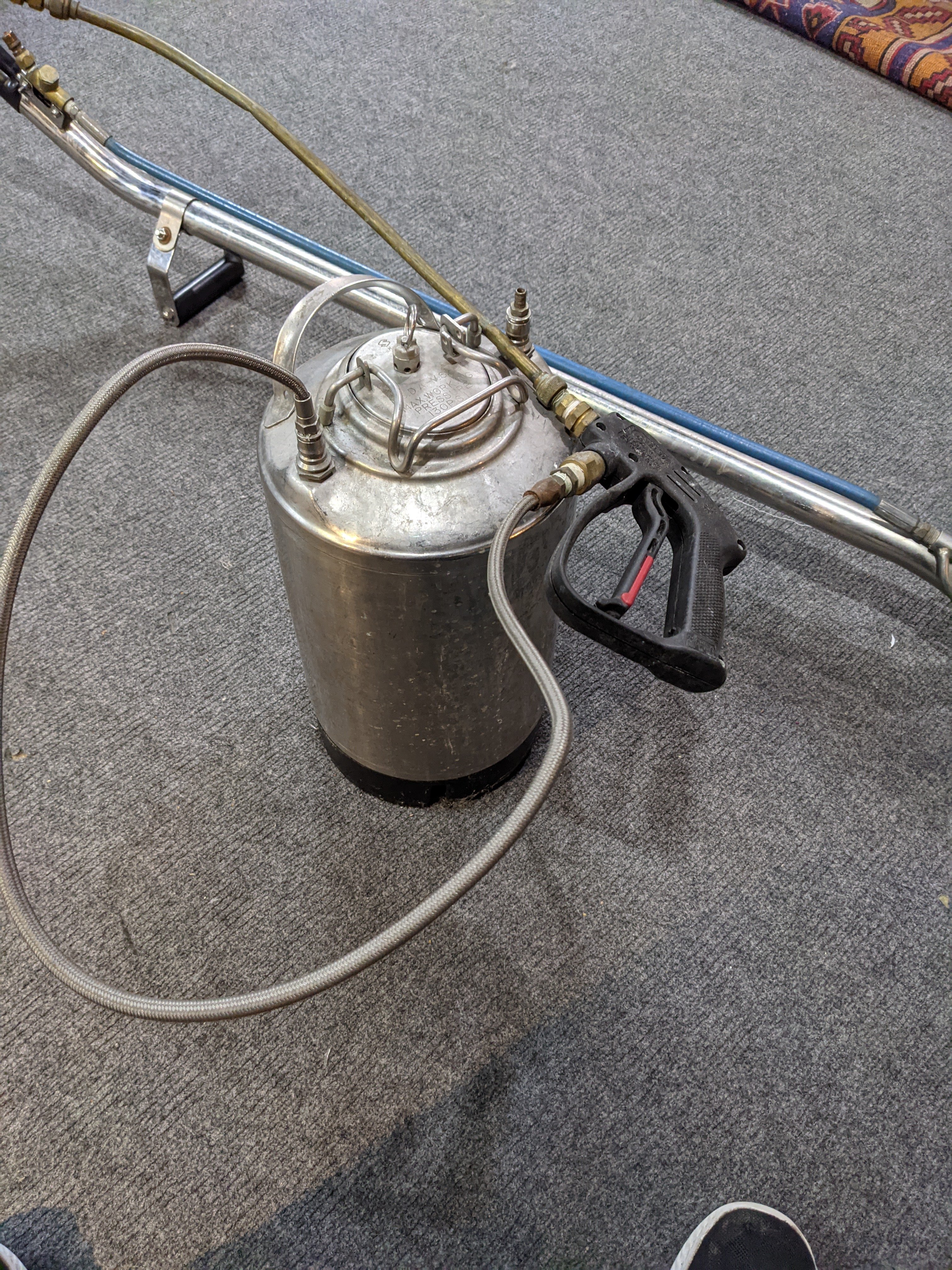

Pepsi sprayers
Kunckle valves
Greenbean wands
02 orange juice pee water
400 ft of 14 to the door hose runs to reach 90ft from the truck to farthest room
Light duty hose that kinked if your TM had more vac than a porty
et al...
We don’t need a visual.. ThanksLooks more like Vawter to me
The Fook kind of fittings are those?
The braided hose is a refrigerator ice Maker hose that happened to have to correct fitting for the adapter on the bottle. The other fittings are from my 30 year collection of misc fittings. Whatever works. I use that for water based protector only. I have both a 120 volt compressor that I bring on the job for large jobs and a 12 volt compressor that plugs into my truck.The Fook kind of fittings are those?
Looks like a Schader valve on one side.. and a cobble of fittings on the hose side..
How did you make it fit though?
how much psi in them? The Pepsi sprayer…The braided hose is a refrigerator ice Maker hose that happened to have to correct fitting for the adapter on the bottle. The other fittings are from my 30 year collection of misc fittings. Whatever works. I use that for water based protector only. I have both a 120 volt compressor that I bring on the job for large jobs and a 12 volt compressor that plugs into my truck.
The relief valve pops off at 130 psi. Didn't I sell you my 5 gallons ones? They were great for large jobs.El ‘Juan-dough….’ That’s my Nick name from my helper..
I’m going to be using them for the up coming casino job. It’s an 8 hr push.The relief valve pops off at 130 psi. Didn't I sell you my 5 gallons ones? They were great for large jobs.

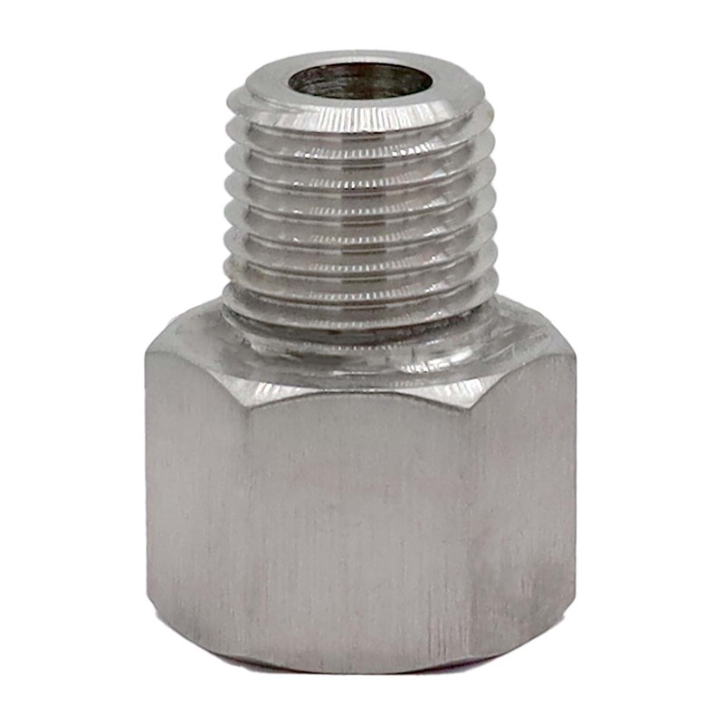

I searched and searched and found these..The braided hose is a refrigerator ice Maker hose that happened to have to correct fitting for the adapter on the bottle. The other fittings are from my 30 year collection of misc fittings. Whatever works. I use that for water based protector only. I have both a 120 volt compressor that I bring on the job for large jobs and a 12 volt compressor that plugs into my truck.
Mine are all properly screwed on. The only thing that restricts you from spraying solvents is the seals. You need a gun with viton seals and a viton seal under the main cap. Pretty sure mine is just rubber.I searched and searched and found these..
1/4" MPT SS Adapter Plug for Cornelius Kegs
1/4" MPT Stainless Steel Adapter Plug for Cornelius Kegs. These adapter plugs will replace a plug (also called posts) on both the gas/in and liquid/out side of ball lock or pin lock Cornelius brand kegs.www.kegoutlet.com
I’m not going to run a hose barbed fitting and have the same sh!t that happens to others with the hose breaking or flying off.. Put an on/off valve right before the hose so you can not keep the hose pressurized when not in-use..
You can drill a hole in the lid for a metal Schrader valve..
I want a dedicated solvent sprayer and moth deterrent sprayer for rugs..

Does it make the angle of the wand more flexible so it doesn't have to stay at a specific position to hold a good connection to the carpet?
This is a mock up for the hard surface version to see if the wand will extract with the vacuum orifice 1/8 in off the ground...Does it make the angle of the wand more flexible so it doesn't have to stay at a specific position to hold a good connection to the carpet?
So mean.Meaning you're going to hire worthless neardowells to ruin your client base too?
He might be around 5' tall. That was his first 20min in that pic. As the day carried on, he got much better.for carpet?
get rid of the glide and no one between 5' 6" and 6' will have a problem
side note, Jaun is going to die a slow death on the wand if his posture doesn't improve.
and how tall is he?
So basically the tufts leave more water than desired. Not a complaint. But it is what it is.This is a mock up for the hard surface version to see if the wand will extract with the vacuum orifice 1/8 in off the ground...
Huh?So basically the tufts leave more water than desired. Not a complaint. But it is what it is.
