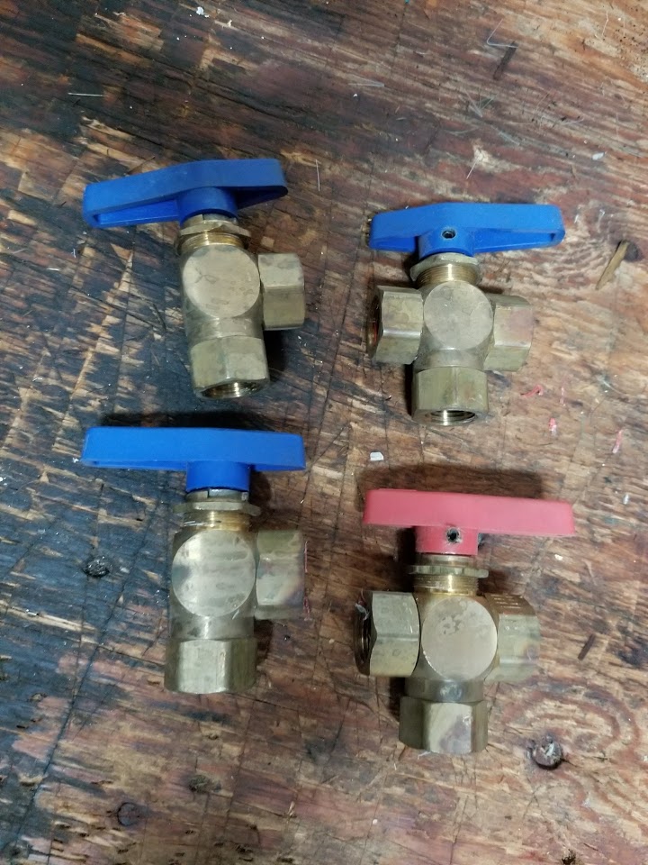

I think all truckmounts should come with a three way valve for switching from an alkaline to an acid rinse..
The AT came set up, I made one for the V and I'm going to copy the Pemberton creation on the new Everest..
If I ever go full time in NV, I'll follow suit

I’ve got a simplified version on my Cleanco. It came with a 2( or 2 1/2 gal.) rinse tank. I found it would run out half way through on most bigger jobs. It took me all of a week to come up with something better. I added a 5 gal Prochem jug for alkaline, and I added a 20 gal for acid. I just extended the rinse hose. When I need acid, I just put the hose into the 20 gal, when I need alkaline, I just put it in that jug. Works very well.

I like it, I generally only run 3 rinses. A acid prob 80% of the time an ammonia about 15% on white trash hell holes and a acid based encap on fine fabric
Nice! :cool:
I remember back in the day the Bridgepoint Lancer had dual draw. I always wondered why the Prochem units didn't back then. Prochem was building the Lancer for Bridgepoint. :headscratch:

One draw tube two 5 gallon rinses. Acid and emulsifier or off for soft water.

If you remember correctly...I did this years ago on my old Vortex when I was changing everything around....I have some extra valves left over if you want any....

I wish I had the selectors as well. Constantly switching between resi and commercial of varying degrees of dirty. I would be happy with two jug holders on the machine and swapping the hose between.
