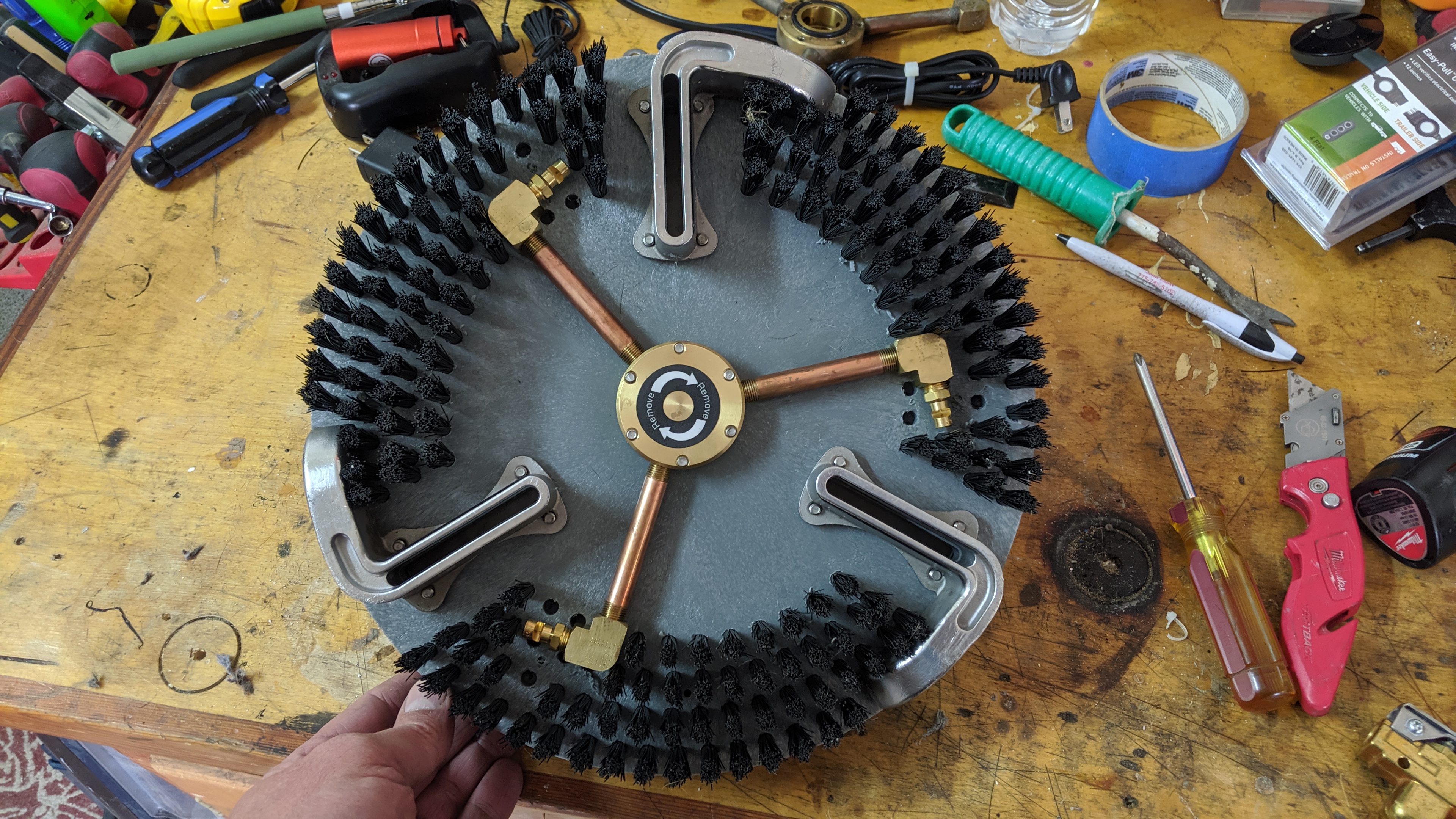

Final version with custom brush deck plate supplied by Rotovac
Thanks to @Loren Egland for the inspiration

Give them credit for actually listening to carpet cleaners.
The new style brush head will be such a big improvement over the old style that has been used for years. It is nice Rotovac listened.
They evidently didn’t agree with all my take on jet placements. I would have cheated closer to the vacuum pick up rather than get as far away from the vacuum shoe as they could. I placed mine about in the middle of the vac shoes. If I were to do things over I may have moved the jet right next to the vacuum pick up. Less time allowed for the water to sit before it is extracted so hopefully leaving carpet a little dryer. However, the thinking may have been to obtain more brush agitation with wetter fibers hoping for a little extra cleaning performance.

Looks a lot like my Mytee brush head now. I think it has 5 jets. Now I need to look.

How did you accomplish this quad with brush design?
drilled the holes with a drill press and stole the bristles from a regular brush head. The bristles next to the jets are placed so that on a long nap carpet the spray pattern is maximized. When being used the bristles bend back a little and the spray basically hits the bristles.
