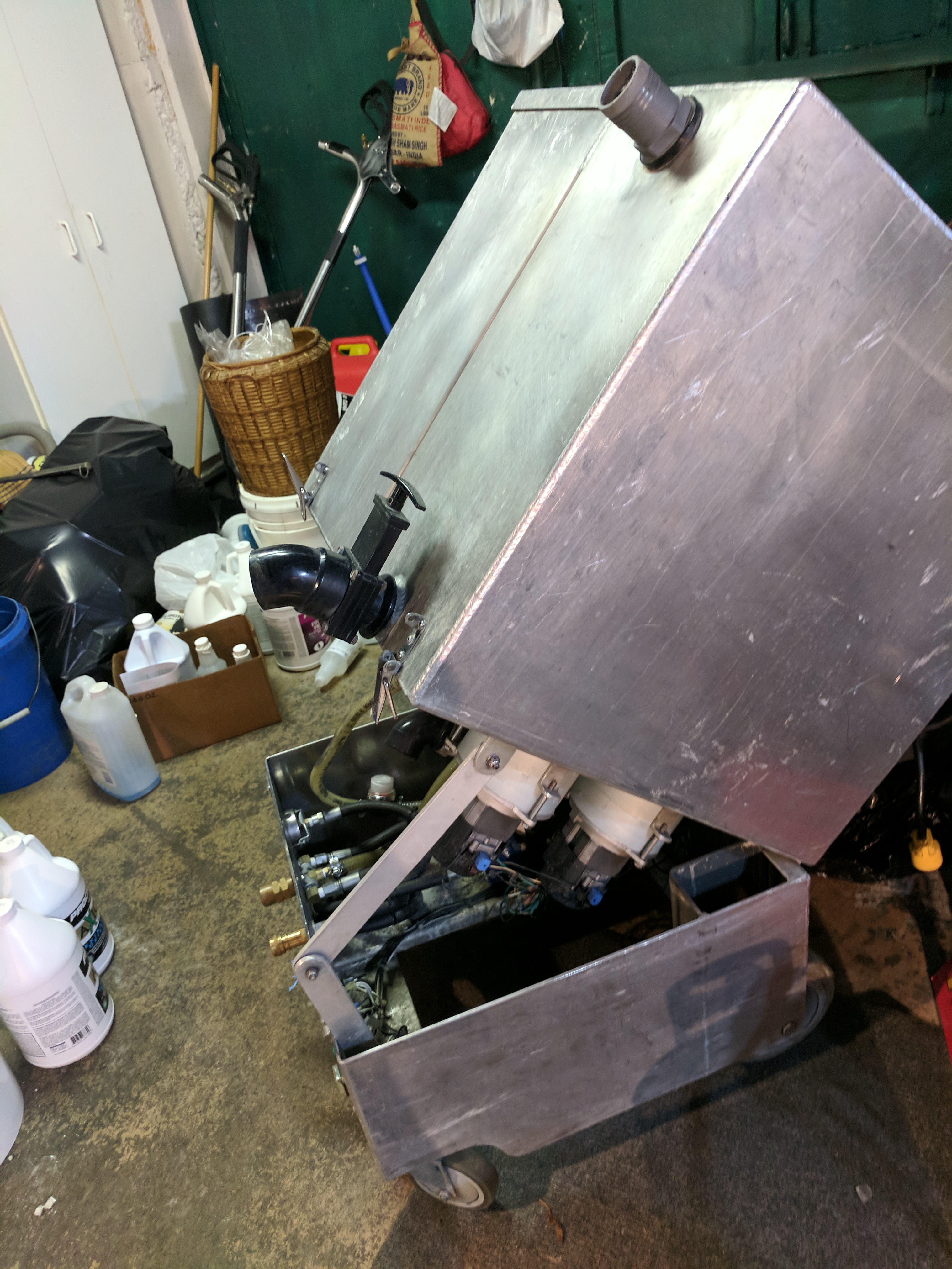

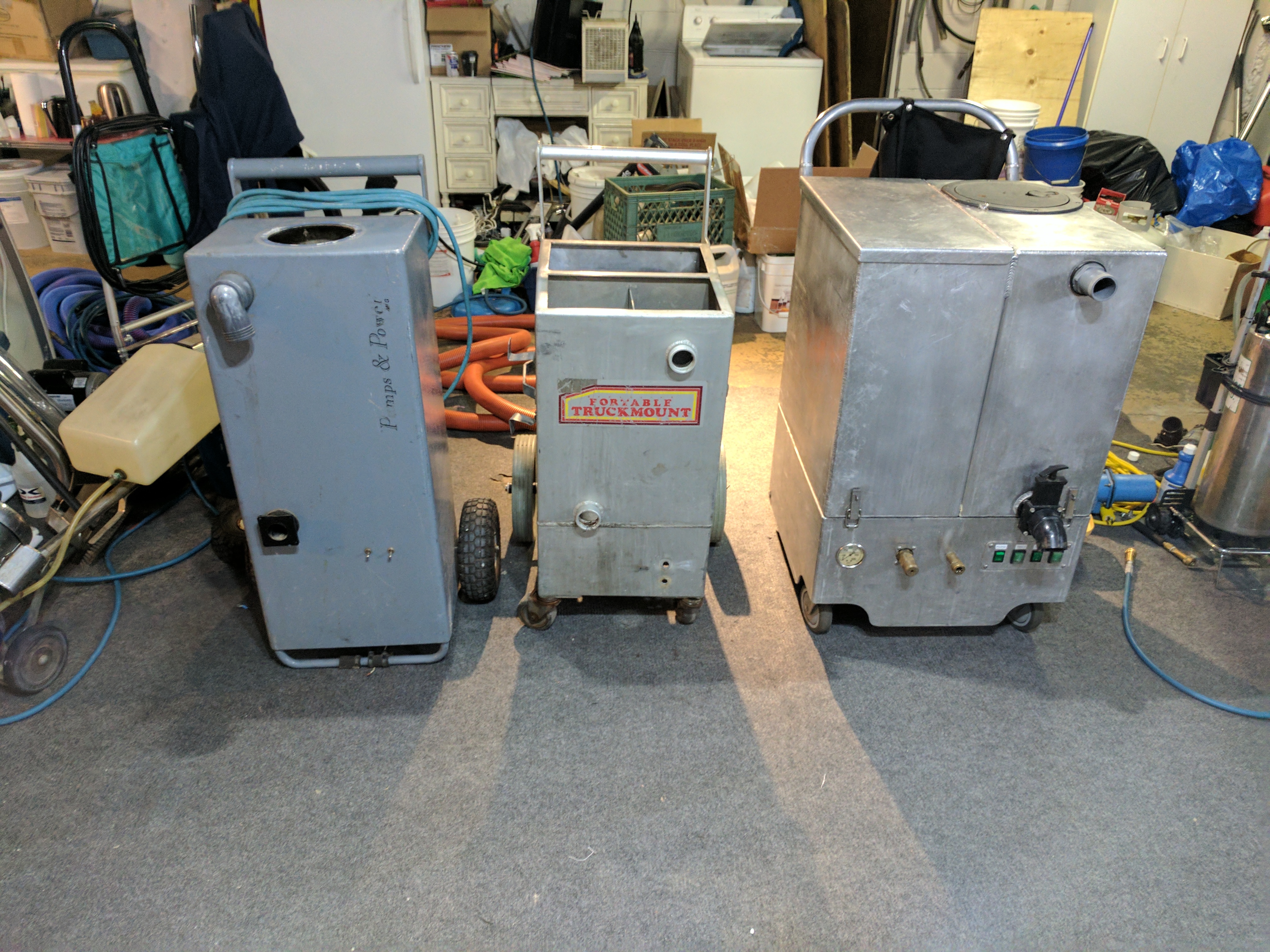

I only have 4 working machines and 3 empty shells.

They all have a different purpose. I have an old ninja that I put a high pressure pump on top of and use for hard surface floors. An 17 gallon single cord NSS rustler that I use in low power buildings or for upholstery. A modified Mytee speedster for small jobs in highrises and of course my Cleanworks Monster 24 gallon beast that is my main machine for highrise condos. I think I like collecting machines more than actually cleaning carpets. Also have a sprayborg, 2 Cimex machines, a couple of 175's, a spare truck mount, and tons of misc. Accessories and parts. Now if only I had some employees and the work to go along with it.

Got pics .. Id like to see.
