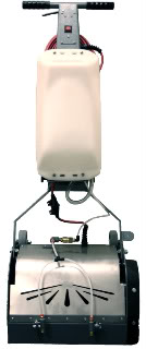

I just got off the phone with them. It seems that the cylindrical type equipment is what they're going with now on Mohawk carpets. They are big believers in encapsulation though and highly recommend it.
So I guess the good news is encapsulation is getting more recognition, the bad news is we may have to be more selective where we use the Cimex. The challenge is, how often do we actually know which mill made the carpet we're cleaning? I'd still bet though if the Cimex is used correctly it wouldn't ever be an issue. But, better safe than sorry if we're concerned about having a warranty issue.
Jeff C
H
harryhides
My Cimex has 3 small, thin cylinders encased in one large and thin cylinder.
Do you think it will have enough of an impact that we will see the cylindrical machines rise to prominence?
I've hesitated from buying one because they look so simple that they don't appear very professional.

What about the Whitaker Lomac? Is the Sprint comparable?
What about one of Clark's machines, does anyone own one?
It looks much more profesional.

That big ass crb from Clark is mean, and loud. Gears are easy to change and cheap, get a few. Too big for furnished residential work. Our has a high pressure spray system, we run a hydroforce inline and use it to spray and scrub large areas.
Yea Jess that's the part I like "mean and loud", we would use it strictly for commercial carpet.
How does it compare to a Cimex for effectiveness and production?
Greenie
You think Clark's beast looks more professioanl than a Whittaker machine?
Personally, I like the RotoWash machines, have one for the house 10" brush I think? has a tiny gravity tank, and small mechanical waste tank, very cool for touch ups, and grabs hair and pile lifts like no tomorrow, a must for pet houses, vacuum cleaner can't touch it.
I don't like the looks, but the others look really janitorial, like anyone could operate it.
Clark's looks like a beast the would required a professional to operate. :?:
