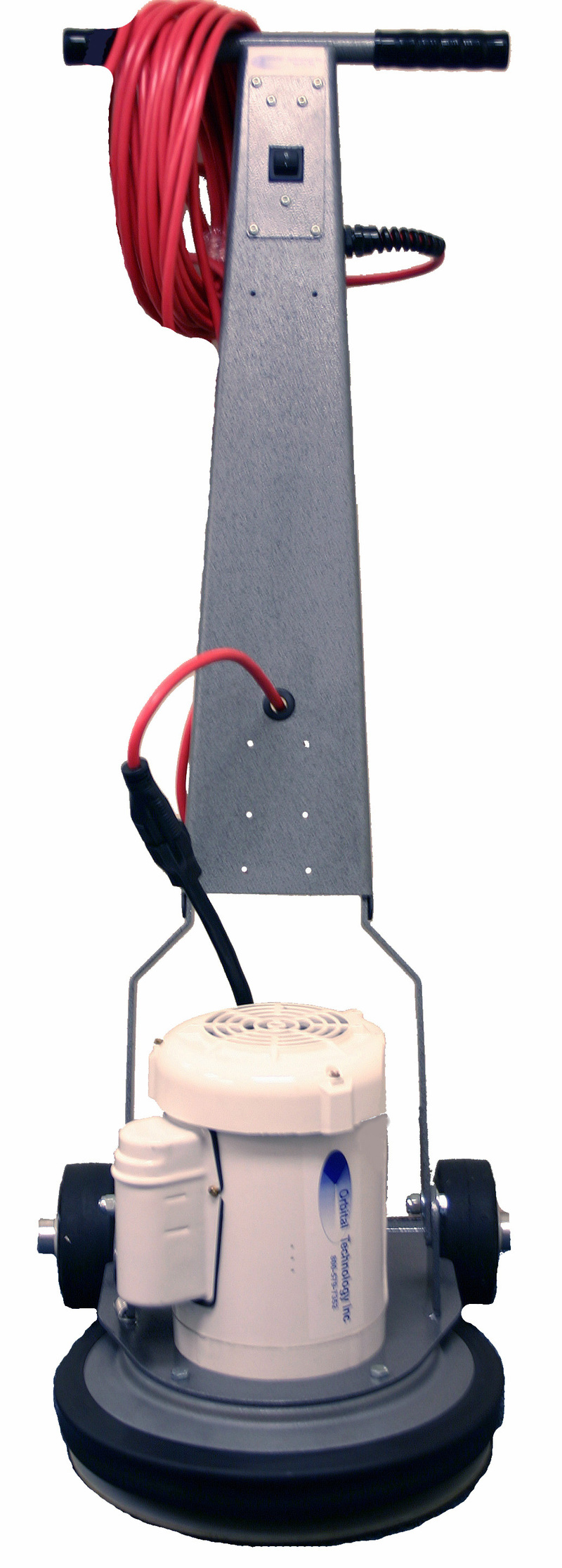

Mikey, I will bring you an OP (Our new Defender) to play with at Connections. You can make your own evaluation. You can pass it around to others if you like.

I didn't see the new machine on your website Clark...do you have some specs or photos?

What size machine are we talking about Clark?

I'd like to also see the defender model with the large "Guiding" wheels.

Dolomite, You can't feel a Defender running. Your machine needs to be balanced.

Is this what you're proposing?
17" would be great.

No that is a 15"OP. I have one more pass to make on a Rug Revolution cylinder and I will make some pix. It looks like a CX. But the handle is moved back. It run smoother than a CX. The handle back will not support the tank and solution.

I tried 1 and 1 1/2 hp buffer motors from GE, Howell and Imperial. They died in 4 to 6 months. I had to replace every one. I still have 30 in my inventory. The motor I use now is made for my use. Buffer motors a geared down from 1800 rpms to 175. OP is at 1800. I have had to eat enough motors to know what will work. 3/4hp for a 17" OP is more than enough power.
