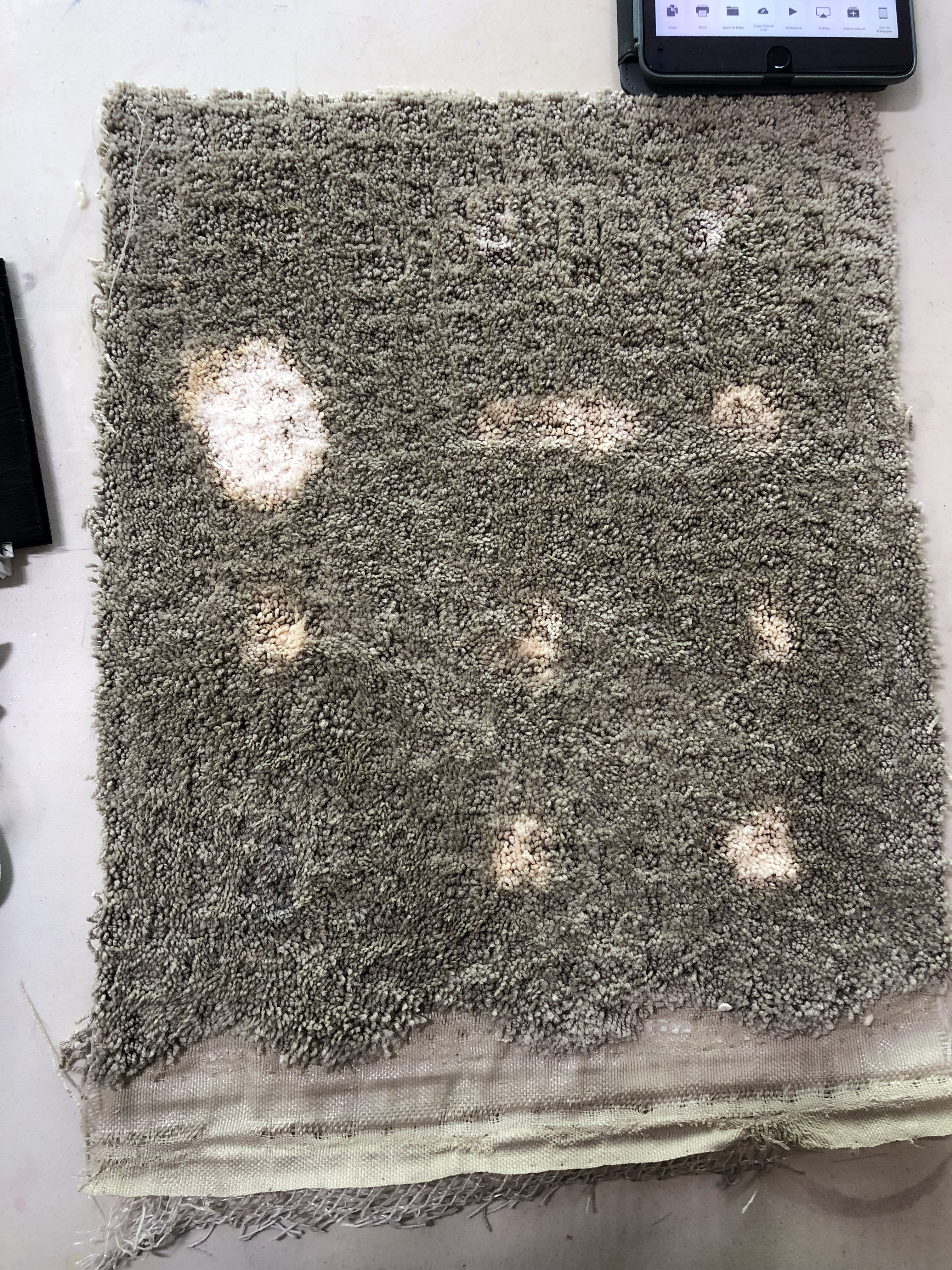

Is this a temporary or permanent fix for bleach spots and color loss from urine?
It looks just like women's makeup or crayons, but the process they use in the video looks like it does a good job. Can someone explain the liquid fix vs the crayon fix?

Since the excess dye can be removed by the solvent, it stands to reason that the color fix is not permanent and would be removed by solvents and possibly detergents.
Crayons are pigments, which means that they cover the stain. An example would be a stain on a painted wall that you paint over to hide.
Dyes are transparent and you need to build the final color through adding different amounts of red, yellow and blue.
Their system uses the above principles but I would assume is not permanent. I never tried it or saw how well it lasts.

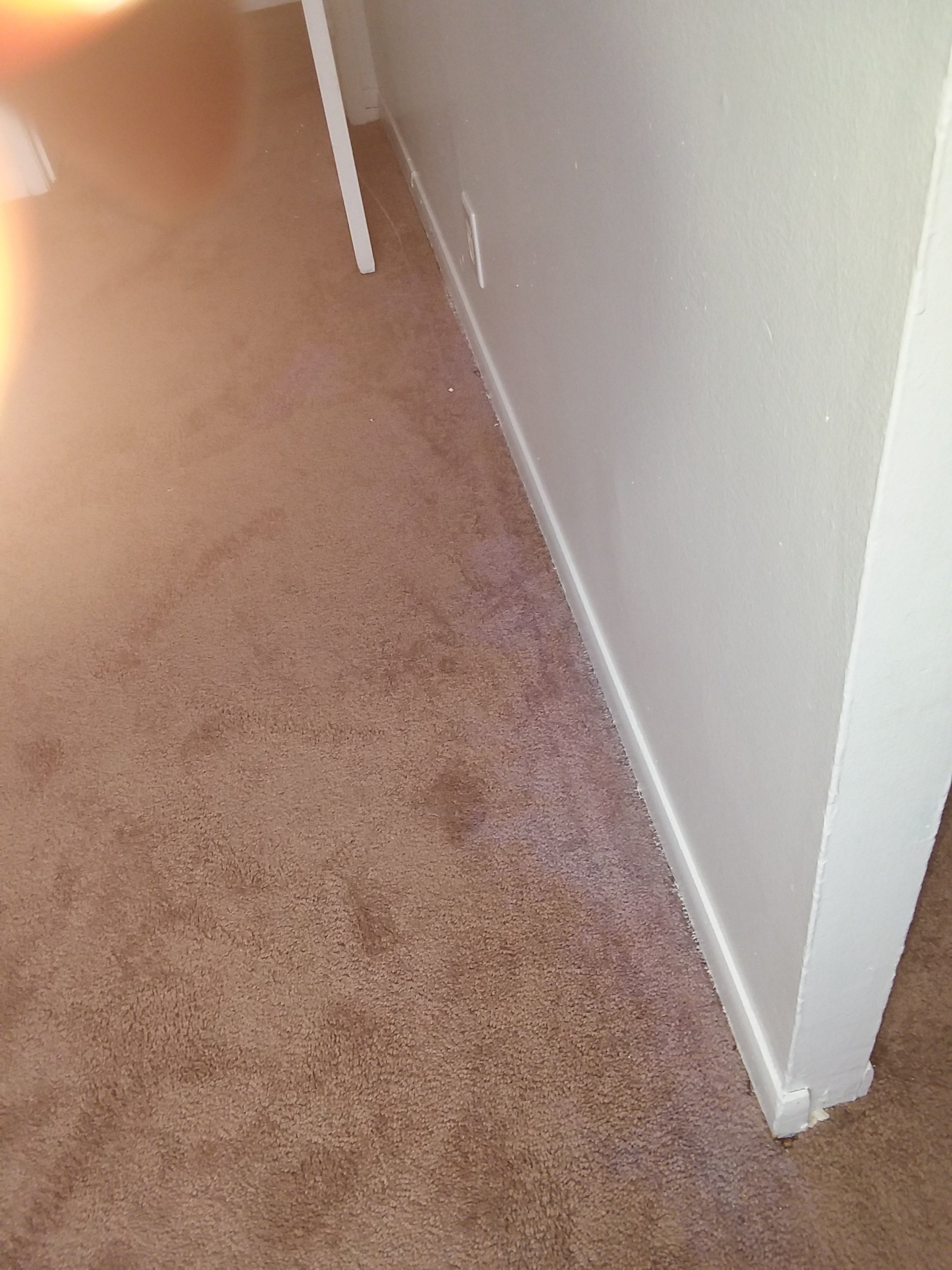

Now that I am thinking about it, usually the damage is purplish hue on the polys, and olefins. Should just get a variety of mustards to put the yellow back in and get back to tan. :biggrin::biggrin: LOL!
