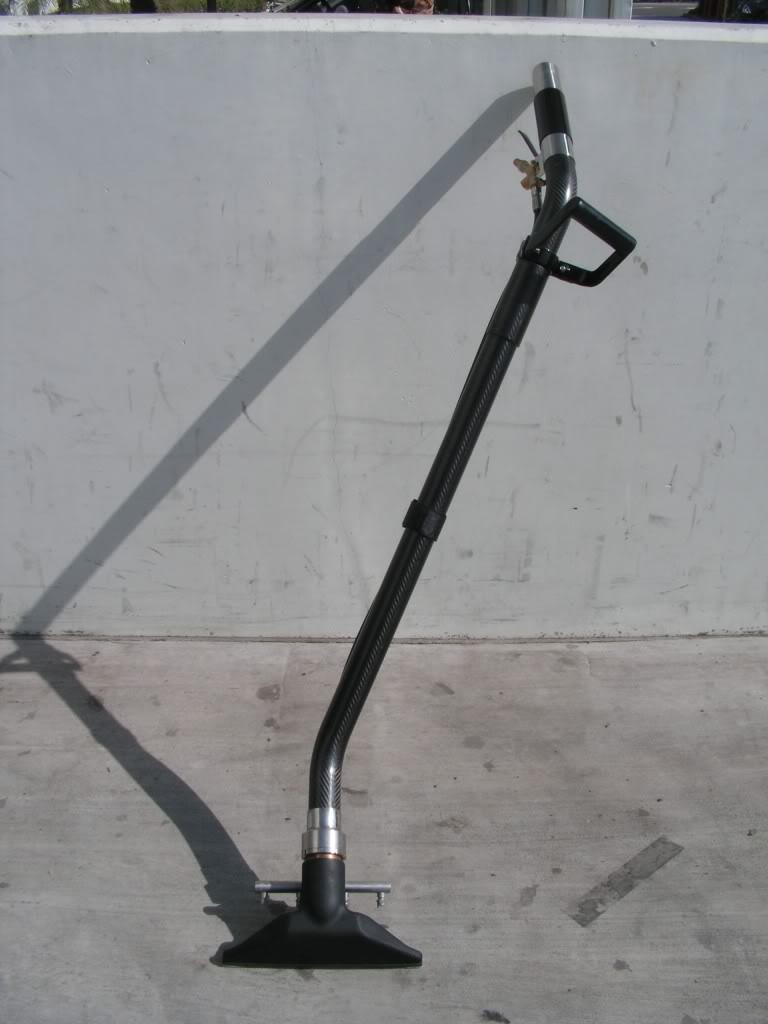

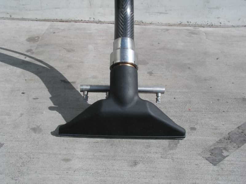

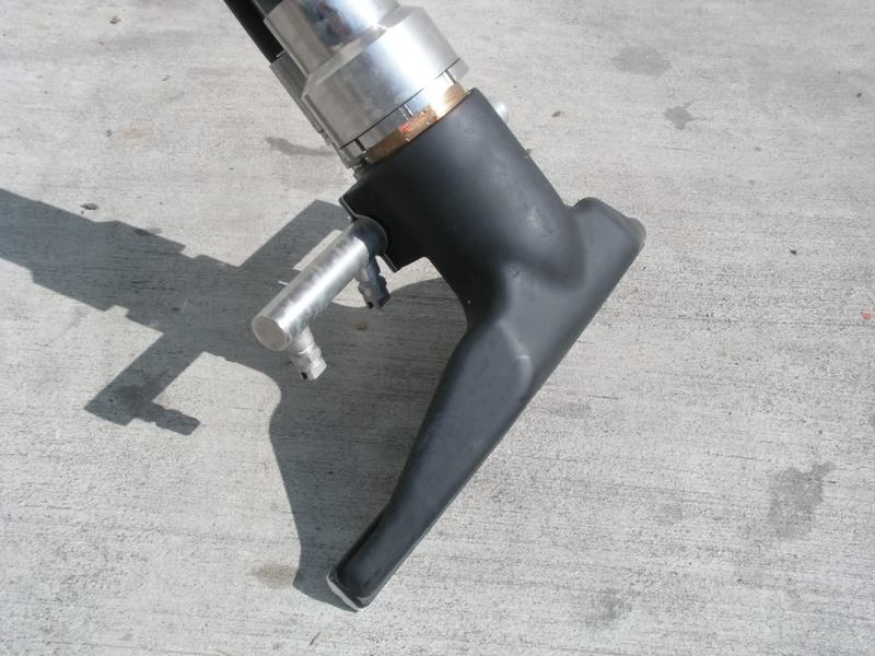

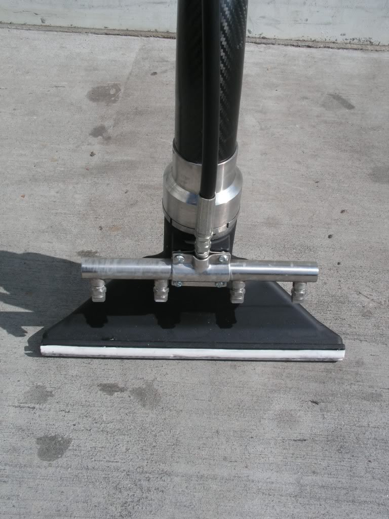

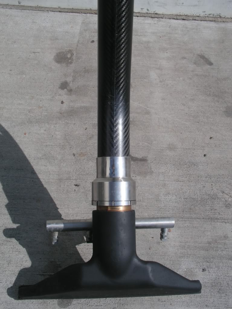

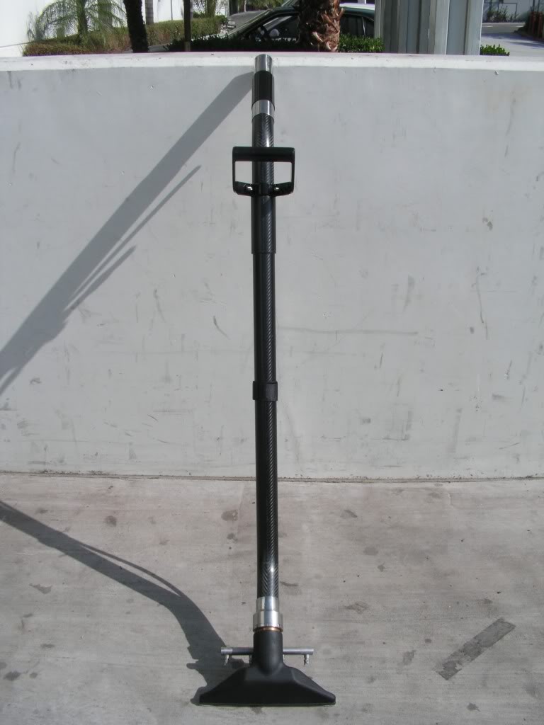

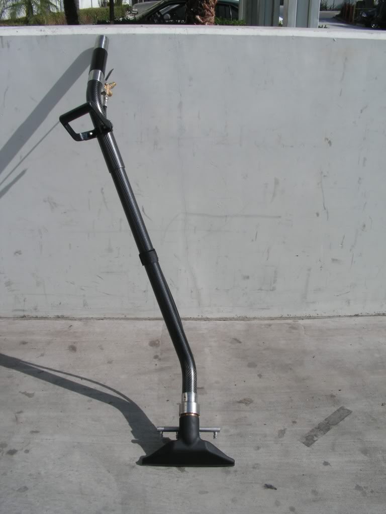

Nice looking set up. It looks like that machine had lots of suck.
John, why not bring the jets closer to the carpet?

Let me be the first to pull a Marty. What's with the over spray??? Too much over spray!!!
Lol, Looks good John. You and I got the same wand technique. I got scolded from Mikey about that. :D

About 30 degrees. I'll check when I get to work and will be more precise.

Please don't let Nathan making fun of my obsession with overspray diminish the importance of it to you. It IS a problem with almost every wand on the market and one that many mfg's don't adequately appreciate. If you are going to build the perfect wand, then please correct that problem before it hits the market and you guys get used to selling it that way.
J
John LaBarbera
Hi Marty,
I agree whole heartily. I've made that mistake before and don't ever want to do that again. Thanks for the advice.
John
J
John LaBarbera
Spraying System jets now come from China, like some of the parts on your car. The carbon fiber company is a local guy. We assemble everything here in Poway.

nice wand john and pretty good video presentation, you should make more for you other products. i agree with some of the guys above, only problem is the overspray issue. have you tested moving the jets closer to the carpet and using a wider angle on them? if the wand breaks or carcks are we up the creek with out a paddle?
J
John LaBarbera
Hi Mike,
Thanks for your comments. We're going to keep making videos and put them on our website. We're looking at different spray patterns for the jets. The carbon fiber tube is stronger than stainless steel. No one has ever been up the creek without a paddle in a Mytee.

Very promising. To make it perfect, it could use even more of an angle on the jets and jet extensions like on the Greenhorn.
You need to contract Greenie to fine tune it. :D

Greenie knows his stuff that's for sure. I may send my extra long Bentley for Mikey to break ( I mean test ). Maybe Greenie will take a look at it and get me the Greenie critique and SOA. Then I know it will be the best. (except for the Greenhorn of course)

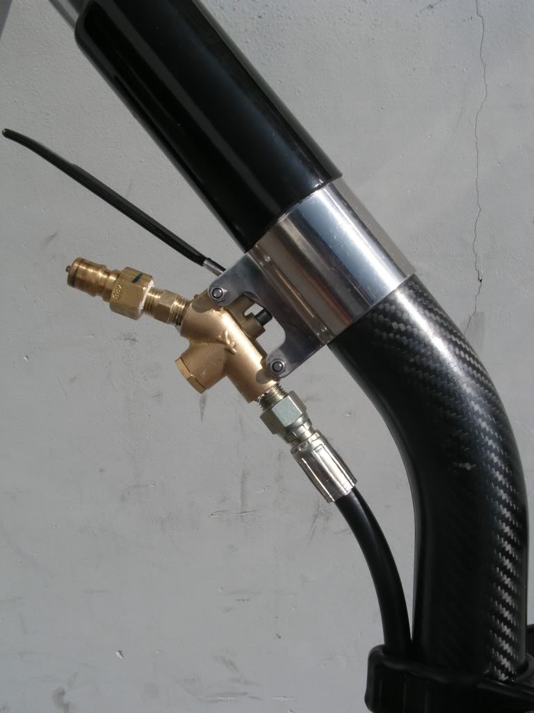

Why not try to improve on the greenhorn. I think if you make the head a little bit bigger (not wider) for better airflow you possibly could match or beat it. One thing I don't like about my greenhorn is that it's not easy to keep clean. It seems what you've made would be easier to keep clean not to mention the swivel head is a bonus. The check valve extensions are a must. You wouldn't have as much steam if you got the jets closer to the carpet. I'd mirror the 5 02 jets greenie has I think they are a 110 deg spray pattern. Also I like the overspray shield on the greenhorn better than the bentley design.
BTW when I was at the jon-don in atlanta. The wand that's all the rage is the evolution, and also the cleaners there wanted the titanium. Those are probably the hotest wands out there right now. The bentley could do well if you can get it out there.
I found that most cleaners don't know what's out there, just what they can get from their dealer.
J
John LaBarbera
Thanks Tim for the suggestions. Mytee is always open to ideas to improve our products. That's what I like about Mikey's Board.
