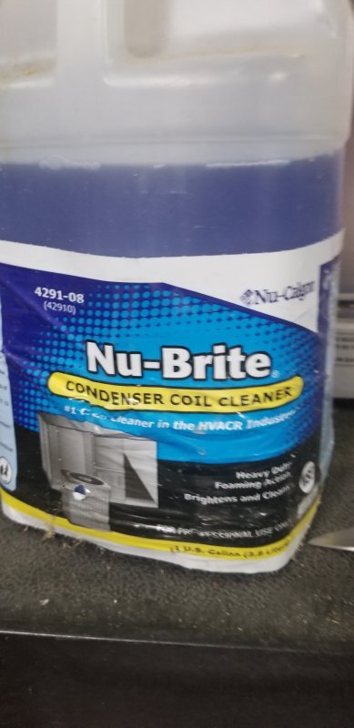

well, It my be to late to post this, However I was in same situation a cpl years back, Same tile, Same grout..... I used everything known to man to clean it,,, no go.... However before I gave up... Being that I'm an HVAC/R guy as well. I decided to grab my Coil cleaner.. I applied it to wet tiles let it sit for a few, and that Crap melted off the grout like nothing very minimal scrubbing ....
give it a shot,,, GLOVES, GLASSES a MUST...
Awesome! I'll pick some up incase I run into that again. Thanks for the suggestion!

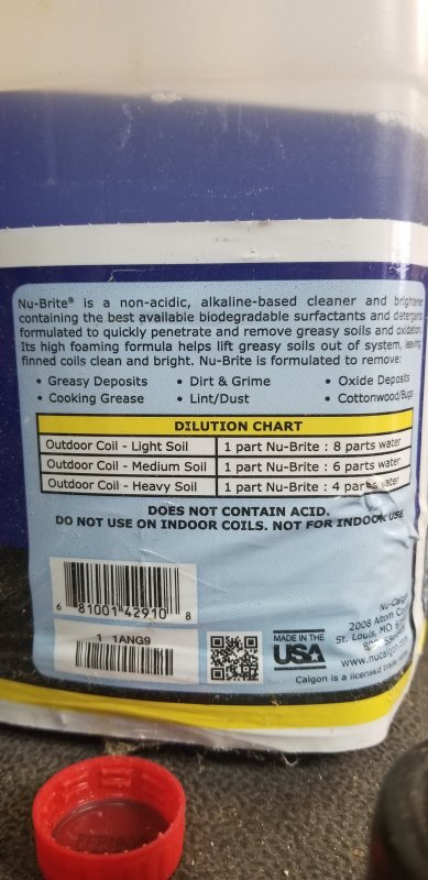

Nomad, i was gonna reply to yours aswell, looks like you were having same type of issues.
Have a friend who does Pressure washing ,carpet, tile and grout, he tried helping me out to get it clean, then i grabbed my coil cleaner, he was pretty shocked... who, knows if it'll work for you but i know i was impressed immediately..
Best of luck.
