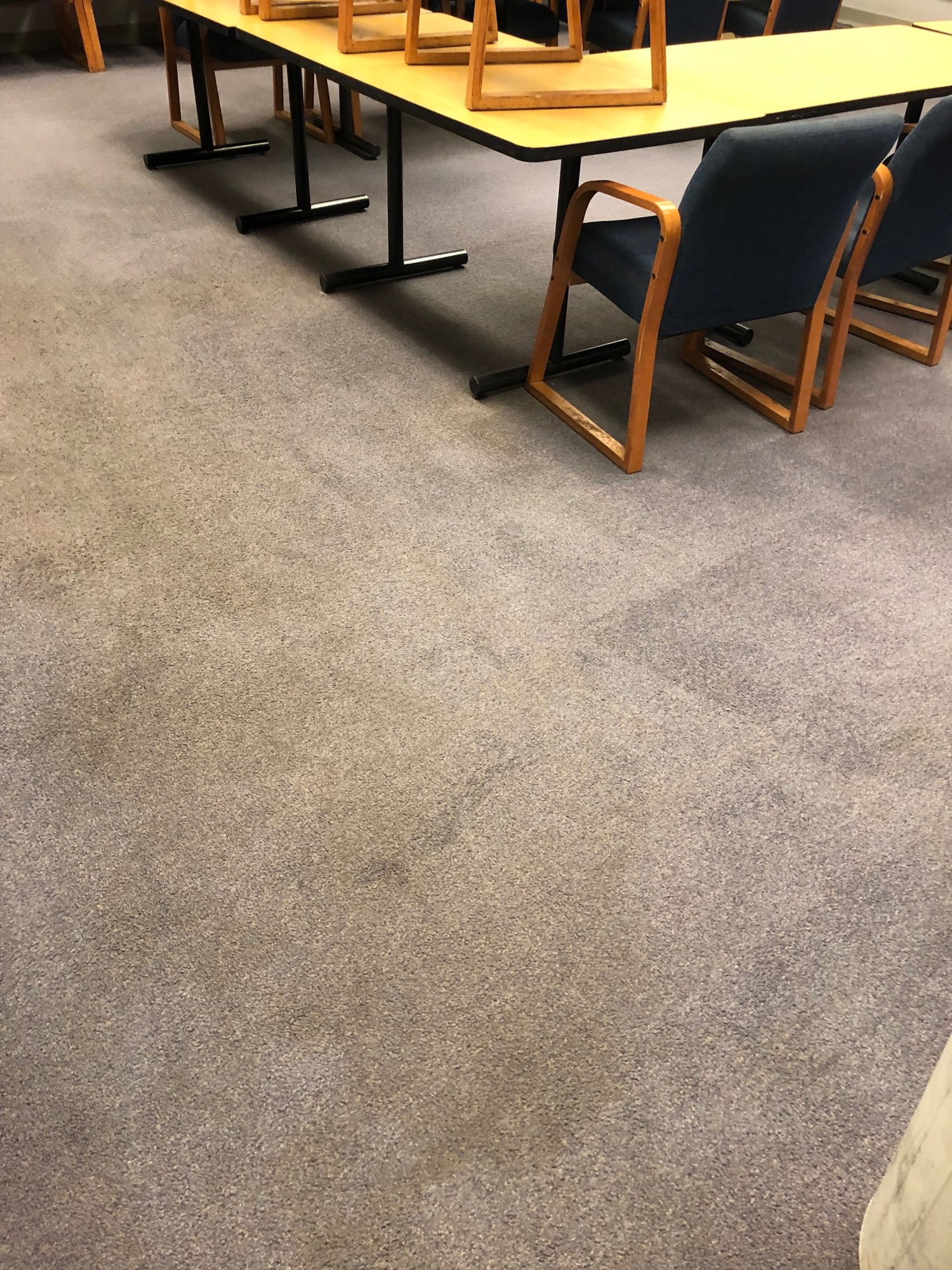

Ok at work this week one of the employees extracted with Encap. Two days later brown traffic patterns formed worse then before the Encap.

What did they extract with a portable or a truck mount?
Do you have any pictures of the brown'd out carpet by any chance?

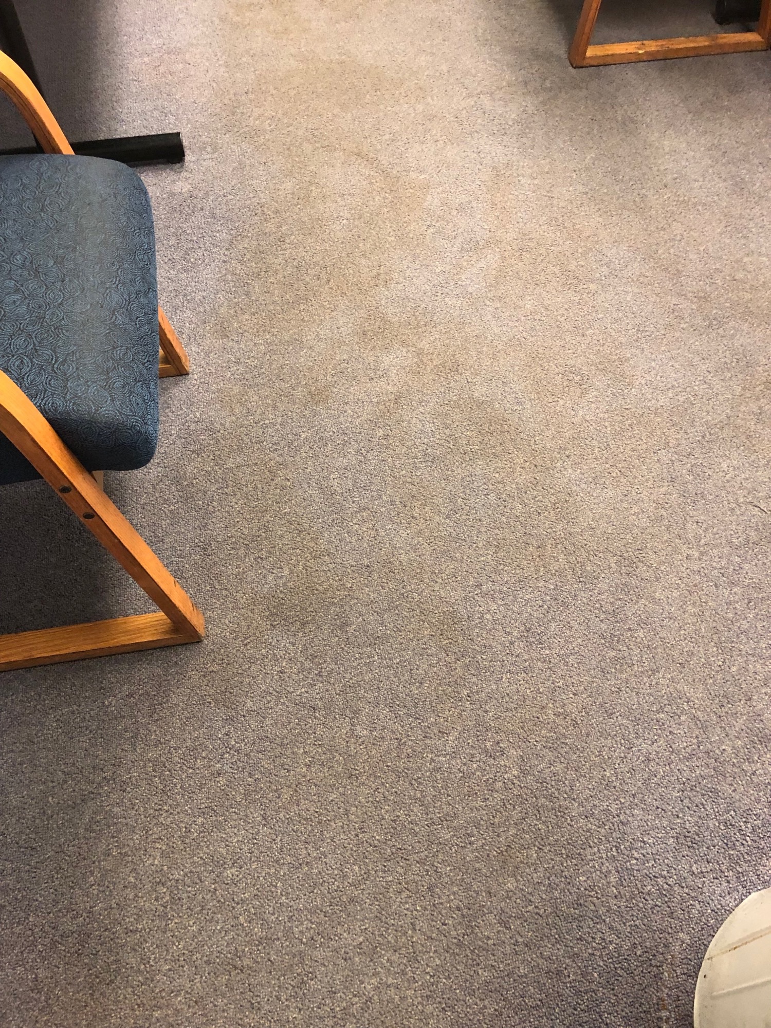

Unfortunately I didn’t get pictures. The path actually turned orange in 3 days.
It was extracted with a clipper portable. Standard CGD carpet.
Agree with over wetting. But also several gallons of Encap was put on the carpet via extractor. Aka 6 1/2 gallon tank I believe
Nov 24, 2016
15
Marlene Slichter
Ok got the pictures from my supervisor. This carpet was extracted on a Friday. No traffic on the carpet till Monday. And limited because it’s UC summer time.
Encap in the extractor
6D55816E-DC94-432E-B3F7-EFC122797578.jpeg 6DE2E09D-84D6-477A-947A-83B6DFC000D9.jpeg

The problem wasn’t likely from the Encap. The problem was more likely the Clipper portable extractor. A walk-behind portable extractor on CGD will invariably produce wicking. I would recommend doing a Low Moisture Encap, perhaps using bonnets, with a good hydrogen peroxide Encap product like Encap-HydrOx. That should resolve the discoloration problem for you.
