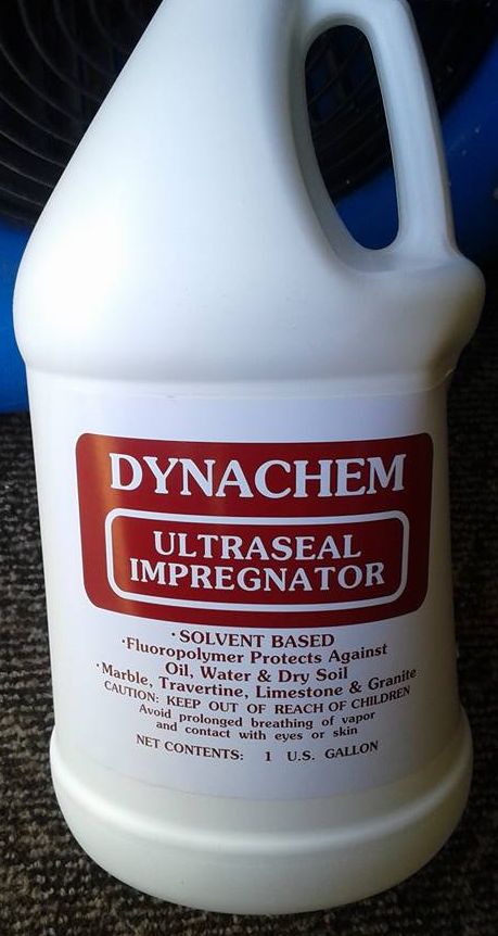

Why didn't we get 3rd place ? :headscratch:
Now we have the Impregnator with UV absorber for outdoor tiles that bleach out in the sun.
http://www.cobbcarpet.com/zen/index.php?main_page=product_info&cPath=78&products_id=5150

Is the grout and stone Ultraseal really the same as the carpet Ultraseal?
Derek; It is now the same product. Let us know how the testing went.
Ron; Toxicity is not in the solvent.
Breathing any type of fluorochemical can cause lung issues.

A large group of people in Florida used our Ultraseal Impregnator on a lot of sq. ft. of tile at the MikeyFest.
I heard no complaints about the odor of the Impregnator.
The solvent odor is less than Odorless Mineral Spirits,
due to the lower level of aromatics.
Any comments from those that actually attended the tile sealing demo ?
