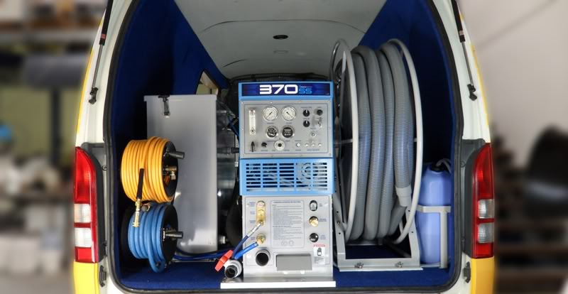

I know you guys over there don't have this van, but this is a Toyota van. This is a larger version of our standard smaller sized Toyota vans over here. This rig is owned by one of our Aussie Cleaning forum member. He purchased a second hand, low km, super long wheel base Toyota Hiace.

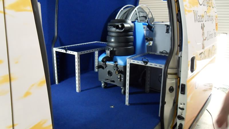

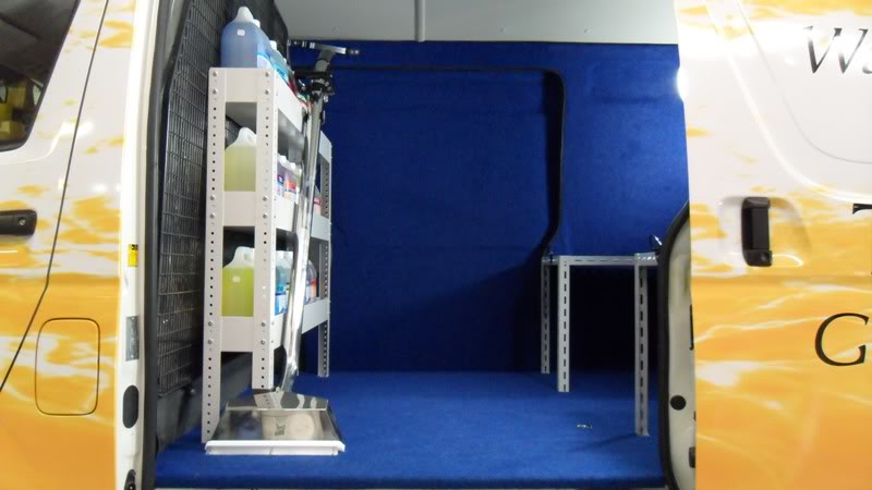

Side view showing chemical shelf and how much spare floor room there is available.
Looking toward the back of the van, the racks can accomdate 6 airmovers (above and below) and still room for a portable, scrubber, dehum or 2 between the two racks.

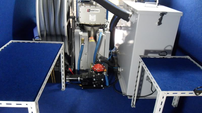

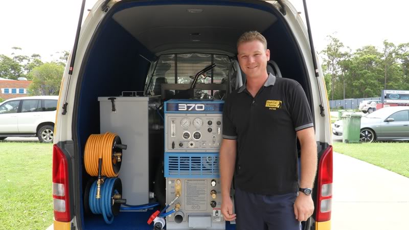

Upon removing cargo that would normally sit between the two racks, it allows very easy access to the APO and the rear of the machine for maintenance.
The Sapphire 370 SS. The vacuum hose reel can be removed in under a minute therefore allowing complete access to the side of the machine if it is ever required.

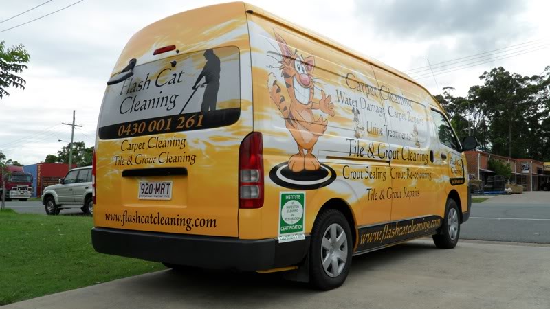

Then (with Pete's ideas) turn a standard looking van into something 'attention grabbing' :)

Looks fantastic Jim. That machine looks incredibly small - have you had much feedback yet on the performance and reliability of the Sapphire range? Have you installed many yet?

How can I do something similar to the floor in my van?
It's really crappy and I'd like to make it nicer. Do I remove the rubber matting or leave it there than glue down a cgd? Or do you guys use card box mold than cut pieces of plywood than glue/staple them together, than glue down carpet?

Mines is no where in the league of Jim's install. I used 3/4" plywood cut to fit, then drilled it into place. Had some left over outdoor carpet from a job. cut it to fit, then stapled it down and good to go. I did use a roll on bed liner before the wood. using glue imo would be a pita. Staples around the edge should be good enough.

Thanks Heath. Your right, and this has been part of the big attraction with the Sapphire equipment – the physical size is so small, and with our smaller vans this is very important as it allows us easy access to the vital components still. The owners who have purchased either the 270, 370 and 454 have all been very, very happy with them – and most of our client base are existing cleaners that have already had a variety of other brands of TM’s over the years. And yes, we have installed quite a few of the Sapphire units 8)

Nate is pretty much on the money here Bill. If you put down a Rhino Liner/Line-X first it will always help long term (even a normal rust proofing paint failing that).
We then use marine ply on the floor, cut it to shape, and glue and biscuit join it together before installing marine carpet with marine glue (no staples required) and tuck it into the gully around the edge of the marine ply floor to give it a very tidy finish.
On the walls, we insulate them with foam insulated batts, then zinc sheet the walls, before using marine carpet with marine glue again.
