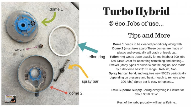

Turbo Hybrid Use for me is pretty much the same...Great tool...Left out one part on this diagram/photo and that is that vacuum compensator...that part last as well for a long time as well as needing to be adjusted periodically pending on the roughness of tile and grout...Hope this helps for the future of your turbo tile cleaning tool...Good Luck!
1 Job equals usually around 1000 square feet (mostly residential)
My heading should read 600 Jobs...Can't seem to fix...
Here's turbo's website: Turboforce

I couldn't get the jets off with only a couple hours on it. I think they are glued in place.

Looks like original spray bar with adjustable spray angle- for pro use
The new ones we have are welded 90s and non adjustable- meh
We only run brush heads sines we are 80% stone
Plus $40 for a new as braided line
