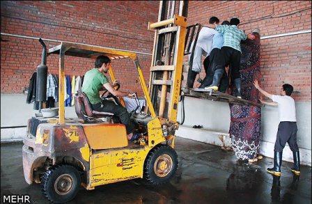

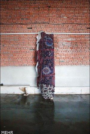

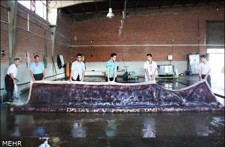

Washing and Gravity Extracting Water Out of a Big Rug

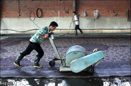

I used to have an Iranian guy who worked in the rug plant for me and he had talked about how they would clean a rug and then roll it up wet and stand it on end to dry when he was still in Iran. I find it incredible that something so large and layered would dry. What is that machine they are rolling over it in the first two pictures Tom?

I call it the poor man's centrifuge!
It works well for some things ..obviously not bleeders works great for tufted rugs!

Give a water-soaked rug ten minutes like this and it will be lots easier to get out of the house.
Wouldn't try getting a rug dry this way though.

We don't dry rugs like this we let them drain for an hour or two then we hang 'em.
