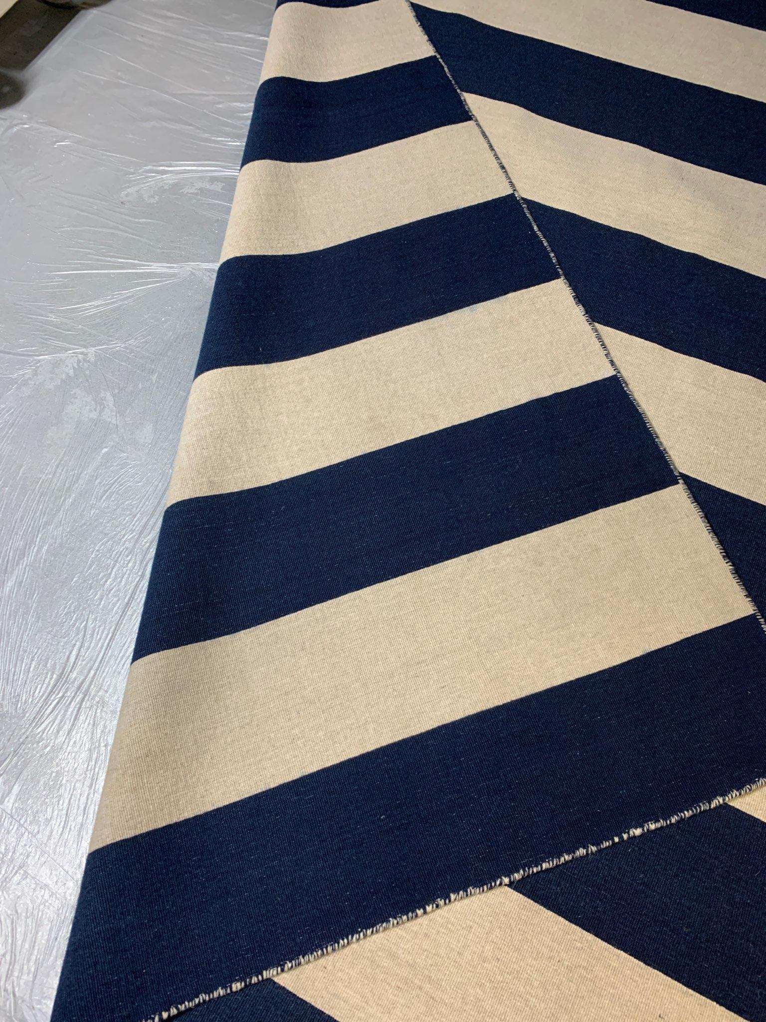

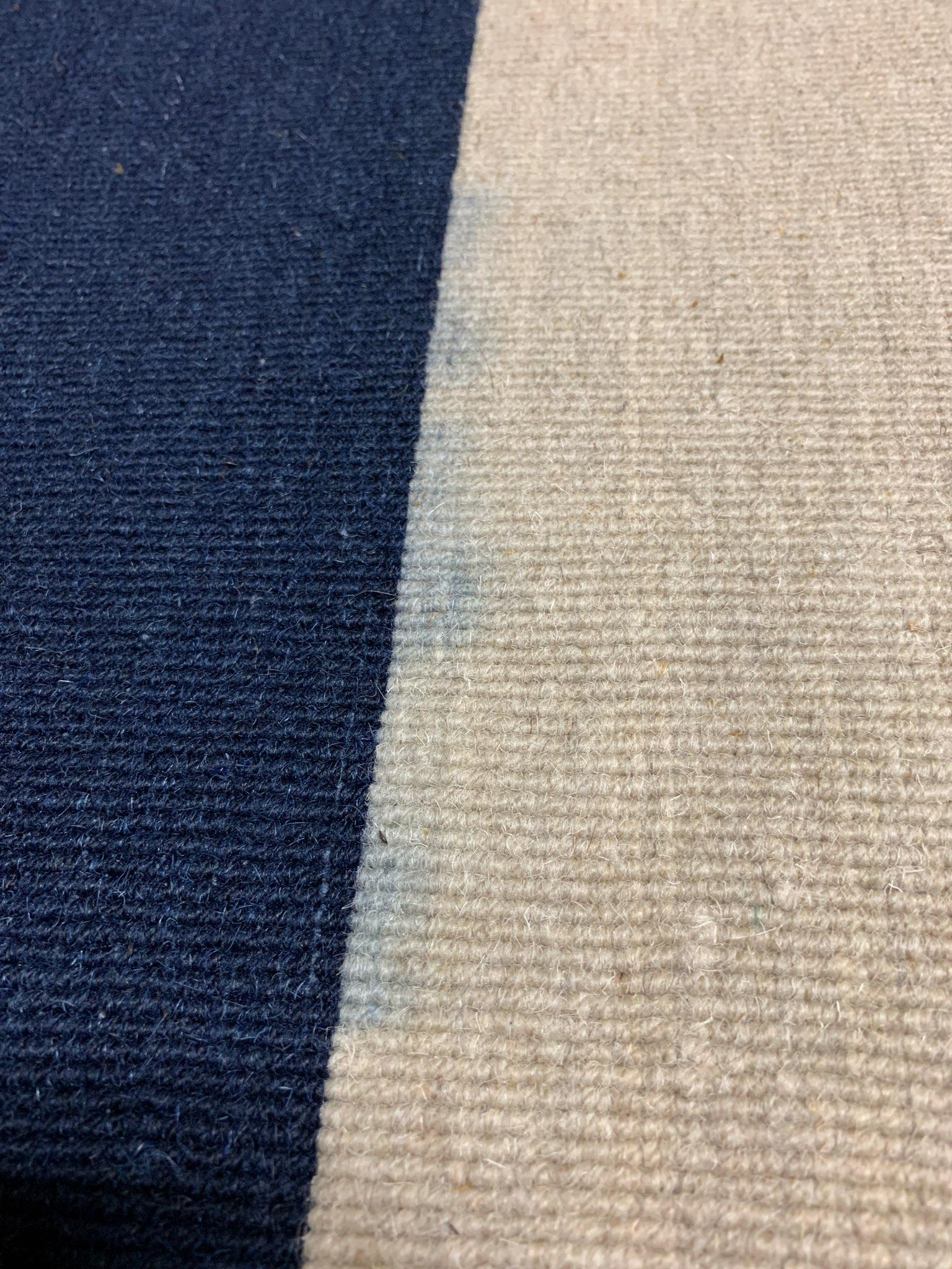

Top cleaned with Chemsepc One Earth, dried flat...
Suggestions besides sending to Lisa Wagner?
thats what I would have used..I use prochem fine fabric
sodium bisulfite, talcum powder and patience![]()

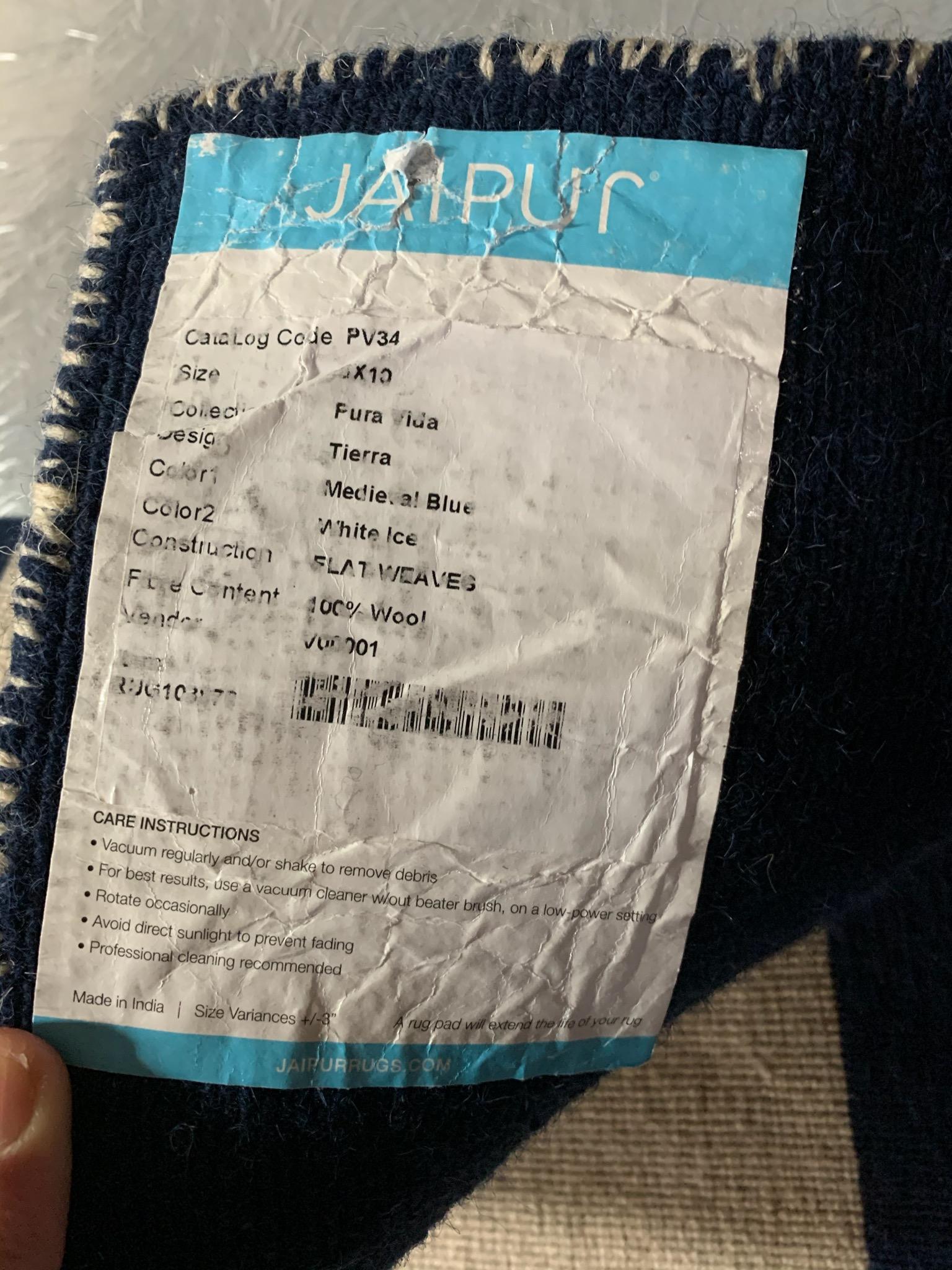

What's it made of and what's been done to it?
whats the talcum powder for, an absorbant for fugitive dye?sodium bisulfite, talcum powder and patience![]()

yes the mix has a bit of acetic acid in it with hot water- usually takes about 3 days waiting till it dries out completely -then brush off and cool rinse - and repeat if necessary. Another option which we used with some success on fabrics, was to wet stain using a carrier such as Trich111 and then blow back with compressor into where the dye had migrated fromwhats the talcum powder for, an absorbant for fugitive dye?
