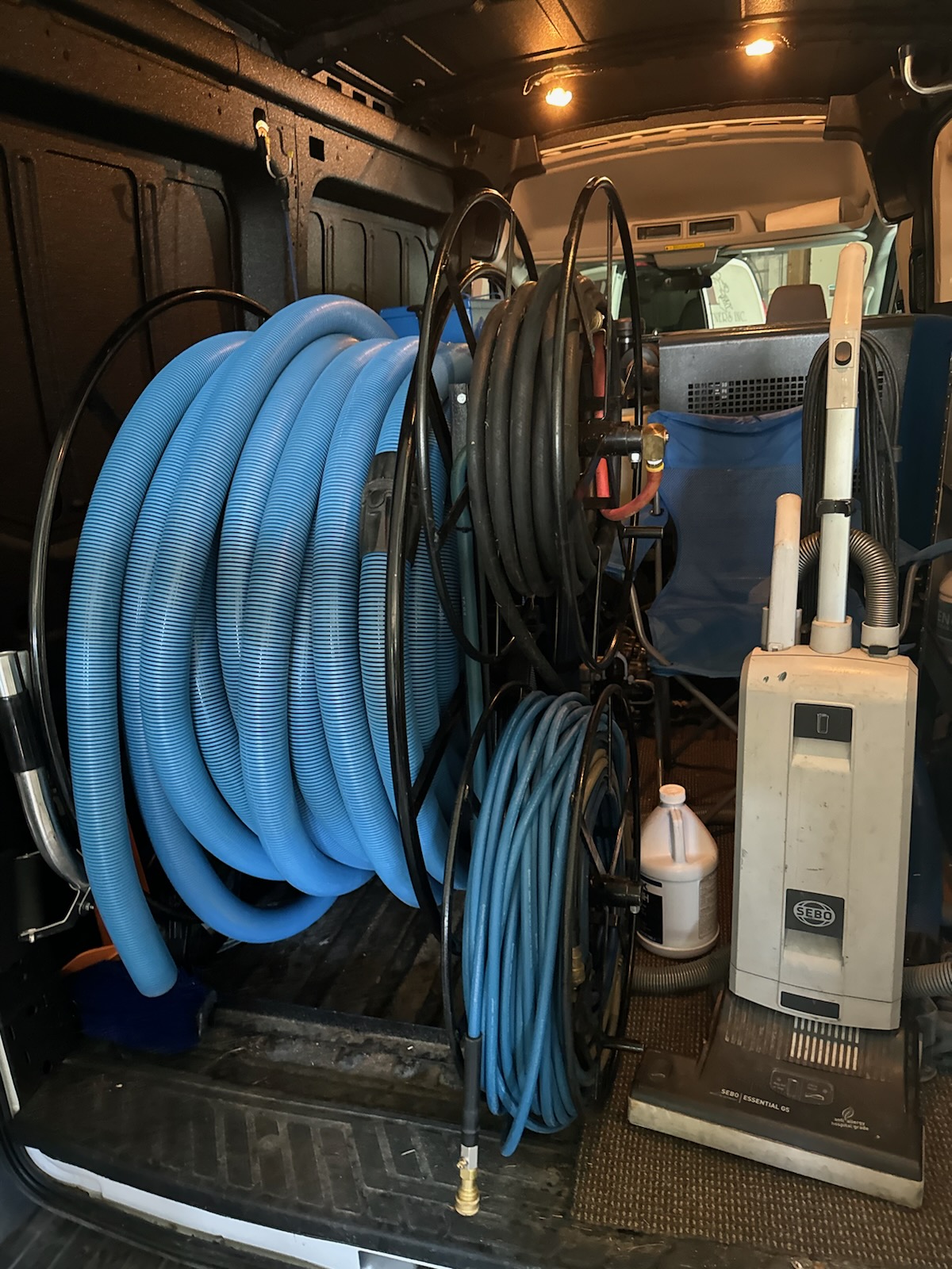

On a serious note, you don’t have enough fresh water hose on that reel. If you size down to 3/8” supply hose, you’ll have access to water on 90% of the jobs because that reel should be able to hold 300-400ft of hose , and the other 10%ers without water are normally crappy rental jobs.
