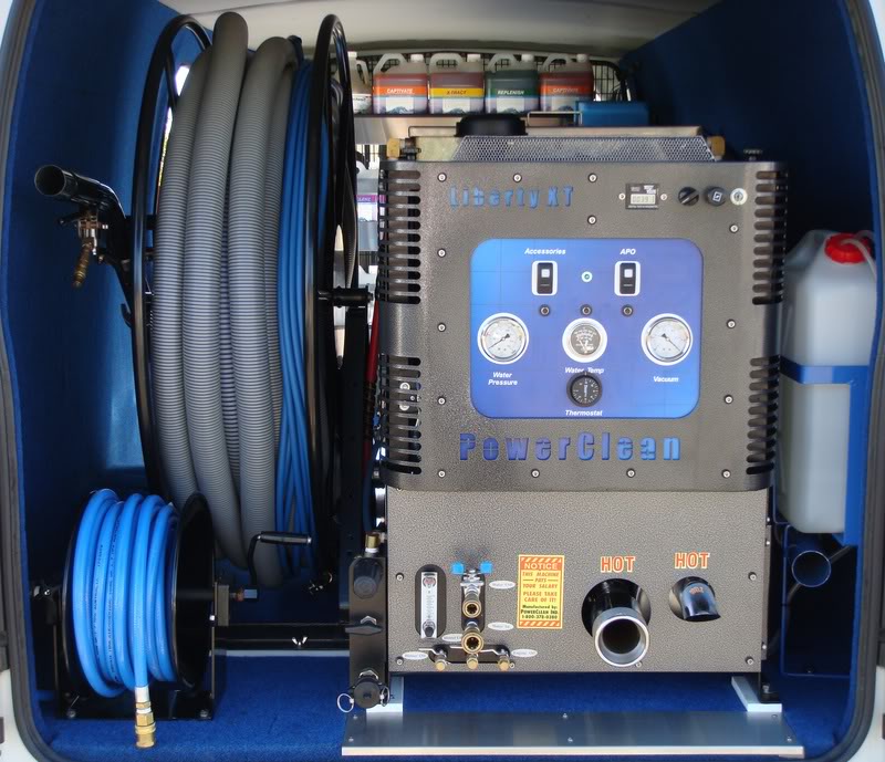

As you can see, the smart manufacturers are listening as evidenced by the guys that have replied. There are some nice machines in the mix so far. As John Middleton mentioned (thanks John 8) ) PowerClean also closely listen to what is going on and adapt to what their clients want/need. The Genesis D-XT is example of that. I just went out and took a photo of another one that we are installing this week. It is powered by a 52 hp Diesel Isuzu engine (which has a 5000 hour/5 year warranty :D ). It comes standard with 2.5 ports coming out of the waste tank. To the rear of the machine, you can see the size of the plumbing. Inside that box sits twin 3 inch blower filters. They sit remotely outside of the waste tank so as not to get clagged with debris like the normal filters do. This machine can EASILY run several hundred feet of hose. Yes, on Greenies advice, it also runs a 3" kunkle valve as well. It even has a series of jets to wash down the inside of the waste tank as well.
Like was stated earlier as well, manufacturers are listening. The PowerClean Liberty (this is the biggest selling machine in Australia in the last 12 months) runs a water cooled Kohler, 2000 psi General Emperor pump, and also runs a kunkle valve and is designed to handle either 2 or 2.5" hose - setup from the factory in that condition.

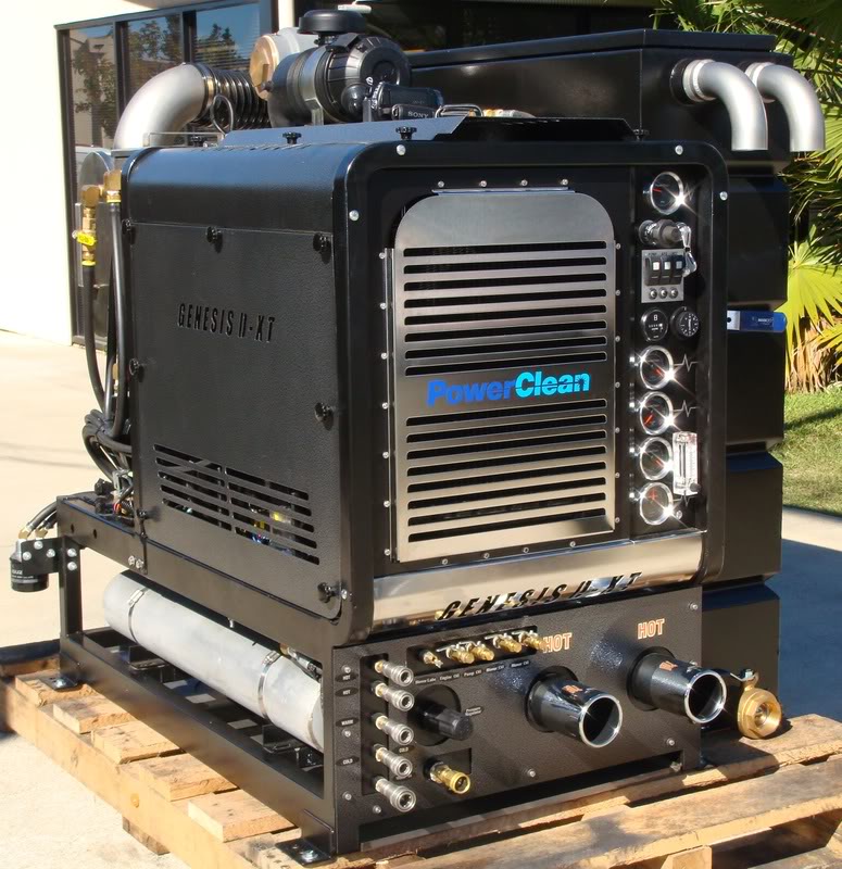

On the Diesel Genesis? It runs a 59 with a 3" kunkle. With the way it is plumbed, it moves a lot of air. I lined up the Z-XT Genesis (gas version) that runs the same 59 blower, with the D-XT (Diesel Genesis) and even though they are running the same blower, that is about where the similarity stops. The air flow movement on the Diesel Genesis is a lot smoother, and now breathing easier by having the dual 3" air filters sitting outside the wastetank, it is an animal on the airflow department!
It is going to be interesting to see the advancements in our industry over the next few years. With a big thanks to Greenie, manufacturers are sitting up and taking notice that we are looking for more reliable performance from our machines. And one other thing I have noticed is the vacuum that what we always thought we were getting from our machines (be it of any brand) we weren't! The difference between the Gas and Diesel Genesis is proof of that. The Gas version produces copious amounts of vacuum which is always impressive. Compared to the Diesel version and its different use of engineering, it is two completely different machines, despite having the identical blower. I have noticed the same on the PowerClean Liberty vs. Boxxer 427/Prochem Peak. The Liberty runs a 36 blower, while the other two machines have (on paper) larger airflow blowers. With the Liberty running 2.5" hose on the 36 and having a kunkle valve as standard, you cannot tell the difference between it, and it's larger, more expensive competitors.
Jim

You always have such impressive photos.
I also appreciate the machine advantages you are describing.
We also have utilized a vac filter box that is not part of the recovery tank.
But, I do have a couple of questions on your comparison of the #36 blower to the #4 blowers.
What vac lift is the #36 blower operating at ??
I would think a #45 blower is capable of more operating lift.
Also, how are the two 2.5" elbows installed in the recovery tank on the D-XT?
Larry
P.S. We are looking at a new Diesel EFI 26 HP engine for a new #4 blower TM we are building.

Hey Bill - I apologize, I have no idea what they sell for over in the USA. I am the PowerClean dealer for Australia. However, I can get one of the PowerClean guys to contact you if you like?
Ron Werner said:
what is the fuel consumption on that diesel?
It is a little over a gallon an hour at single wand operation.
Larry Cobb said:
Jim;
You always have such impressive photos. I also appreciate the machine advantages you are describing. But, I do have a couple of questions on your comparison of the #36 blower to the #4 blowers. What vac lift is the #36 blower operating at ?? I would think a #45 blower is capable of more operating lift. Also, how are the two 2.5" elbows installed in the recovery tank on the D-XT?
Larry
Hey Larry, thanks for the compliments :) Sounds like a nice engine you are choosing to use in the future with that small diesel as well. In regards to your questions regarding the differences, the 36 was set via the kunkle at 14". The 45 was un-kunkled, just as they come out of the factory. The 36 killed the 45 and most people couldn't tell the difference between a kunkled 36 running 2.5" hose and a standard 47 setup. I know that I am going to get crap thrown at me for that comment, but it was amazing. We had our main nationwide tradeshow (sorta like Connections) over here about 2 months ago. I was running the Liberty as it comes from the factory and including 2.5" hose. It outperformed all the other machines that had 36 bi-lobe (and 3006 tri-lobes) and 45 bi-lobe (4005 tri-lobe) size blowers and matched units that had a 47 (4007) blowers running.
Yet on paper, a 36 is meant to only have around the 270-290 max CFM. However, when you see a machine that has been engineered correctly and makes full use out of other performance upgrades (eg. kunkles and larger vac hose) that can actually match the performance of machinery that again, on paper, should have around 200 CFM more, it makes you sit up and take notice. That is what I was referring to earlier by saying I don't think manufacturers have been getting anywhere near what they tell us they have been over the years in regards to CFM ratings, when you see something small outperforming and/or matching something that has a much larger potential - as standard. And to answer your question about the ports on the waste tank, they have a thread on them and get screwed into place.
Jim

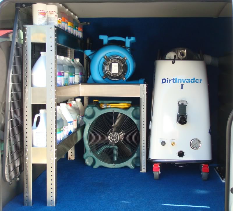

p.s. - This is the front half of the install I showed above. This is our small Toyota Hi-Ace van, yet with a Liberty installed, we still have a fair amount of spare room left over. With our gas prices so expensive over here, we have to diversify.
