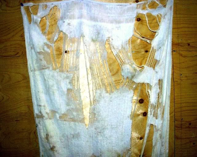

Preventing disintegration of fabric. Here is a shot of a cotton towel loaded with Peroxide that I used to warn my Techs about the dangers of using ANY Peroxide on ANY fabrics.

I got paid for 90% of those examples shown......
And I learned something from 100% of them.
Bill, I have tons of pictures like those and most were restored to a satisfactory condition.
Some were attempted without success and some were not even attempted after testing.
None were made worse by our actions - many years ago I figured it out and began to have a lot more respect for what COULD go wrong with fabrics. Too many cleaners either fearlessly clean everything or are too terrified to clean anything.
I do believe that there is a happy place between those to extremes.
A healthy fear of fabric is not a bad thing.
Too many Instructors teach with a view to selling product and do not focus enough on testing and prevention, imo.
