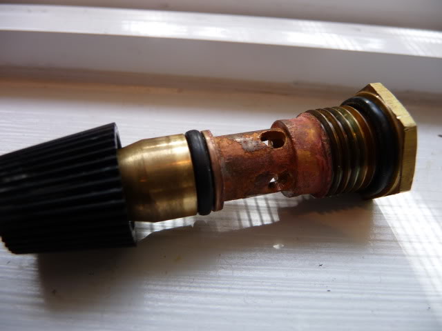

about a year now, I've gone through two chem selector (on-off-prime) switches

I've been running soap free for about a year and went threw 3 sets of check valves, several brass pieces on the chemical system and now my on/off/prime switch is seeping
117,380
My second Dwyer meter is going bad.
We'll see if a night soaking in vinegar fixes it.

have any of you guys brought this issue up to Masterblend who are having the problem as well as the product code for you particular jugs? It might be a trackable problem.

Clean it up overnight with vingar a and run 02 for a while.

Anyone (whether or not you are my customer) who has parts that you believe have been damaged by Soap Free, contact me. If you are my customer, I'll replace the part, regardless of what MB or your equipment manufacturer thinks. if you aren't, I'll do my best to help you.
But I would like to have as many different items as possible, labeled with the brand of machine and approximate hours or days of use, so that I can submit them all the Masterblend at once.
PM me or call me at 800-342-2297, extension 107.
I promise I'll follow through aggressively.

Procyon is straight Sodium Tripolyphosphate.
MasterBlend's Soap Free is quite a bit more complex, as it is designed to be more effective than STPP alone..
Soap free also has a component of traditional cleaners that Procyon is desperately missing, and that is a Corrosion Inhibitor. STPP just loves reactive metals like brass. Using straight STPP without a corrosion inhibitor is no problem for us suppliers, as we make extra money when your brass fittings, your disconnects and your pressure valves fail ina fraction of the time they usually last. But, if you are a conscientious cleaner who has limited financial resources, or you just plain like to spend your money on other things, you may want to think twice about using home brews or products that have corrosive components & don't also contain corrosion inhibitors.

Hi all, Mark Jennings with MasterBlend.
We started adding corrosive inhibitors just after the inception of Soap Free.
If you have experienced a problem with Soap Free, please contact me directly by calling 800-525-9644 ext 23. I will send you an empty 1# shaker with the Soap Free label on it. If you could send a sample back we will check the product in our lab.
While calling me, we can also arrange this through your local distributor as well.
MasterBlend stands behind our product and you the professional cleaner 100%.
Please give us the opportunity to evaluate what may have happened.
I will respond personally with the outcome.

Responding to the Soap Free issue;
Sorry for the time delay, however, it takes a little time to have product returned, tested and to locate batch information.
MasterBlend has experienced an isolated blending issue with Soap Free.
It was a small batch produced on 10-21-09.
If you have purchased any Soap Free on or around this date and have experienced any type of corrosion issues, please call MasterBlend and we will ship you replacement of product only.
Most of this small batch had been packaged into our 42# pails and the majority of this product had not shipped and was taken out of our inventory. A very small amount were packaged in our 6# jars.
This is a small amount of product in the field.
We have rectified the problem so that this will not happen again in the future. MasterBlend has made large investments in acquiring new blending equipment. In addition, a second chemist has been brought on board to the MasterBlend team. MasterBlend will continue to bring new innovated products to our industry.
There were a few discussions regarding our new Red Line Liquid. Be assured that this 32:1 Liquid Prespray is one of the finest on the market.
We apologize for any inconvenience and are ready to make certain that this situation is resolved.
INSTRUCTIONS: Call MasterBlend at 1-800-525-9644. We will ask you to fax to us your receipt of purchase which shall show the date that you purchased the product. Fax to: 303-373-4968. Thank you for your continued business!!!! MasterBlend

Mark I don't want to be the bearer of bad news but both my issues happened over the summer, May and August. Now I've got a busted flow meter as well it seems. That may be from the current batch. On an unrelated note, anyone try Prochem Axiom?

From where did you get that flowmeter?
And what other chemicals flowed through it during its life? (you "test" a lot of stuff, don't you?)
117,380
Les Jones sold it to me.
Two of them actually.
and before Olsen chimes in about it being the 02 rinse's fault, rest assure, I have never ran that through that meter.
I do know that Marty used Soap Free as a PTO lubricant so Masterblend will be buying him a new Vortex.

I'd say go with Jimmy's suggestion. Use a stainless steel flowmeter. I'm not saying all are, but all the models I have in stock are all stainless (for Prochem's, Hydramaster's, White Magic's, Blueline's, Masterblend's and Steam Genie's).
These two are the most common that use an adjustment knob.
Dwyer model: VFA-41-SSV
for range .6-5 GPH
Dwyer model: VFA-42-SSV
for range 2-10 GPH
All you will need is one, then.
p.s. add "-VIT" to the above Dwyer part numbers to go all out, and get Viton o-rings.
