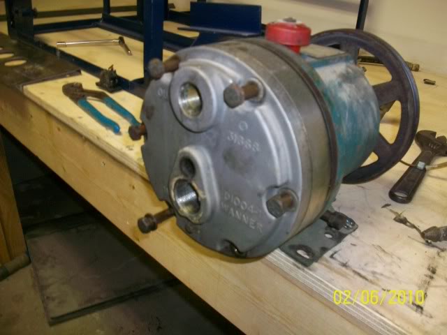

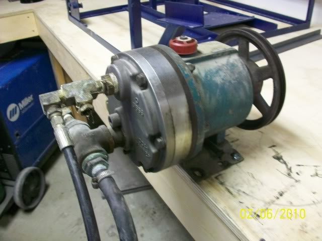

A brand new Wanner Hydra Cell......outta this
C
Chads
Re: WHO WANT TO SEE ME MAKE
I dont think I have seen one of those before, what exactly is it. Water pump for sure but how does it work.

Chads..THIS is the cats ass of pumps..this one has over 6800 hrs wit no rebuild

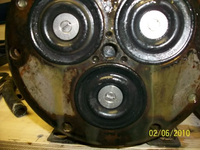

OK HERE GOES first the manifolds come off like this
then you get down to this
pretty old huh..knarly?

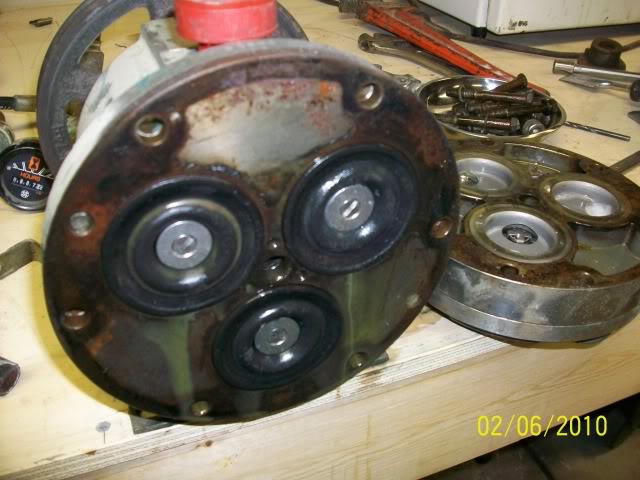

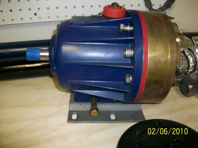

No Brent..this is a Hydra Cell...hands down BEST CC pump made...heres one that i rebuilt recently

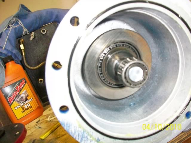

Are you hot tanking those pieces?
Do you have to build up the shaft?
What rpm does that thing turn at?

Isn't the hydra-cell pulley 2x's bigger than the blower pulley ?
No Mr getahEDofme....
that is the hydraulic side....

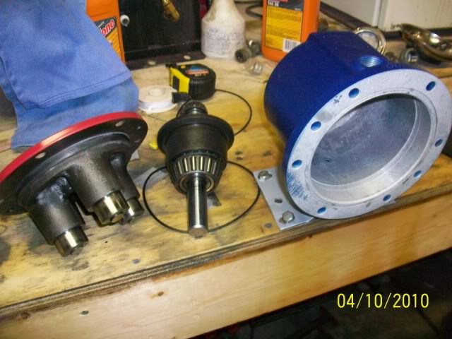

I'll pull those rubber diaphragms along wit the large O rings...
and THAT would usually be a rebuild....BUT since this one has so many hours on it...
i'm gonna take the oil side apart as well..that consists of a wobble plate(cam) and bearing assembly...i have it all apart the next few days...stick wit the thread.....

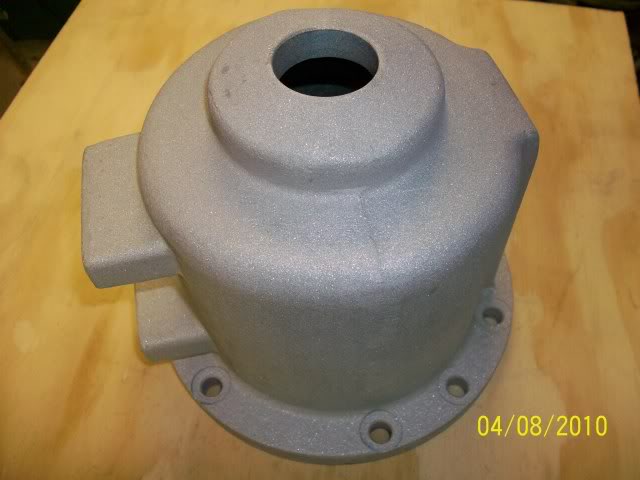

Bob...i will throw the bare case in the blaster and it will be lik fresh outta the foundry
also
there is no shaft that wears at all and i usually go 1 to 1 on the pulleys which means it turns at about 1600 RPM's!

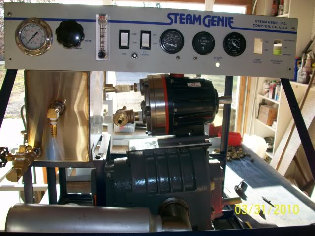

I was looking to see that last Steam Genie rebuild... Last shot we got was the frame being painted. Any updates on that one?
bob vawter
Grassy Knoller
Sep 15, 2007
44,662
bob vawter
Able 1 said:
I was looking to see that last Steam Genie rebuild... Last shot we got was the frame being painted(wit some dead frogs in the backround). Any updates on that one?
if you look closely you'll see the frame right behind the first shot of the pump!

UPDATE:
Ok sandblasted the case.got a new wobbler plate and hers what it looks like now
STAY TUNED

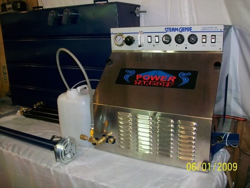

it's getting there!
The silencers are out getting ceramic coated right now!
Stainless plus ceramic coating..
COME ON????
