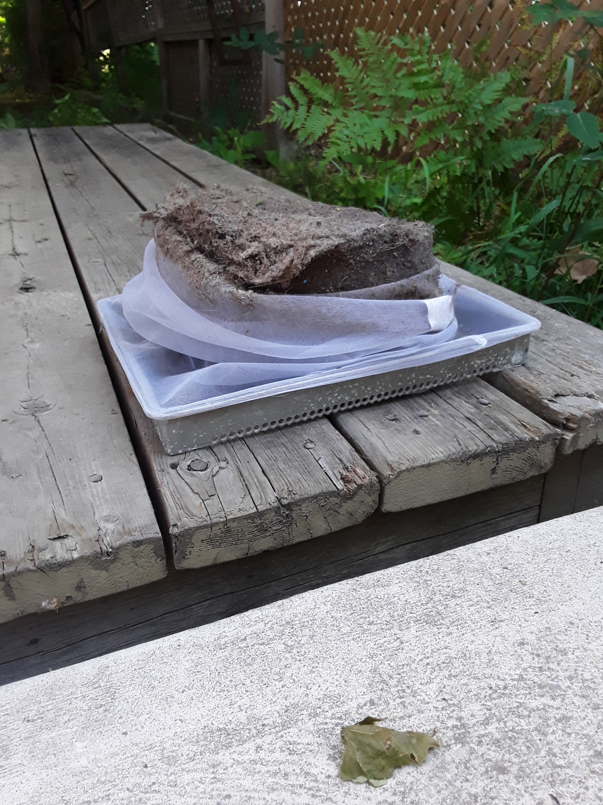

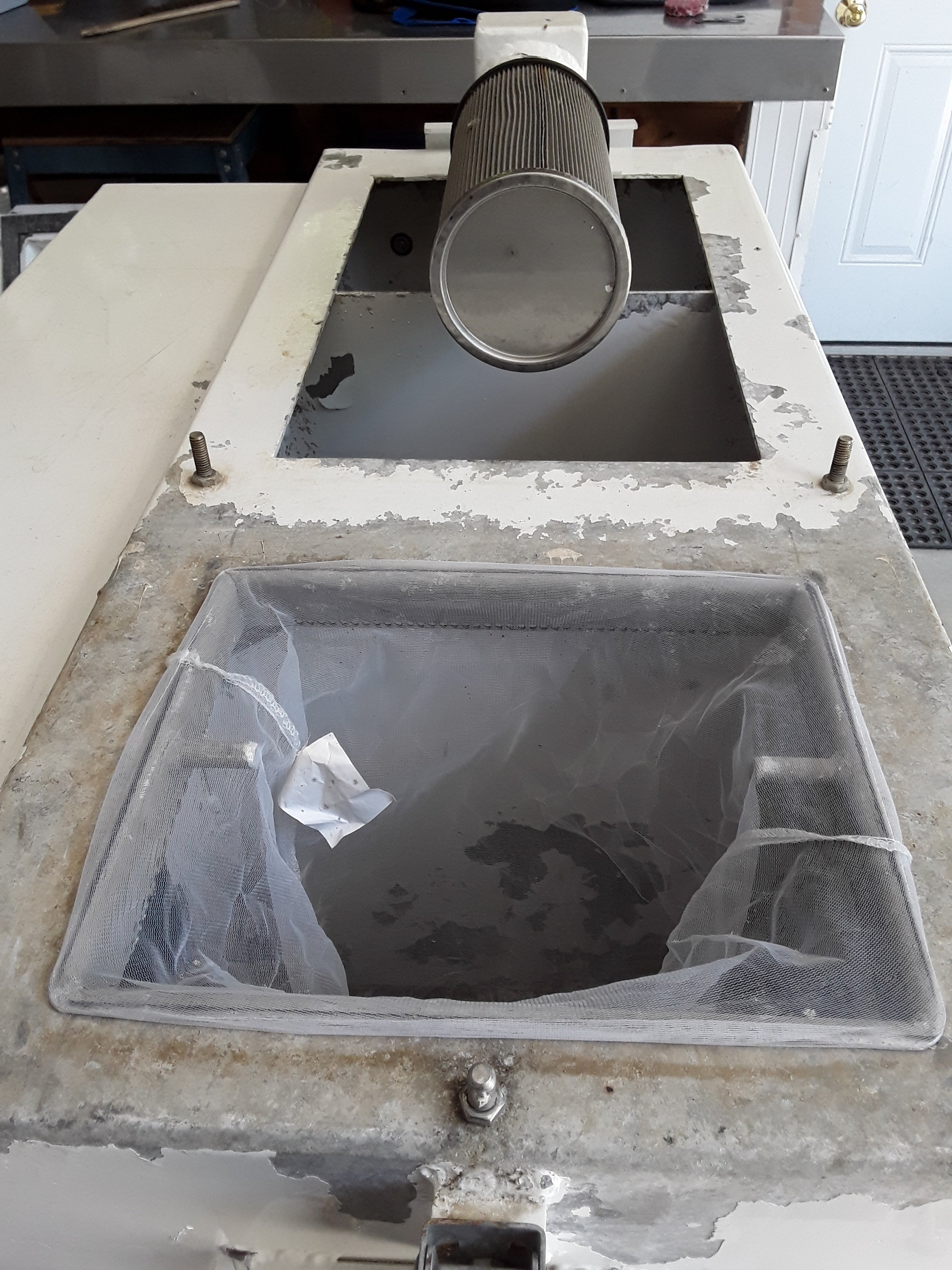

I had a SS Devestator and used it for a couple of years. It was a pain to always have dirty water and silt pooled at the bottom of the canister that would drip when changing filter bags.
I included it in the sale of my Butler. I have posted pics of the modified waste basket in my unit that holds the filters perfectly. A lot more surface area to breathe through and easier to service. I have several baskets and can swap out mid job as needed.

Where do you get the mesh filters?

Rob Grady
I use the standard 5 gallon paint filters. My tank filter baskets were modified to accept them by cutting out about half the bottom area and trimming the top lip to fit.
