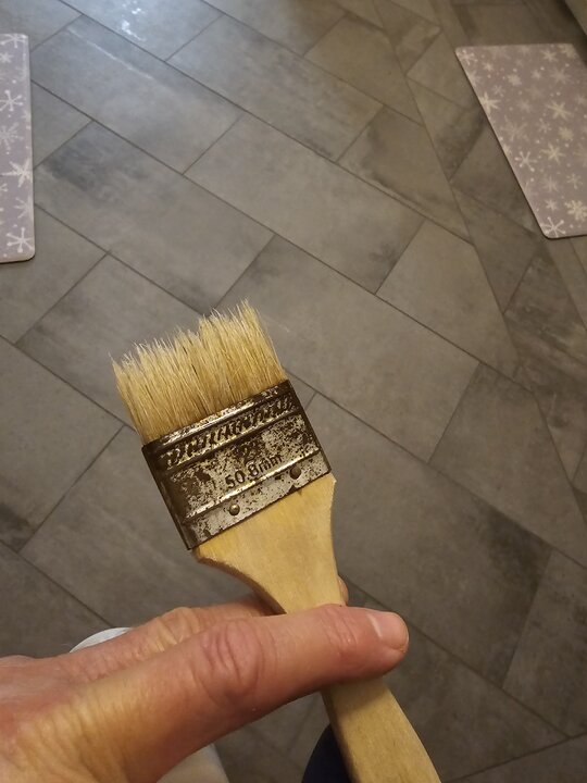

Just hwe a restaurant that juses vlm clogged the shit outa my filer box with this sawdust looking shit 3 times!
Did you vacuum first?
I used a cheap paint brush to apply it. Its lighter today so I will apply it again.
Yes I should have put plastic under it. The porcelain tile wasnt installed well so Im not so concerned about it. I did pull it off the wood though.
I had 2 small spots that didnt come out so retreated.
This is the paint brush I use.
Oops. I typed the vacuum comment but didnt mean to post it. It sat in the que until I posted that follow up.

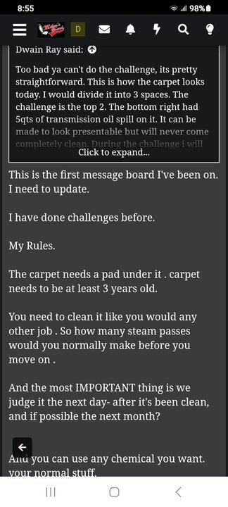

I still don't understand what you mean "my rules" i simply said choose a side and clean it. you came up with all the rules had to be this ,had to do that etc. I just said out clean me on this carpet and take home the silver. You yourself came up with all sorts of rules and conditions. All i said was choose a side and clean it and ill clean the other cleanest side wins.

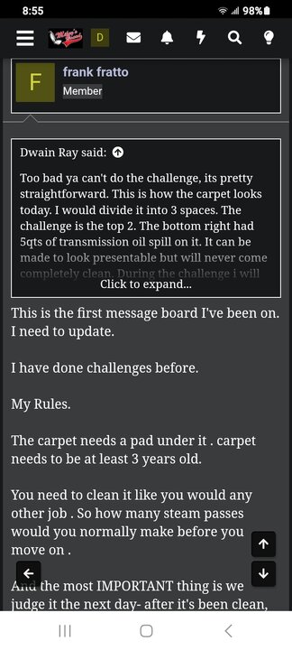

View attachment 133374 View attachment 133375

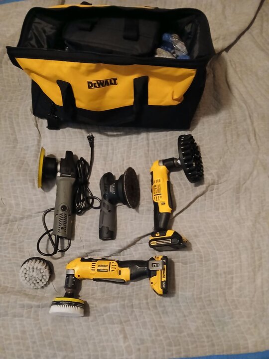

What tool are you guys using for vlm upholstery cleaning?
I mostly use orbitals
I have a 6'' electric and 6'' Battery
And I have that Bonnet Pro Rotary with 7'' Driver on Cordless DeWalt
The most important part of VLM Upholstery cleaning is the scrub. I have 2 brushes I use on Cordless DeWalt. One is very soft and the other is more aggressive
I use a Cordless Multi Sprayer to apply Detergent
And I have many 8'' Bonnets Microfiber and Cotton

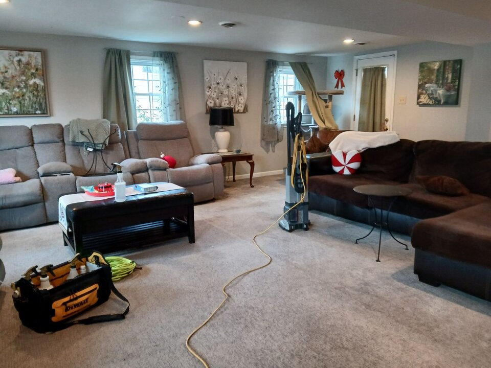

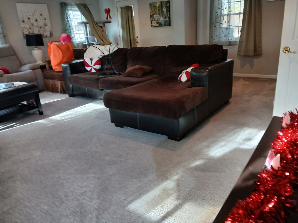

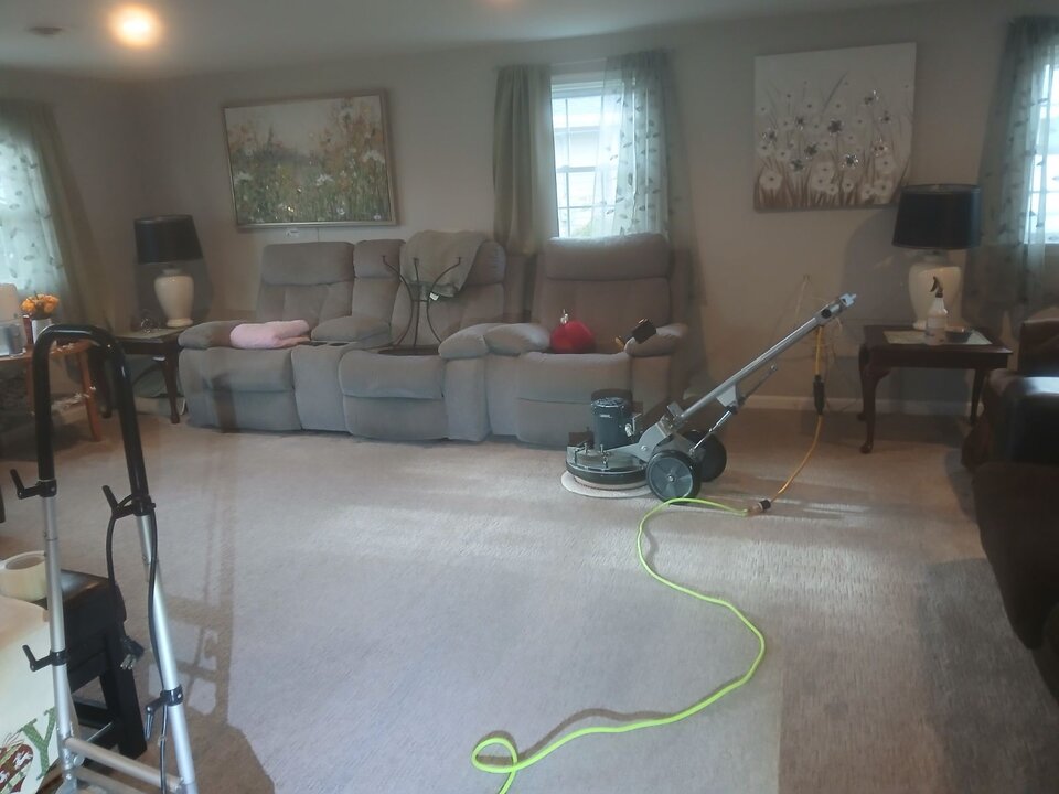

Now that it's cold the first thing I do is get a bucket heater in my cleaning solution and start to vacuum
I bring soft water to the job and just drop bucket heater into jug. That way I don't need to use or search for water at customers house
By the time I start to clean my cleaning solution is ready. I just want the water warm not too hot
Long time customer. That room is always a mess
Yesterday it had cat puke stains, soda spills, cat hair, and the daughter knocked over a white candle
I made sure I put in a picture of my Pro Team Vacuum for THEY LIVE 😀
That carpet is easy to vacuum so I used Pro Team
For Houses with People, VLM with 1-2 Hour Dry Times is BETTER than HWE !!!
