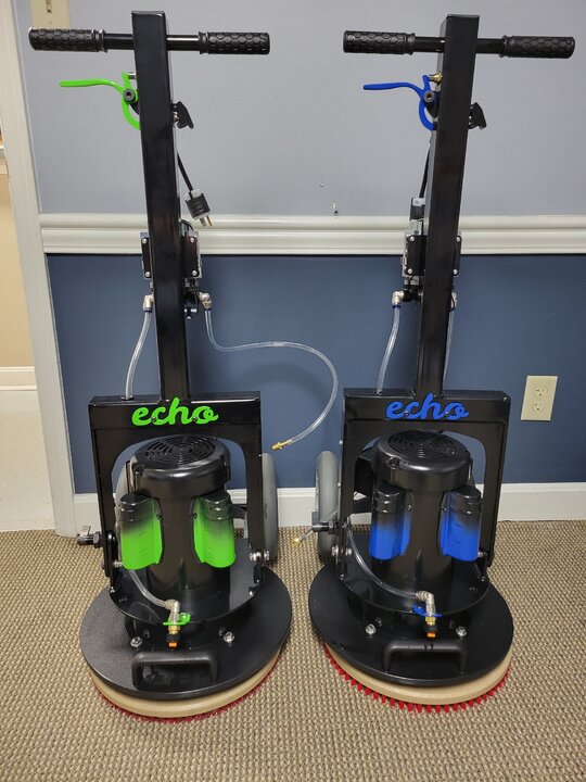

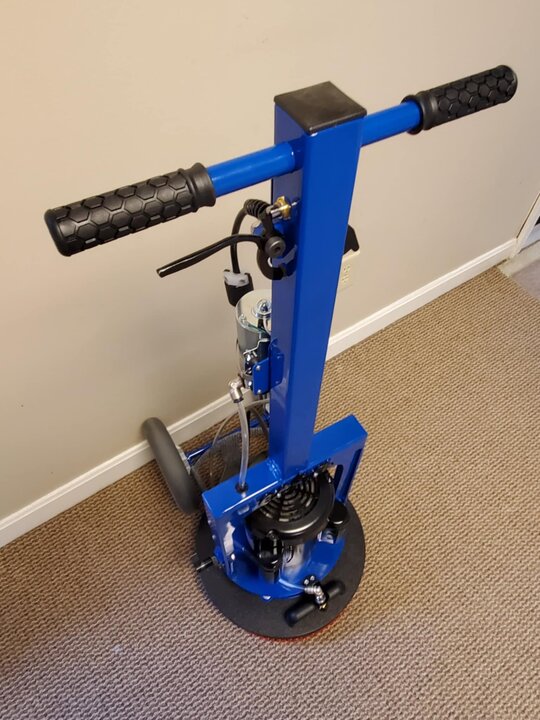

Built out of necessity but built on purpose. More head weight and more agitation with 1 1/2 inch oscillation. Yup, that's the biggest. But it had to be easy to use, so, wheels up. And the biggest problem to solve, up stairs!! Love op machines but why are they so heavy going up stairs? My gosh!! So I designed this machine with that in mind and amazingly the Echo can be pulled up stairs with one hand. It's really that easy, a residential carpet cleaners dream. It's an absolute beast in cleaning with less cleaning solution and easier to manuever than other machines I've built or used. Never built a machine that runs this smooth, where's all the vibration? Again, built that way on purpose. View attachment 131901View attachment 131902View attachment 131903
What differentiates it from John G’s old machines?Looks similar. I have two of John’s machines. A Profit and a Champ. What I found was fastest in big commercial buildings was a Mytee variable speed rotary with 3 gallon solution tank and front wide spray nozzle it has a lever on the left side handle to spray cleaning solution. You can also angle the spray tip in you want to walk it sideways..slower speeds make the pads really hook up.
As you know I've built John's machines for over 10 years and worked with him since the days of the Profit, cm and the Conquerer. I designed the Echo from some of those older ideas, the 15 inch pad driver for better balance, wheels up for better maneuvering around anything. But I gave it a larger oscillation and designed it to be lighter than the older ones for the purpose of going up stairs. My goal was 90 pounds because I knew it would cancel most of the vibration at the handle making it smoother and easier to use even with the larger oscillation. And because its only 90 pounds and a couple other modifications it can be pulled up stairs with one hand. Thats never happened before with a Trinity.
LOOKS GOOD , Charles. Nice job. What size driver ?
Hey Randy. Intentionally I used a 15 inch pad driver because with the sizes we've used over the years, 15 was always so smooth. With all the agitation, including the tamping, there is almost no vibration at the handle grips. Thats a big deal with oscillating machines.
