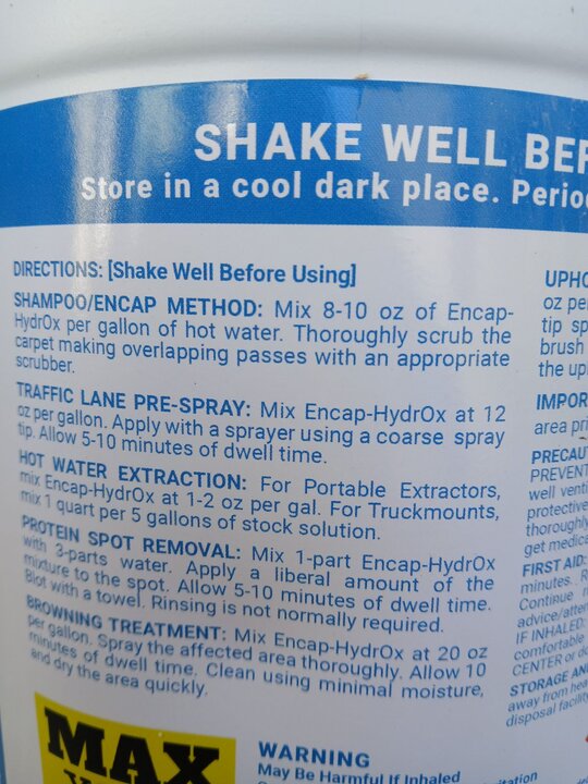

Peroxide is such a blessing for VLM work
It's only they made hot water extraction rinses that had a suitable amount of peroxide in it as it would be even more effective due to the extended drawing/exposure times
Some encaps with peroxide ( Hydrox ) say they can be used as a Hot Water Extraction Detergent
9,839
Personally, Rick might disagree, but I wouldn't make a habit of running that through my porty. Even 2oz per. At least run a low pressure hydra force

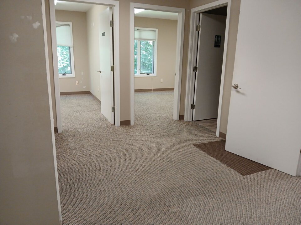

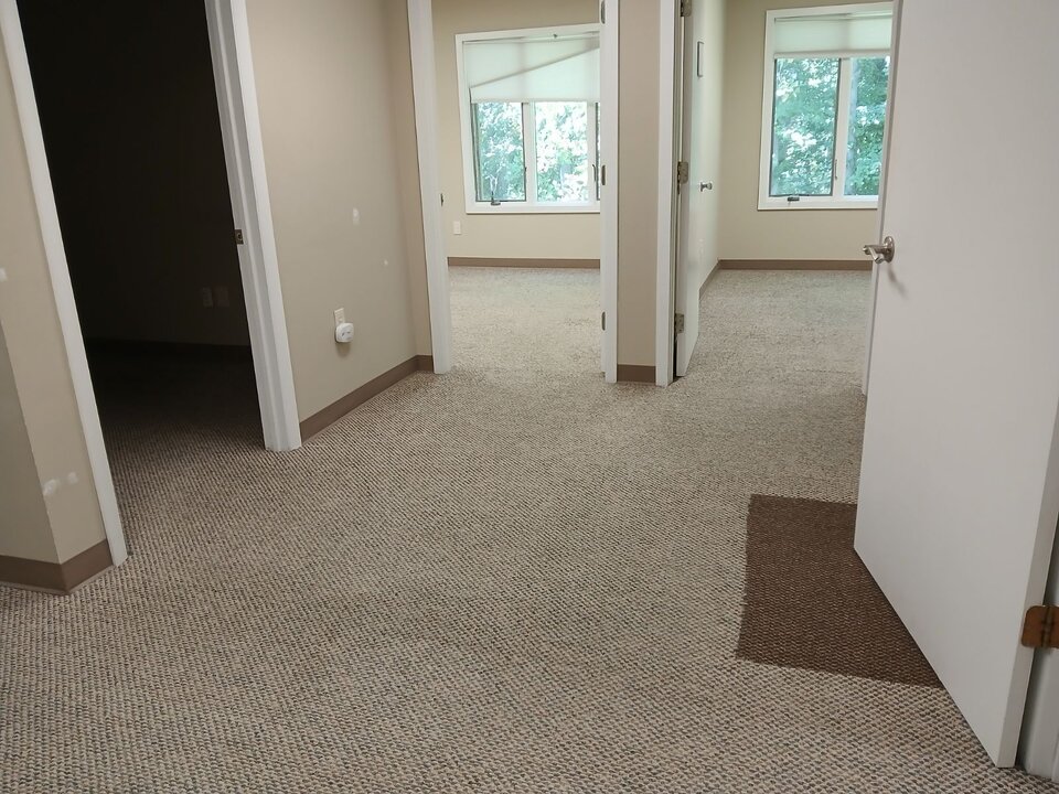

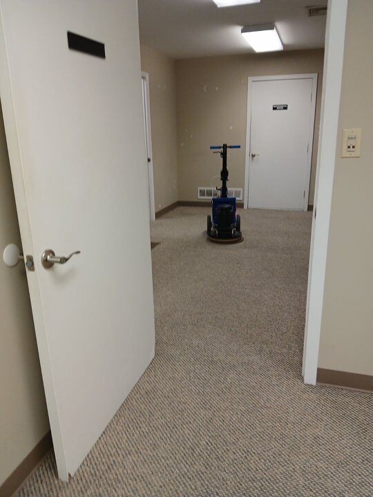

Business move out. Long time customer that buys offices and then rents them to small Business Owners
That is another successful VLM/SETT Method job using TOPS Phoenix and Releasit DS2
Phoenix is the BEST OP for cleaning carpet in Commercial Buildings and DS2 is the BEST encap for cleaning Commercial Carpet
I Love VLM !!!
View attachment 132580View attachment 132579View attachment 132581
You are doing some great work there bro. I just finished 18,000 sq feet with the MX and release it. Pretty hard to beat it.
